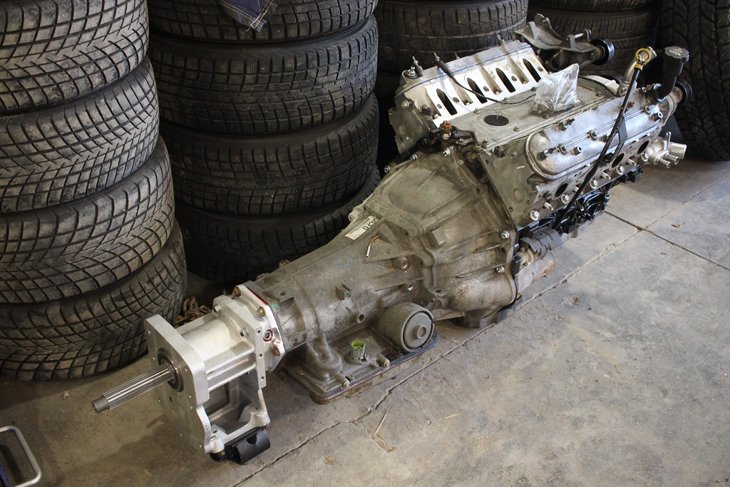

So started out today with a nice 25 mile bike ride before hopping into my work! First task of the day was getting the transmission mated to the engine, first time installing an auto so it was a little learning curve to get the torque converter all the way onto the input shaft. But once on it all bolted up nicely, consin was here from CO so his help made this job much easier!

Got the engine placed today and the mounts all tacked in for the engine, next step will be the trans crossmember.
So as far as placement goes, I'm about 3/4" to the drivers side and about a 1-1/2" gap from the firewall. Rear output flange to rear differential flange is 37". Oil pan clearance is pretty good but might end up going to a lower profile pan just for my own peace of mind.
