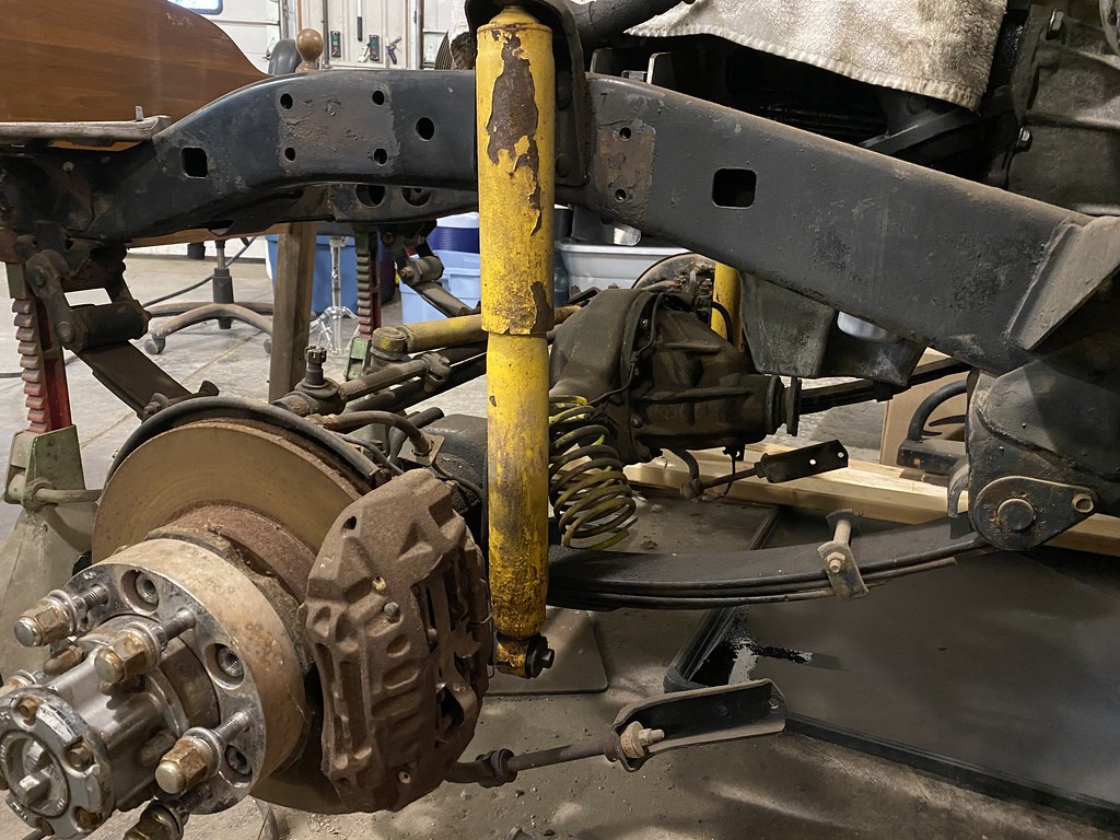

Made some progress today.... I am in no way a body man (I hate it tbh) but was able to fit up my replacement rocker corner today. At some point it looks like a stick or something went through the rocker and the body panel behind it, was able to source a replacement on here a while ago and here we are finally getting it all in. Almost done and ready to weld up, just need to finish the piece behind that supports the fender nuts. Everything will get cleaned up all pretty when its done.
And while I was down there I was admiring how clean this 216k mile frame is...
Great progress today on the rocker corner, got the fender mounting nuts with their extra support attached to the corner, then got the corner on and cleaned up! Went really smooth and have started to figure out the sheet metal work, welds smoothed out really well, will get some epoxy primer shortly.
Small things add up in the end...
