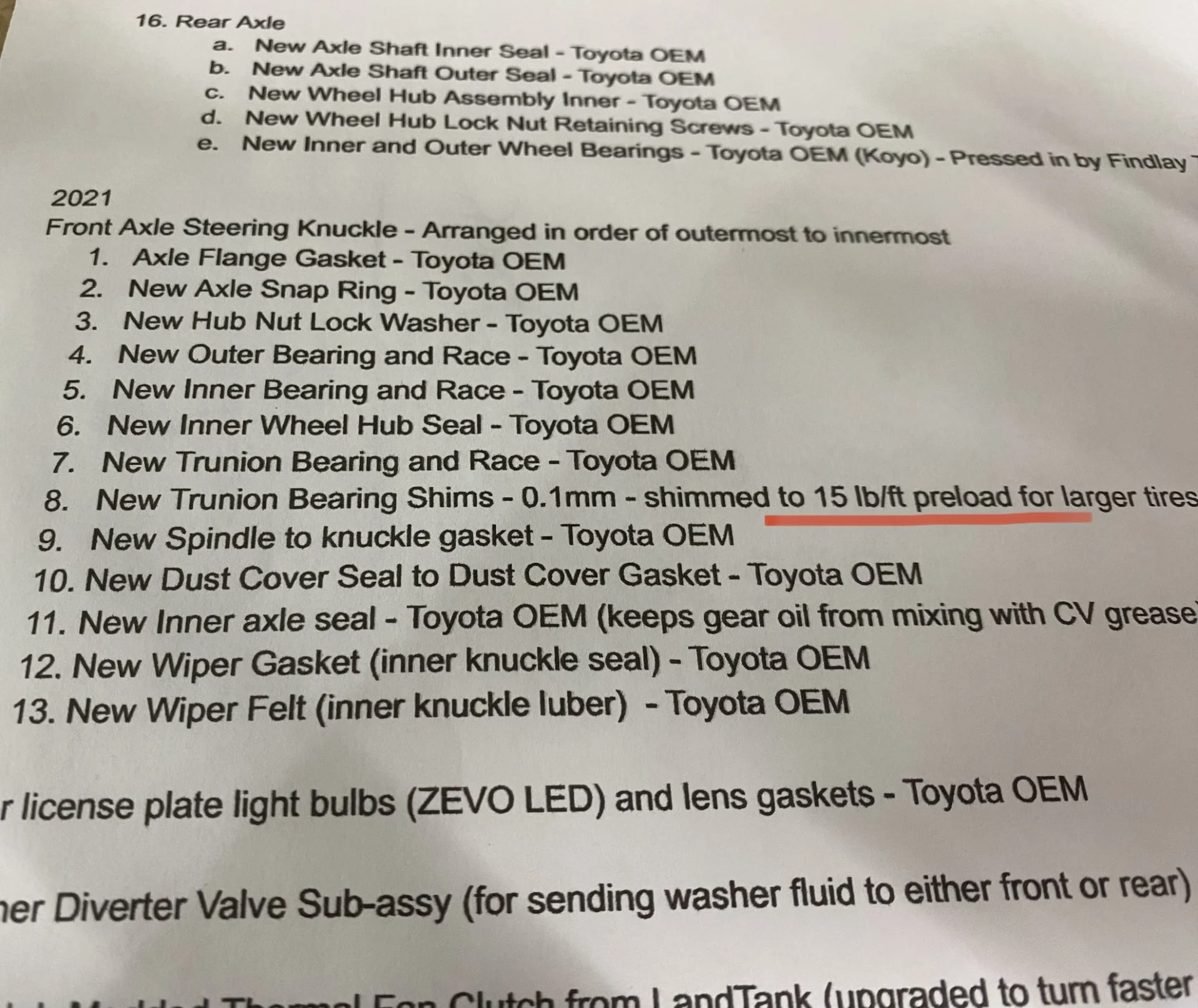

Did I find the Smoking Gun? Unsure if this would be enough for overly heavy steering but check this out. I pulled out the PO's extensive notes on his own maintenance history (best I've ever seen). He did indeed replace the trunnion bearings in 2021. Started reading further and there it was:
"0.1mm-shimmed to 15 lb/ft preload for larger tires"
I know the FSM states up to 9.9 lb/ft (which isn't always followed obviously)
It's got stock size KO2's on it still. He did not get around to slapping larger tires on it before he decided to sell it. What do you think? New trunnion bearings are not even 2 years old and there's a binding spot in the middle of the steering on both knuckles as mentiond earlier. Not terrible but it's there by hand when you've got the drag link and TRE's disconnected.
Would 5 lbs of extra preload wear that into them in just 2 years and 10,000 miles or so? I've done several FZJ80 axle jobs so not a big deal for me to get in there and check things out one weekend.
OR…do I just pop the upper trunnion cap off, remove the .1mm, slip a .2mm in there, button it up, see how it feels? I know you can’t measure preload by doing it that quick way, but if he’s getting 15 lbs with a .1mm shim, that’s a good starting point to work from.

If you can feel a detent/binding when you swing the knuckle around the trunnion bearings then I’d say she needs to be torn down for a visual evaluation and possible bearing replacement.
The thicker shim is most likely needed but only after you’ve confirmed the installation of good parts.
Yah that’s my thinking too. Trunnions already somewhat trashed. If I can feel a detent turning the knuckles by hand with the wheels/tires on, it should be exponentially more difficult to turn through that detent without the mass of the tires helping. I’ll pop them off, and drag link, TRE’s, and give it a go.

Reached out to the previous owner. May as well ask him if he recalls what factory shims it had when he did the trunnions last year. Can baseline things that way. Should have thought of that sooner.
