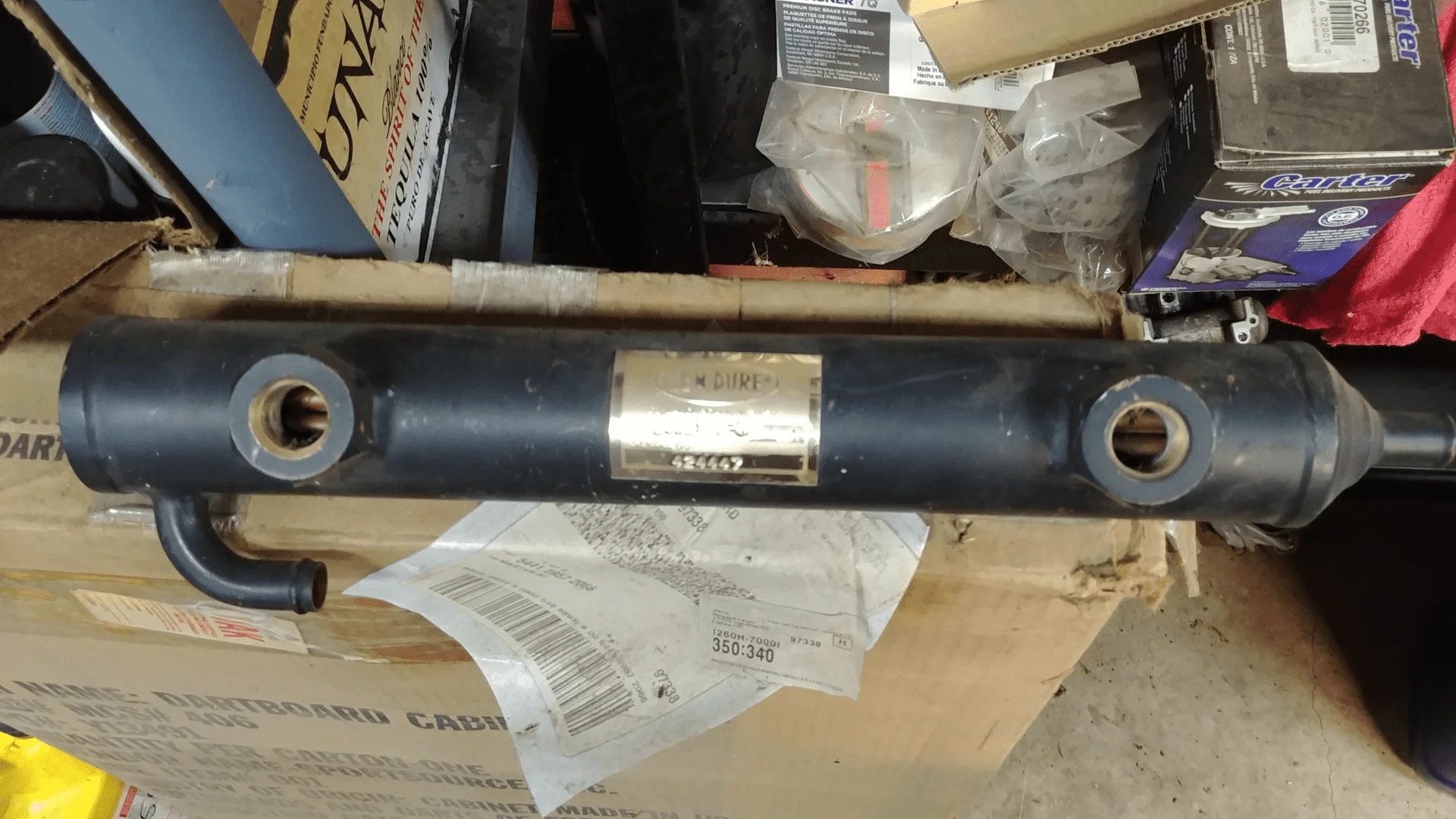

Here's a picture of the heat exchanger I have. Many years ago I purchased two of them, one for my 40 and one for my 60. I never got around to mounting the one on the 60. May end up on the outback 80.

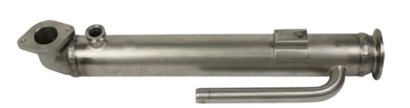

I've got a EGR unit off a superdooty 6.0 that looks like that but stainless. I've been contemplating cleaning out (CLR?) and adding it to the coolant system for a heat exchanger.
For anyone else considering it might be a good junkyard donor exchanger. Certainly didnt cost much.
I might just cut the ends off, try and retain the weld as a flare and clamp in the middle of a section of hose somewhere. Would almost be better to run a secondary coolant loop to the water tank though to avoid any freezing/cracking coolant leak issues.

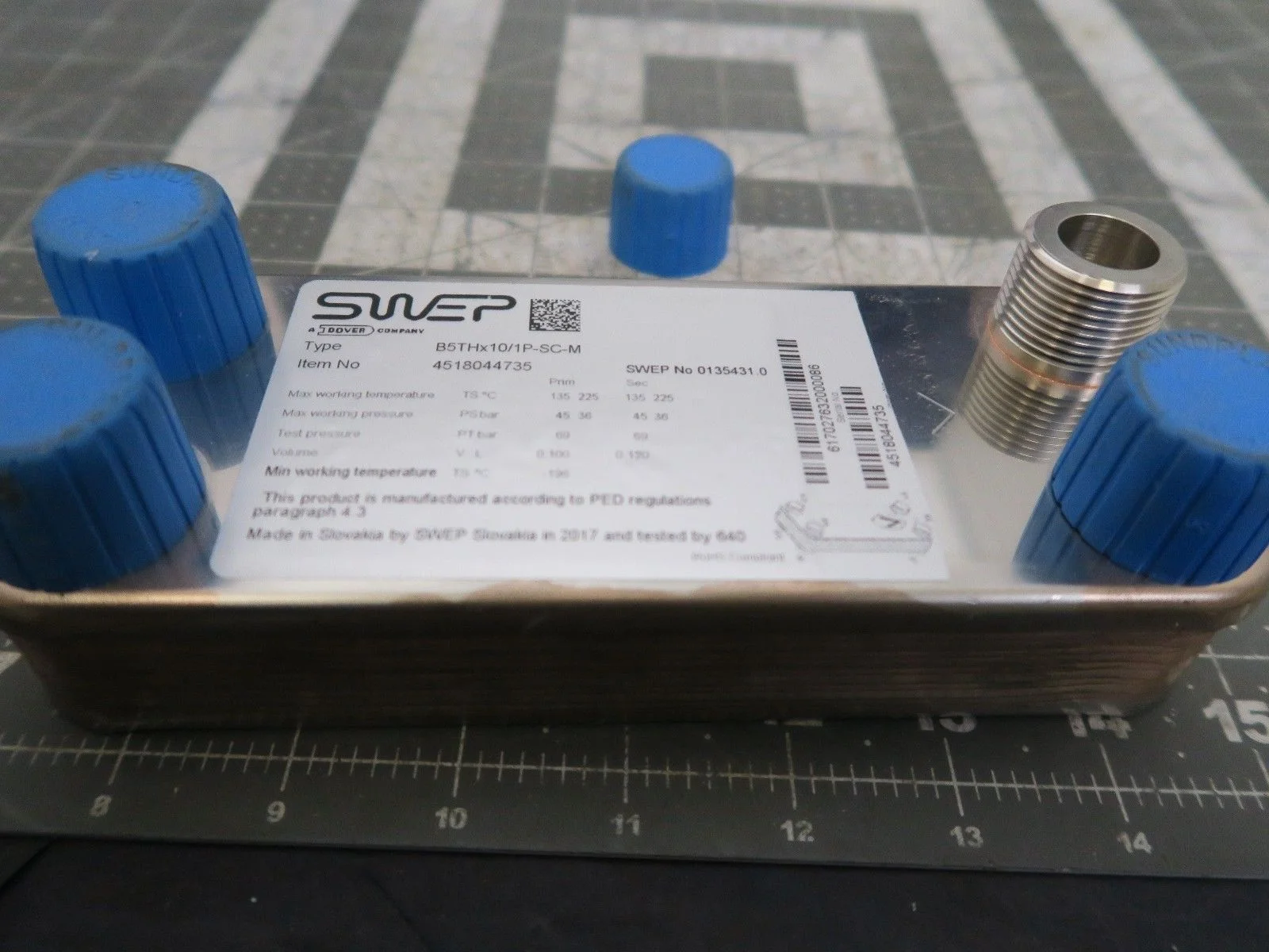

10 plate will be plenty. I recommend you use a thermostatic mixing valve. The mixer uses a wax element, so mount it away from engine heat. It will get too hot sitting in the exchanger when not in use while showering and soaking up. The heater control valve works only ok.
I have had mine for 7 years. Use a shurflo RV pump. That switches off when you close your hose or spigot when pressure builds up.
