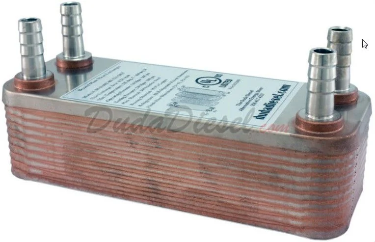

my jeep friends have a plug and play kit with plate heat exchanger like this
Any ideas or experience?

You may find with the plate exchanger in the picture you don't get quite enough or a bit too much heat from it if you run your source water directly through it to your shower head. You could recirculate the water through it till the water in tank gets to ideal temp but that is more involved and you'd have to monitor or control a valve for temperature
I had a heat exchanger water heater on my 40. Worked great. I tapped it into the heater feed so I could control the temperature with the heater temp control / heater control valve. Small electric water pump to move the fresh water through the exchanger. Worked great.
My heat exchanger was tube-shaped, with a water jacket around copper pipes that the fresh water flowed through.
