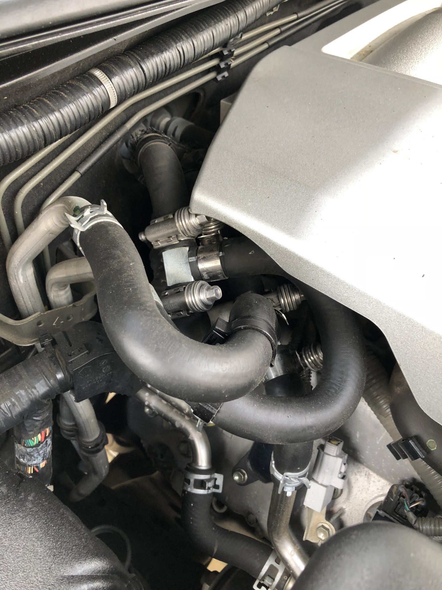

With the known Heater Hose T failures with the 100 series, I decided to upgrade my 2010 200 series Heater Hose T’s. I now have a 173k on my 200 and was concerned how long these plastic parts can hold up long term.

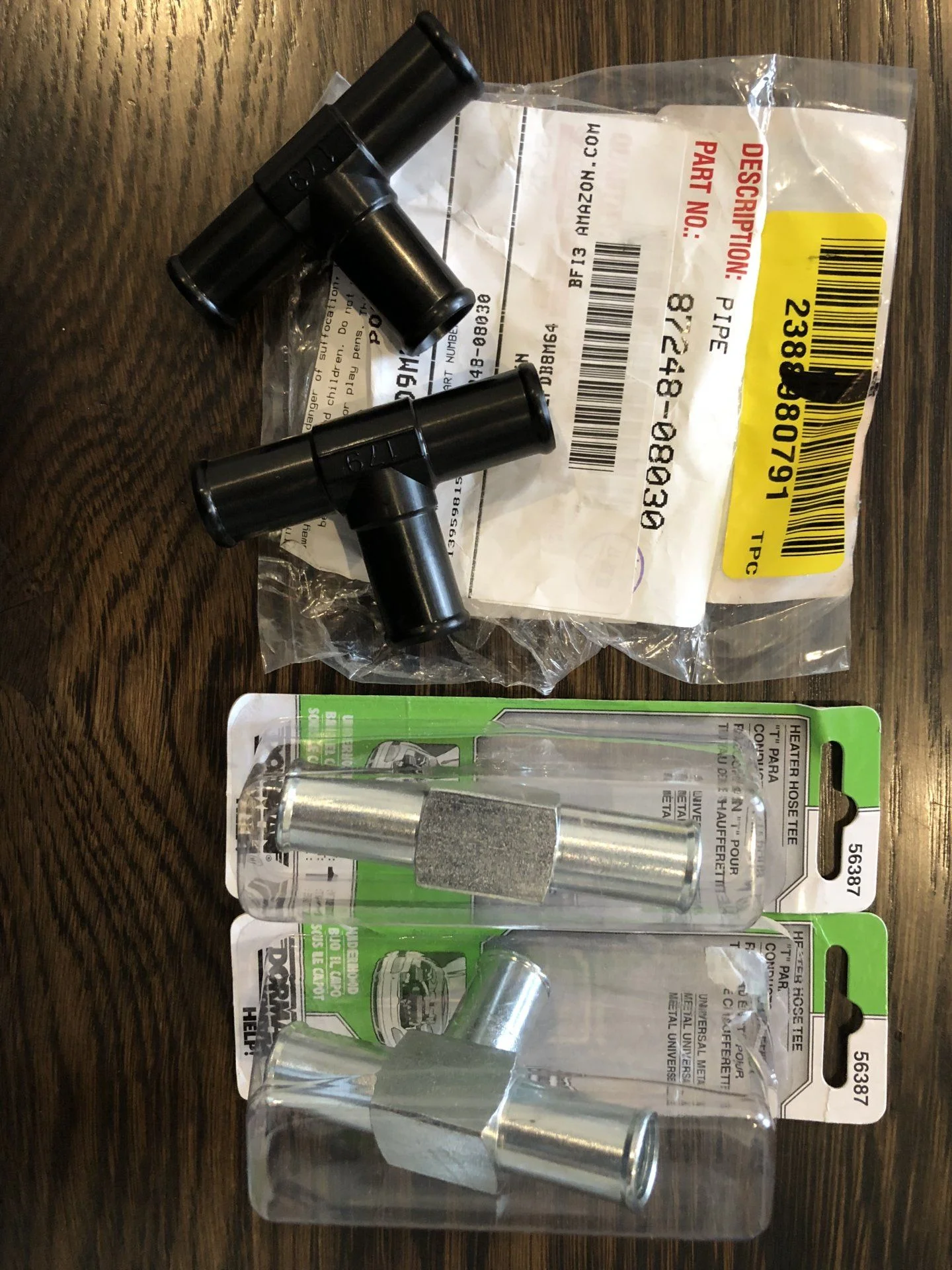

Found an exact match by Dorman (see pic below). I used Breeze SS Constant Torque Clamps with this modification. The clamps seemed to provide a better fit with the T’s vs. reuse of the OEM clamps.

Do you guys have the PN's for the heater T assemblies (includes the heater T's and all hoses)?
just ordered these parts - thanks guys

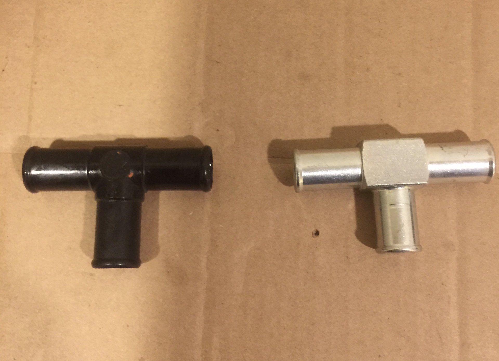

The Ts had no discoloured brown, and they felt as strong as new. I had a picture of OEM vs new metal T before putting the metal ones on.
