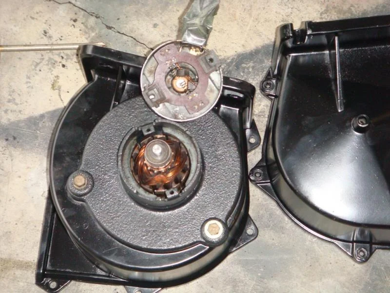

I took apart the heater motor to clean up and lube. Is there a trick to getting the springs and brushes in place long enough to slip them over armature? I have been fighting them for the past hour with no luck.
thanks
Is it possible to remove the armature from the motor? Assemble it to the brushes and cap, then put it back in?
Yes I had it out to lube the bottom bearing. I tried doing it that way for a while and then put it in the housing to try. No luck with either yet.
It was a major PITA but I figured it out and got it back together and Patience was the key
