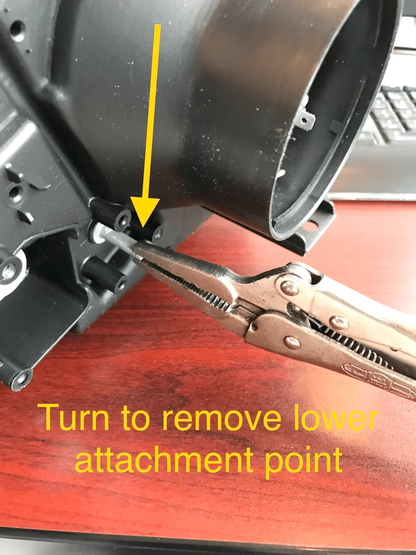

You do not need to bake and open your lights. If your lights have this combinations adjuster on the back remove it and you'll expose the individual metal tab adjusters for the low and high beam. If anything is stripped it's the plastic gears inside the combination adjuster. Disregard the instructions on the second picture but that lower tab will adjust the height on the low beam projector
thanks for that! mine's an '03. same headlights as in your photos?
I realize the photo is of a non-oem headlight, but the overall design is identical. Looks like we might be talking about different headlights?

Think the design changed slightly for 1998-2002 and then 2003-2007 years. the one you have @dsalni is like mine on my 98.

ended up baking and taking the light apart. with some slight persuasion i got the threads to grip and move the reflector up/down. just documenting this here for anyone with similar issues and looking for answers in the future. baked for about 6-8 min @ 320-350 degrees.
