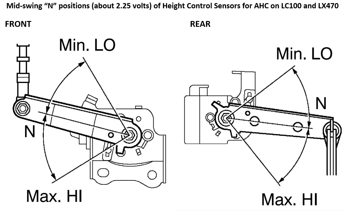

I believe that using the wrong hole on the sensor arm will give you issues - thinking about how the linear (up/down) movement of the axle (well, really the body) gets translated into rotation of the potentiometer at the heart of the sensor, changing the "arm" length by using one of the other holes will throw the height change calculations of the system off.
This is because the same amount of linear motion of the body will now result in a greater amount of rotational motion at the potentiometer, making the AHC computer think that the vehicle height has changed more than it actually has.

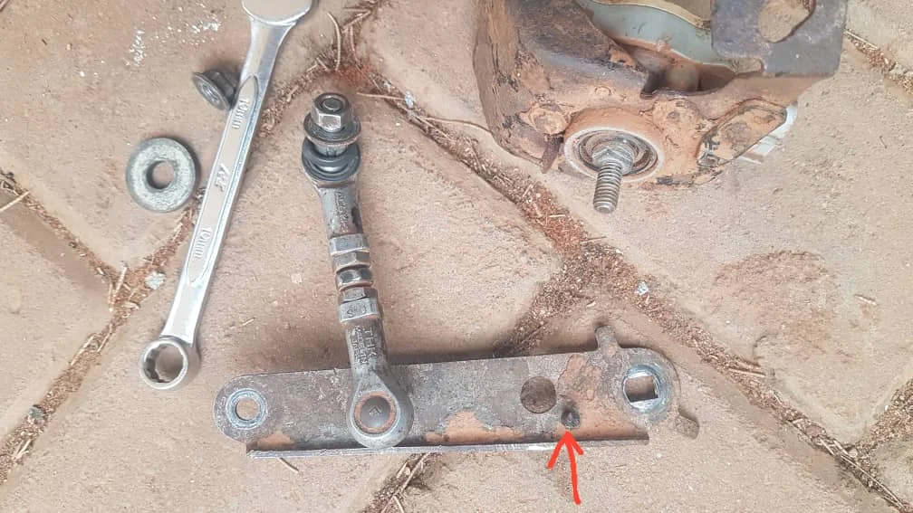

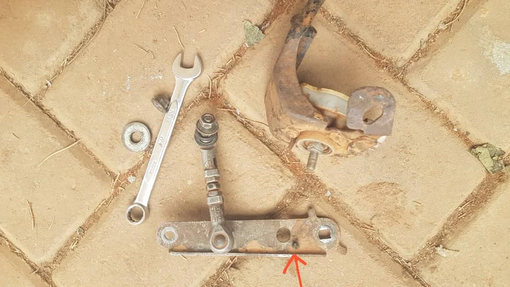

Attached are pictures of the pin. I have failed to appreciate its use.

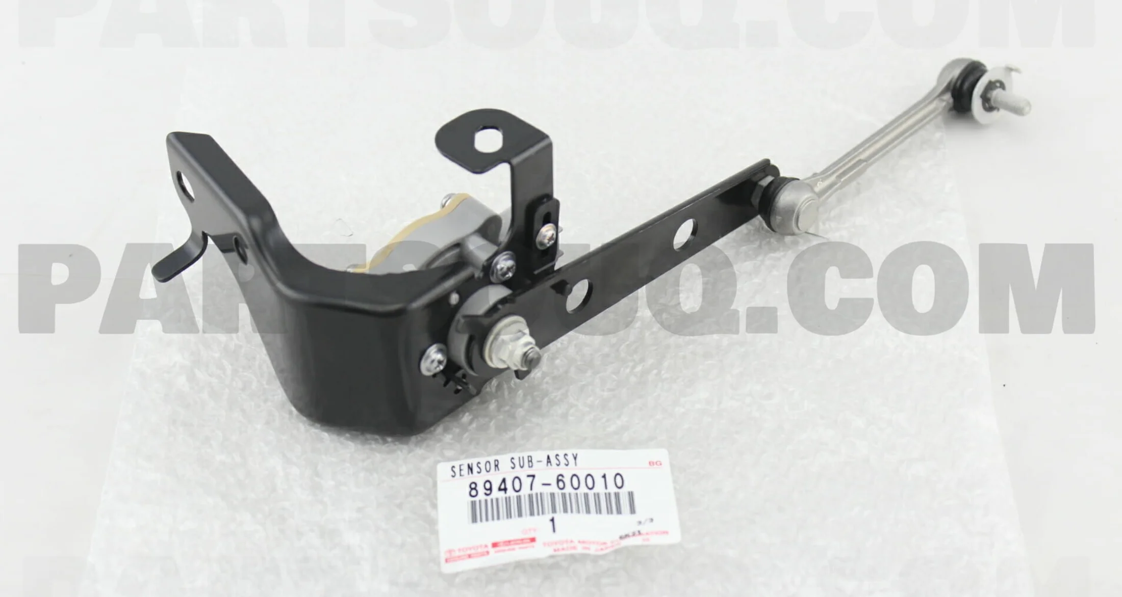

If you look closely at the diagram (not the pictures) of the Rear Sensor attached to Post #2, you will see that the hole you have marked with a red arrow in your picture actually is the position of the temporary plastic post as described in Post #11. This also can be seen in the pics below.
For unknown reasons, your Rear Sensor incorrectly uses the link with the double-ended thread from a Front Sensor and not the correct fixed length link for a Rear Sensor. This incorrect link may be of the wrong length. As mentiond by @LJE, if the linkages are the wrong length, then the Sensor cannot work properly.
If the linkages have "flipped", the Sensor may have internal damage. Suggest remove the plastic cover (four screws) and inspect, clean and test the Sensor.
The Height Control Sensors are 'wear items'. If a Sensor is old or degraded, or causing erratic behaviours of the vehicle, then replacing the Sensor is the best solution AFTER first checking that the electrical connector and wiring harness are in good condition.
The Height Control Sensors are 'wear items'. If a Sensor is old or degraded, or causing erratic behaviours of the vehicle, then replacing the Sensor is the best solution AFTER first checking that the connector and wiring harness are in good condition.

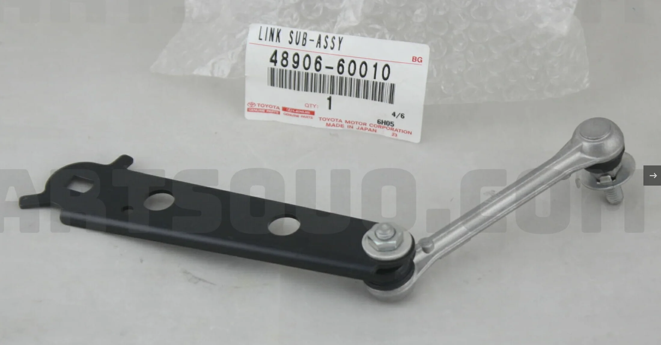

The rear linkage is the adjustable type. It was replaced by the technician who used to work on my AHC after he changed the struts. I have the original one intact.
I am trying to see how to order for the one in the second picture you shared above.
There are cheap substitutes but based on feedback on IH8MUD over the years, recommend buying only genuine Toyota/Lexus OEM Height Control Sensors -- more expensive but better for reliability and longevity and to avoid disappointment. Impex (Japan), Partsouq (UAE), Megazip (Singapore), Amayama (Japan) have stocks -- various prices, suggest compare with local Toyota/Lexus Dealer price in Uganda. As mentioned previously, first check that the Height Control Sensor electrical circuits (meaning electrical connectors and electrical wiring harness) are in good condition.
