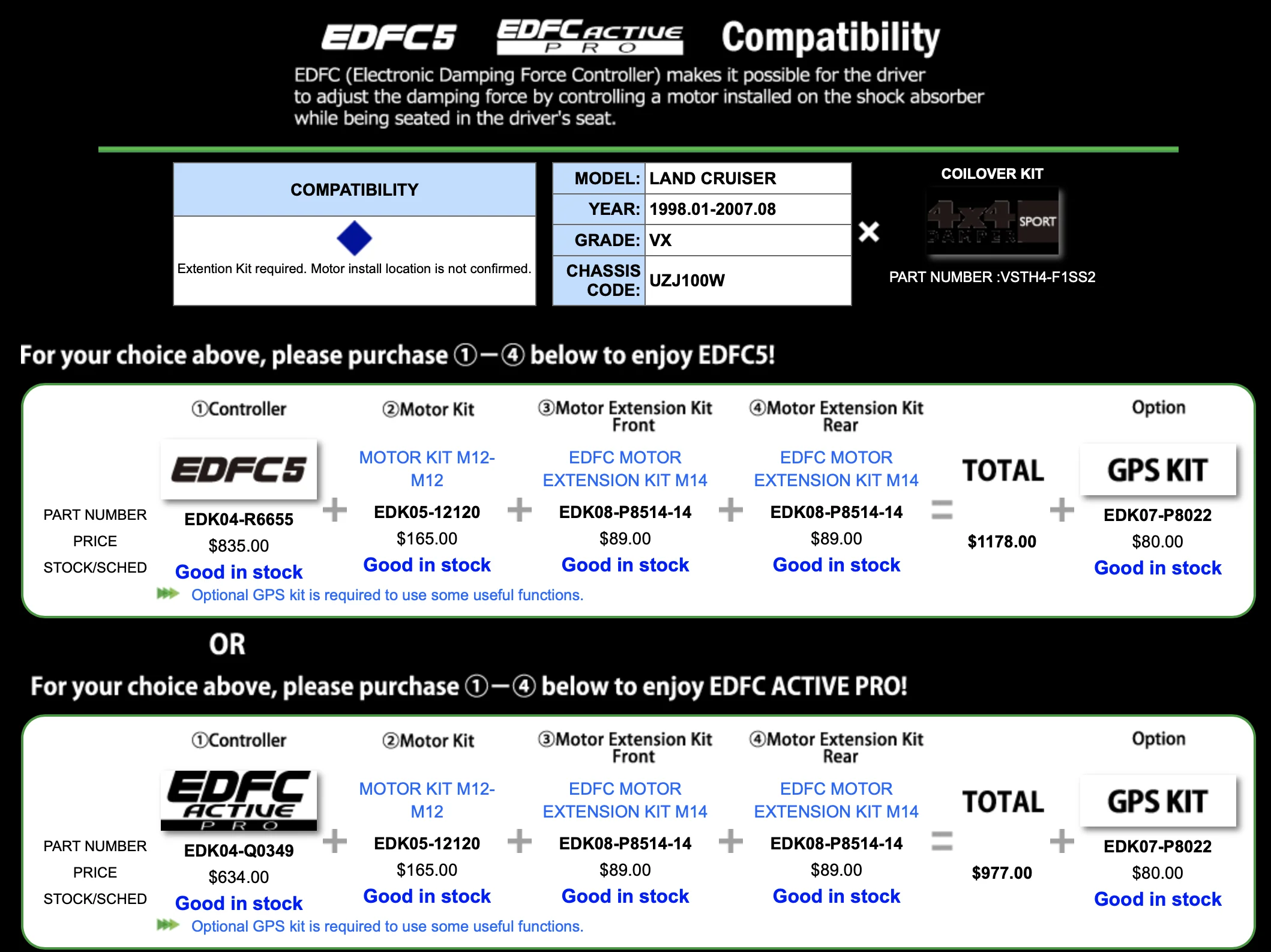

Tein offers one for the UZJ100. I don't know much more than that.

I’ve contacted TEIN Europe as they don’t seem to offer the EDFC5 here. Also, didn’t find much info/reviews about them while searching.
