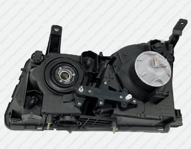

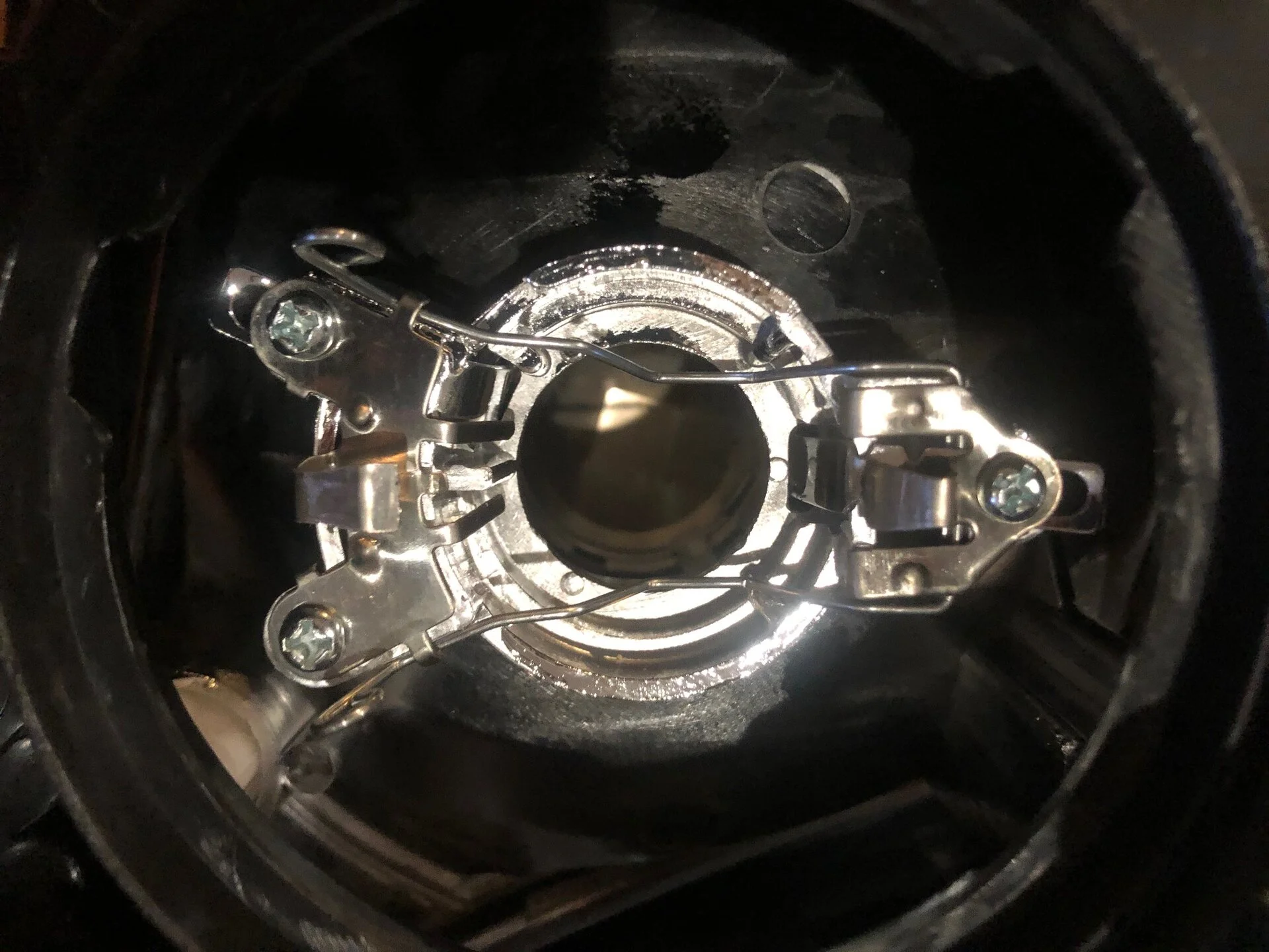

Just received headlamp replacements from Ebay and the high beam connection is different than original (and also different then pict in listing ) . Bulb does not fit. Have reached out but hoping to have done this weekend.

ORIGINAL CONNECTION
Everything else matches up, although did have an extra wire to low beam bulb. I assume for a different style bulb,
ON the assembly it is stamped "HB3" which is the typical bulb, but that one does not fit. Starting to think this is a manufacturer error.

It looks like H4 bulb. There are dual filament and single filament available in H4. Not a good idea to spice a new connector, but if you want you can take that route.

Looks similar to this Anzo headlamp, which does state that it is not for original HID lights.
Anzo
They are going to refund me.
