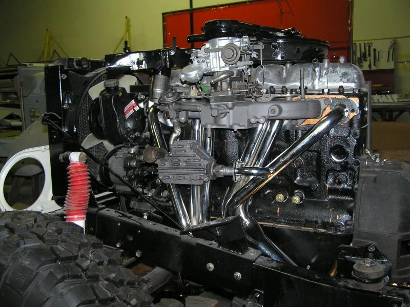

Street legal headers on my 77. Jim, from Downey Off Road, hand delivered them and offered good personal instructions for installation and after smog use. The headers came with a perforated stainless type gasket and Jim strongly suggested using the K&W Copper Coat Gasket Compound. Glop it on thick. Two CARB stickers came with the purchase.
Available from Mark's Off Road.

That looks pretty sweet!...
So did Downey advise you on the bolts at cylinder # 1 and #6?
In your photo it looks like you didn't use those bolt holes.
Is that right?

Marks headers. No drilling on my 1/75 2F. May not add much performance, but they look sweet!

On the "F" motor it does only have 6 studs to mount the intake/exhaust manifold... Maybe there are 8 studs on the "2F"... I don't know.
