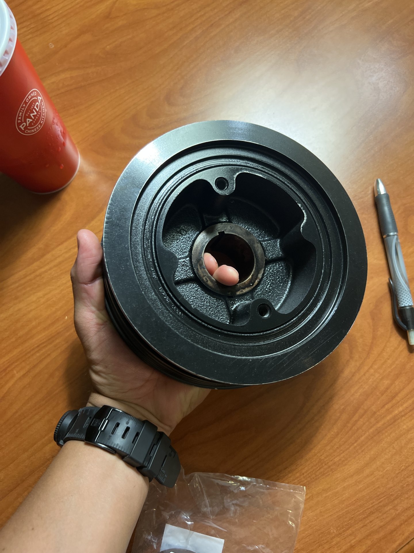

I preemptively ordered a Harmonic Balancer from Toyota parts-Q for around $250.00 when I replaced my front main seal, the old one had a slight wobble @ 349,000 on the odometer, its smooth as butter now. As a side note before my crank seal replacement procedure, I looked at the Toyota maintenance records for my 80 1zfe and found a service job where (the largest local dealer, in my area) was actually unable to remove the crank shaft bolt and abandoned the crank shaft seal replacement job. Using my torque multiplier, I calculated that it took over 700 Ft Lbs of torque to remove the crank bolt, i had the torque wrench set to 240 ft lb (240 + multiplier x 3 =720). I also ordered and installed a new crank bolt

Jeez, that almost looks like something out of a semi truck!Well, bought all the OEM parts through Toyota parts deal. Expensive, yes but not dealer expensive. The harmonic balancer must weight 15-20 pounds!
