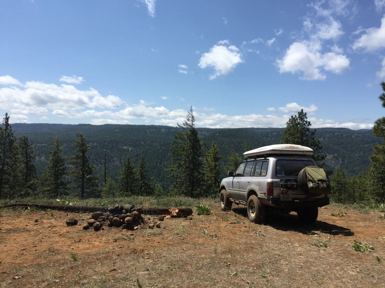

I didn't use a roof rack, just mounted two Yakima crossbars to the stock 80 rack. I had no issues with it, but when I removed the RTT for winter the stock rack felt very loose. I've since removed the stock rack and got some Yakima gutter mounts with 3 crossbars. I'll be throwing the tent on soon as our camping trips for the summer are coming up.
You'll feel the weight for sure with the RTT. My truck felt noticeably more top heavy and was bobbing around a bit on the stock 115,000 miles springs/shocks. The pics are from last year. I've since installed a lift with med/heavy springs and Icon 2.0 shocks, so we'll see how that feels this summer. Didn't notice any mileage difference, but I'm not really keeping a close eye on it since the 80 is more of a camping/play rig.
Overall, I really enjoy being able to set up and take down in 5 minutes and being able to leave the bedding and pillows in the RTT and not taking up space in the truck.
