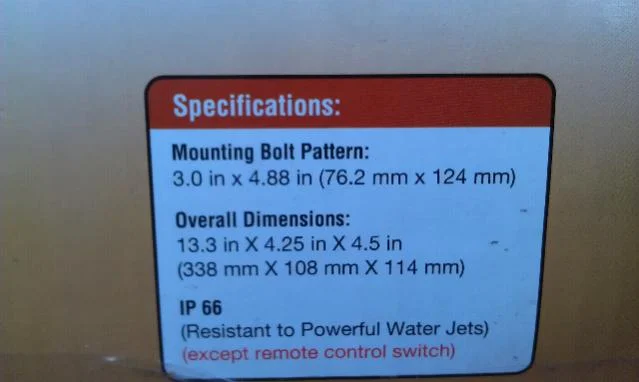

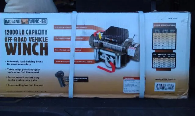

I just picked up mine and they let me use a 20% off coupon with the $329 sale price....score!!!!! Funny thing about the info on the box.....can anyone pick it out? Picture 1 is of the entire box. Picture 2 has the typos in it. Picture 3 is just for info for anyone curious of the power figures.

Yeah, I don't think that my 12K Badland winch is 13.3 inches long :eek: - it's more like 21" IIRC :lol:

The 3"x4.88" bolting pattern would be awfully tiny for that large of a winch too.....

Missed that, but it looks consistant to their other printing mistakes - hopefully their errors end there.
