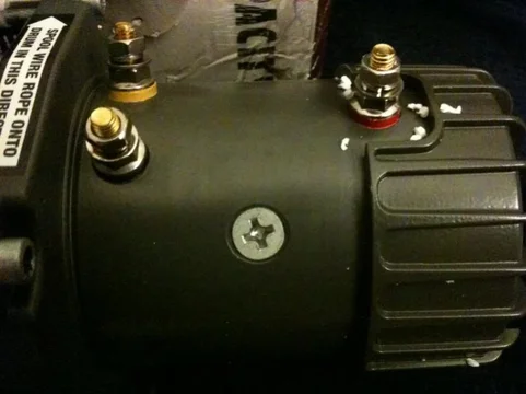

It arrived yesterday. Here are some initial pictures.

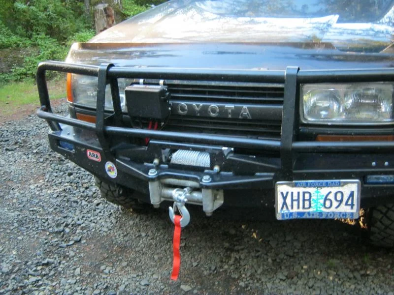

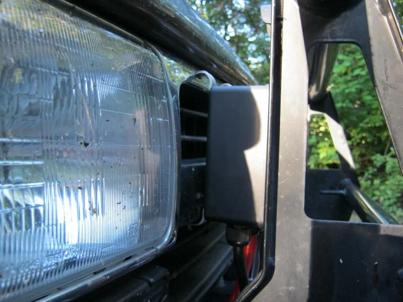

Don't know about the fairlead, I had a Warn roller fairlead from my previous 8k winch install. ARB recommends the Warn and gives you 2 long bolts in the install kit to replace the vertical roller pins. I kept the Warn for use with the 12k HF for that reason, plus I will be running the OEM wire rope. I'll suggest relocating your solenoid pack 'cause the 80's grill gets in the way of mounting the pack on the winch tie bars. I didn't like that location anyway 'cause with the wires looked too exposed exiting the pack on the bottom or top. I used a Dremel tool and cut 2 slots in my grill and opened the bracket hooks slightly. The securing end of the solenoid brackets lined up perfectly with my '94 grill and I was able to just drill a couple of holes for the screws to fit in:
attachment.php
Turned out to be not a bad install:

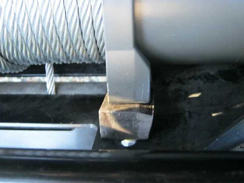

Also, you will need to install spacers so the ends of your winch clear the front plate since it tapers:
attachment.php
