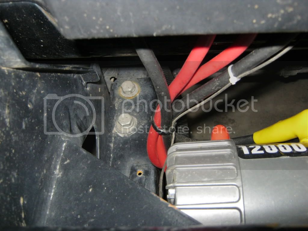

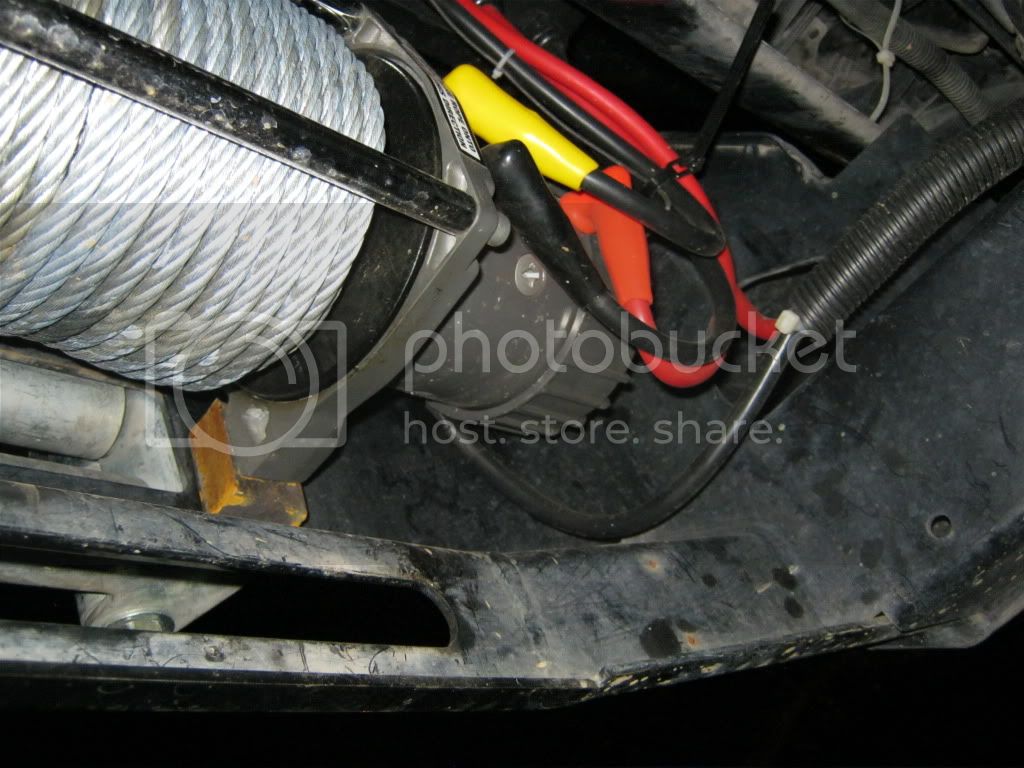

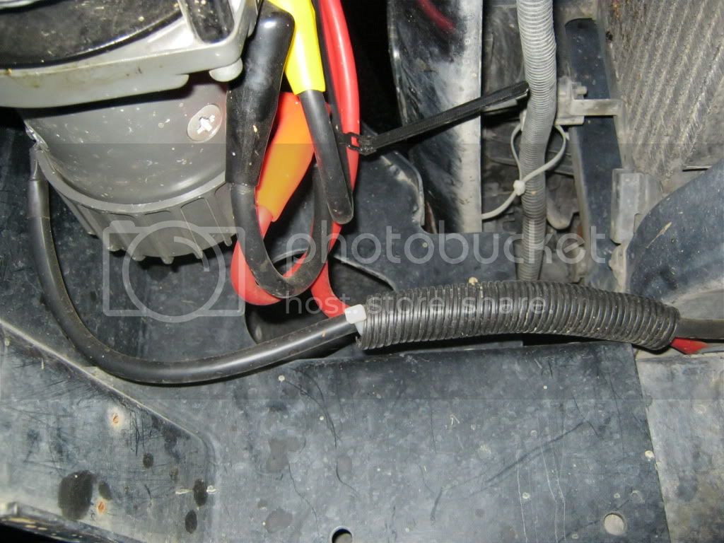

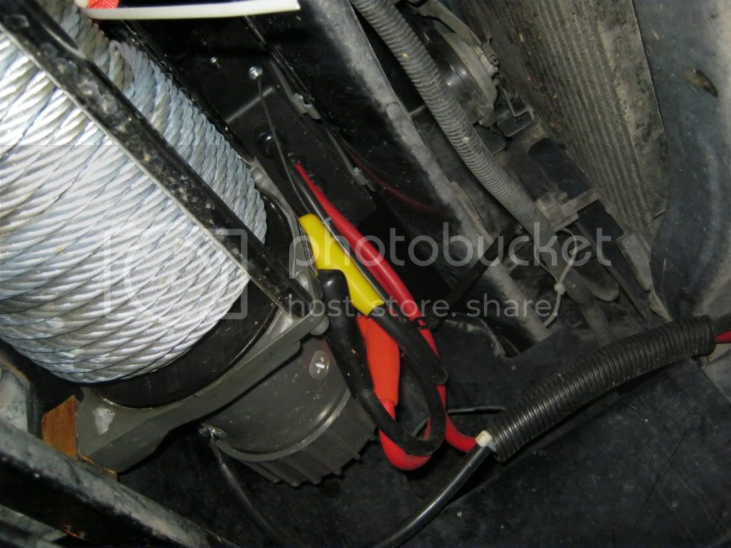

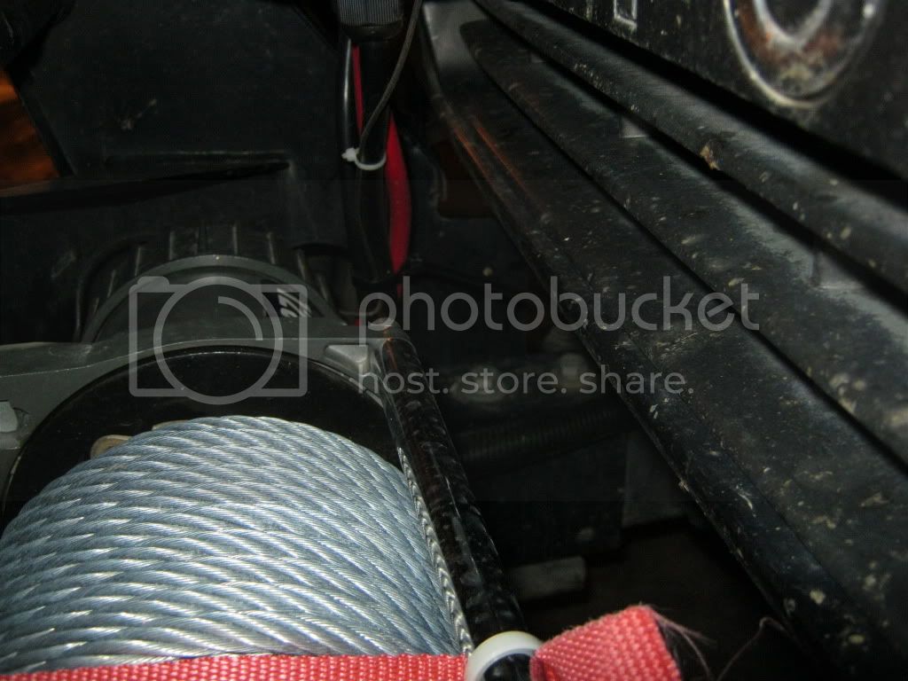

Here are pictures of my install. I had to remove the solenoid brackets and drill new holes in order to mount it where I did. My friends and I debated other spots for mounting and this was the easiest to do with the tools we had.
All I have remaining to do is replace the bolts that mount the solenoid pack to the brackets so that they do not interfere with the cable when it is in use. Right now the bolts are touching the cable just a tad. So I will take the cover off the pack, pull the bracket bolts off, replace with new flat or curved bolts and put them in reverse so that the nut is on the inside of the pack.
The fairlead required drilling to line up with the ARB for both the fairlead bolt mount and the 2 top bolts of the winch.
All I have remaining to do is replace the bolts that mount the solenoid pack to the brackets so that they do not interfere with the cable when it is in use. Right now the bolts are touching the cable just a tad. So I will take the cover off the pack, pull the bracket bolts off, replace with new flat or curved bolts and put them in reverse so that the nut is on the inside of the pack.......
Not a bad idea using some large nuts as spacers, but the clearance between your grill and solenoid pack looks like a bad idea, IMHO. Yeah, you'll not want to use your winch until you get those bolts out of the way. Wire rope does not always stack up neat & even under load - 2nd reason I don't like that location (even with factory brackets that encourage it). Lastly, the wires seemed to be unnecessarily exposed underneath, IMO, when mounted there. I lucked out where mine is mounted - it just works. The wire length and dressing the wires, to keep them neat and protected, turned out better than I first expected. And the connector for the remote is very accessible.

You don't need those bolts just above the bottom winch bolts on your fairlead. The winch bolts plus the long roller bolts are fine to hold and support your fairlead. I can't recall if my Warn fairlead came with those lower holes pre-drilled. It's been 10 yrs since it was first mounted. Take your time and think this out. You want an installation that will serve you well and not be a hassle when you go to use it.
Tom I agree with you on the clearence of the wires based on my mount location. I'm probably going to redesign it at some point especially when I add a second battery down the road. I also still need to zip tie everything up nicely. The picture where you can see the space between the pack and the solenioid is somewhat deceiving because their is a lot more then it appears to show.
I may end up moving it up to the grill like you did. I like the idea of it just being at a higher location in general. You can't beat this site for ideas when it comes to projects on these rigs. That's why I love looking at what other people have done. My buddy who helped me had the idea of moving the pack inside the engine bay(to the space between the battery and headlight), removing the controller connection, sealing that hole on the solenoid and then mounting the winch control input somewhere on the bumper via drilling of course. So that is another idea we were throwing around.
Yeah Shack, I like the idea myself, of locating the solenoid pack in the engine bay or even behind the grill. Be more protected and more out of the elements. Didn't want to mod the wiring yet. Maybe a project for the future. I agree about this forum being a great resource for help and ideas! :cheers:
