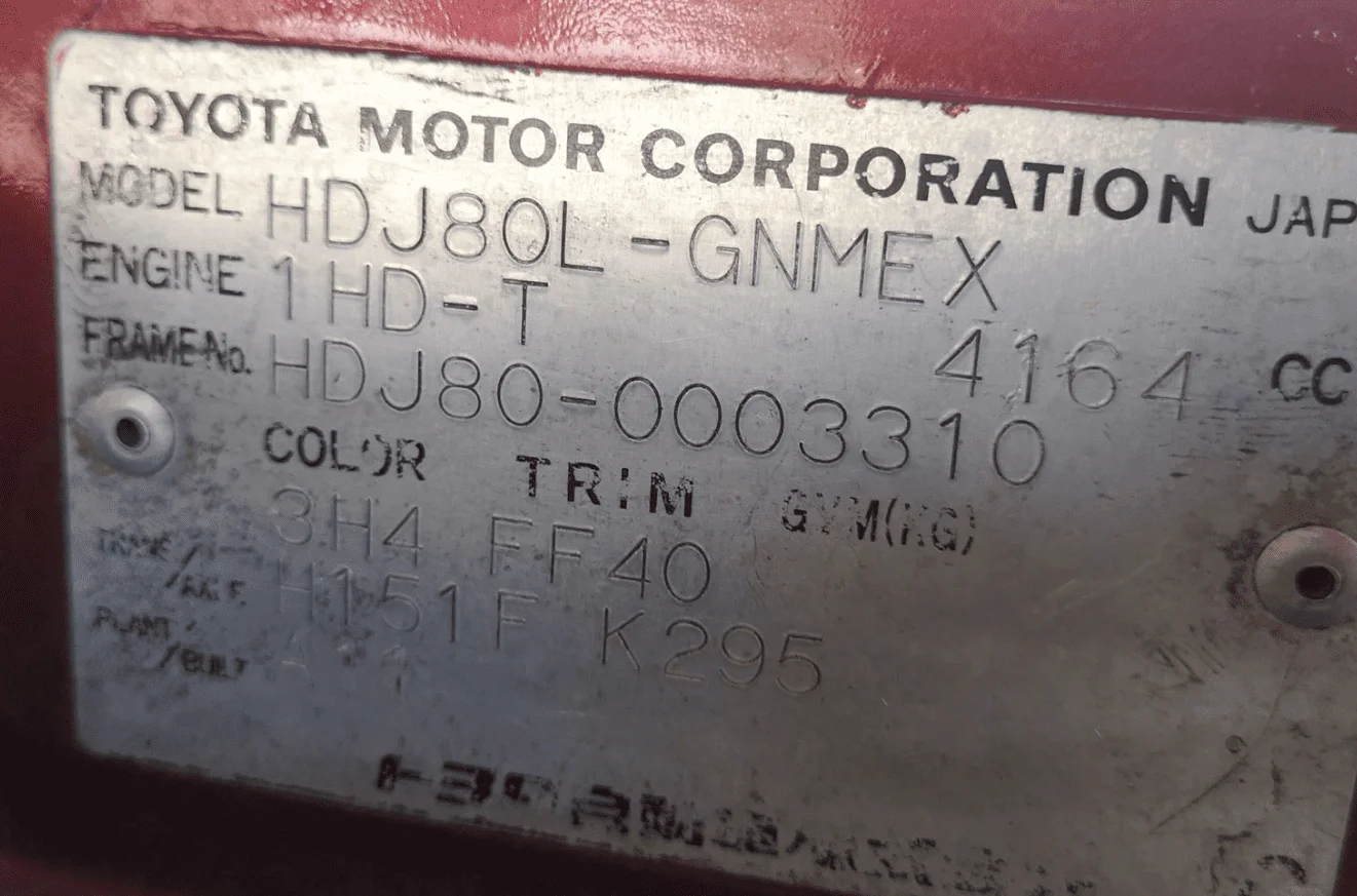

The different part numbers appear to be based on production date. You'll have to determine when yours was built and buy the correct part based on that date
Okay, according to the papers, it was sold on January 18th 1996.
So it should have been manufactured on 1995?
This is the plate on the firewall.
2032459
Okay so, according to Toyodiy mine was produced on 1994 actually:
2032461
Okay got it, thank you guys, Toyodiy is now listing only the ones I mentioned:
2032471
Will buy all these 3.
