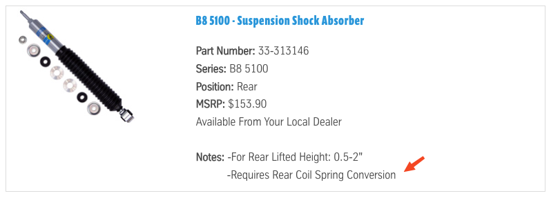

For any future readers of this thread, here's what I ended up learning on this (after a long pause!):
  • Bilstein does require the rear spring conversion (see picture below) for installation of the 5100s on a GX470
  • As far as I can find -- and confirmed by discussion above -- there is no technical reason for this, it's perfectly fine to install these shocks without a rear spring conversion
  • But unless you're doing this yourself, you may find it difficult to find a shop that will install them this way (I had at least one shop tell me they wouldn't)
  • And maybe more importantly, Bilstein may not honor a warranty if installed in this configuration (perhaps that's why they have the disclaimer)
