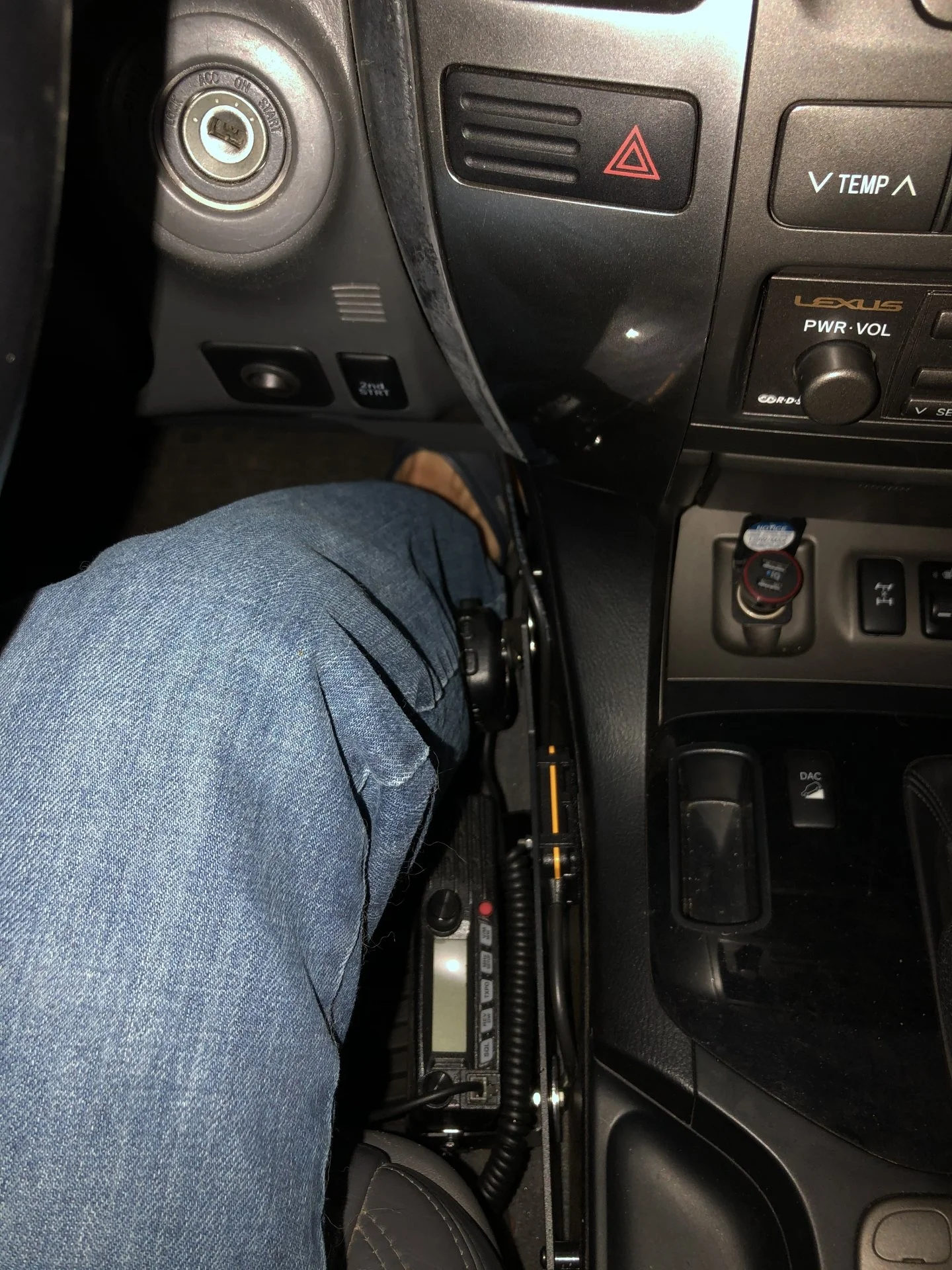

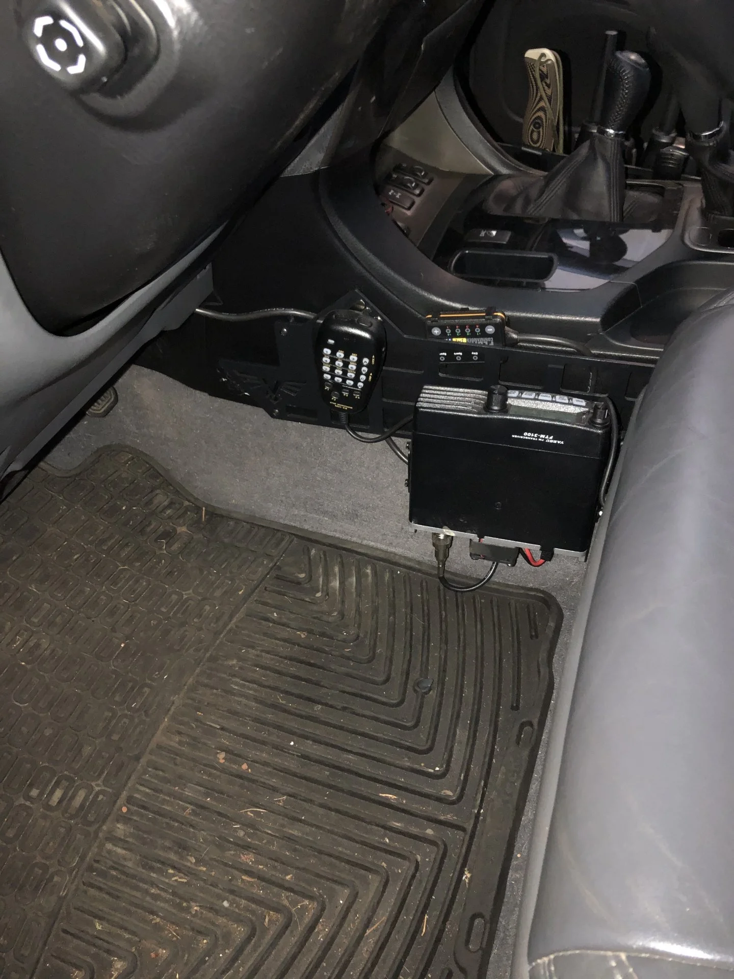

Probably of no help as it is exactly what you don’t want for do, but my install on the drivers side of the center console works well for me.
I have the Yaesu mounted to a Victory 4x4 molle panel, and it lives there unobtrusively.
One of the pictures shows my leg in my normal driving position…no contact with the radio body, and I don’t even notice the contact with the mic when it’s in its cradle.

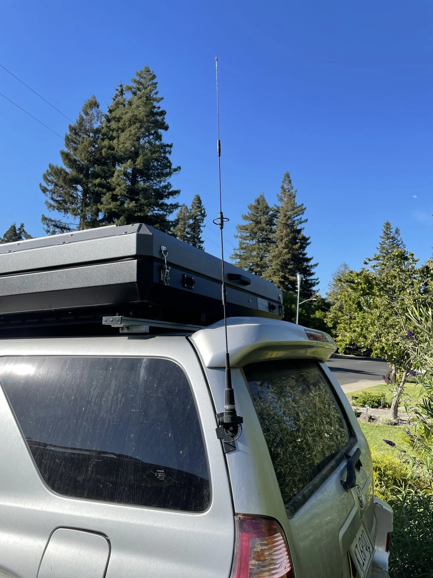

Also, curious what folks are doing for antenna mounts -- my rooftop tent will cover the entire roof of the car so not sure how best to handle. On my 4runner I was able to mount to the trunk using a Diamond K400S-NMO Lip Mount but not sure that'll work on the GX with its side swinging rear door....

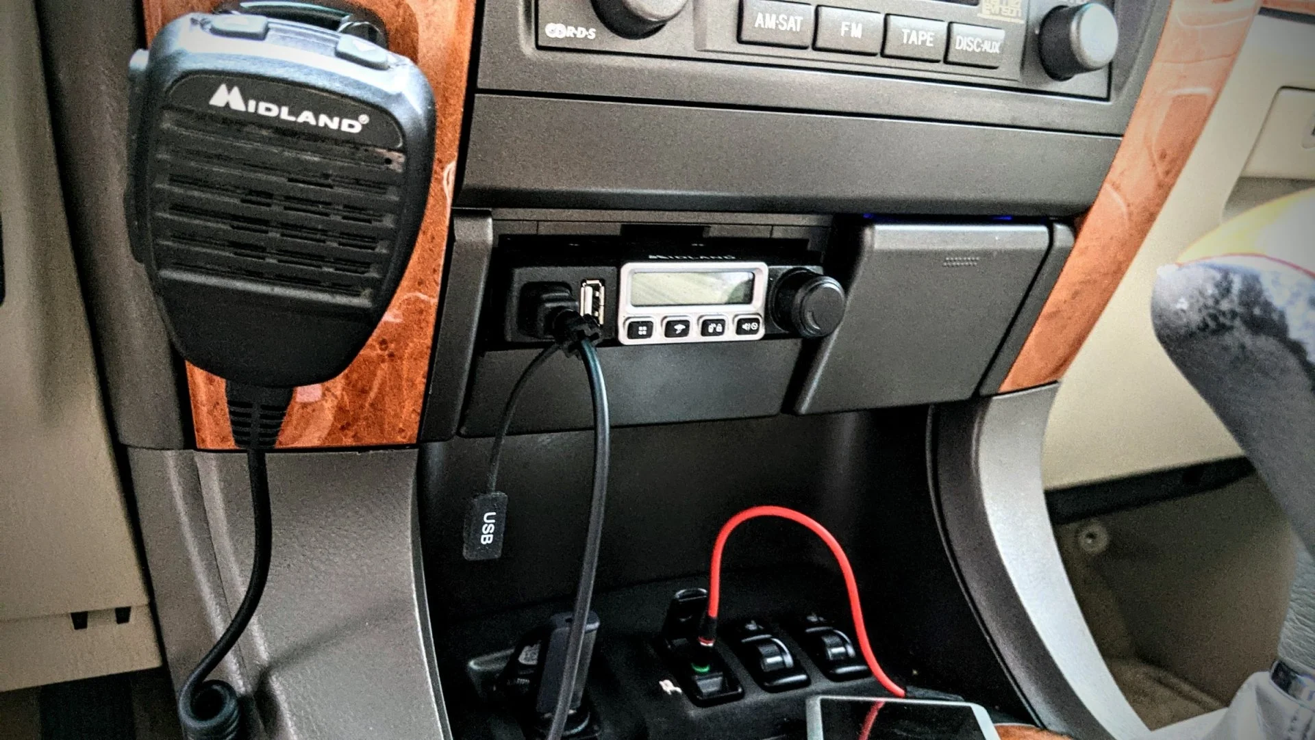

I did the GMRS in the ash tray and as posted earlier it fits like a glove! I did also take my ashtray face plate and cut it to make a trim piece below to give it a more finished look... this is a Lexus after all.
You can pull the assembly containing the 12v outlet and ashtray out completely, then separate the outlet and ashtray from the outer shell and reinstall, leaving you a nice open space for a radio. Not a whole ton of space depth wise given the HVAC ductwork and whatnot is back there.

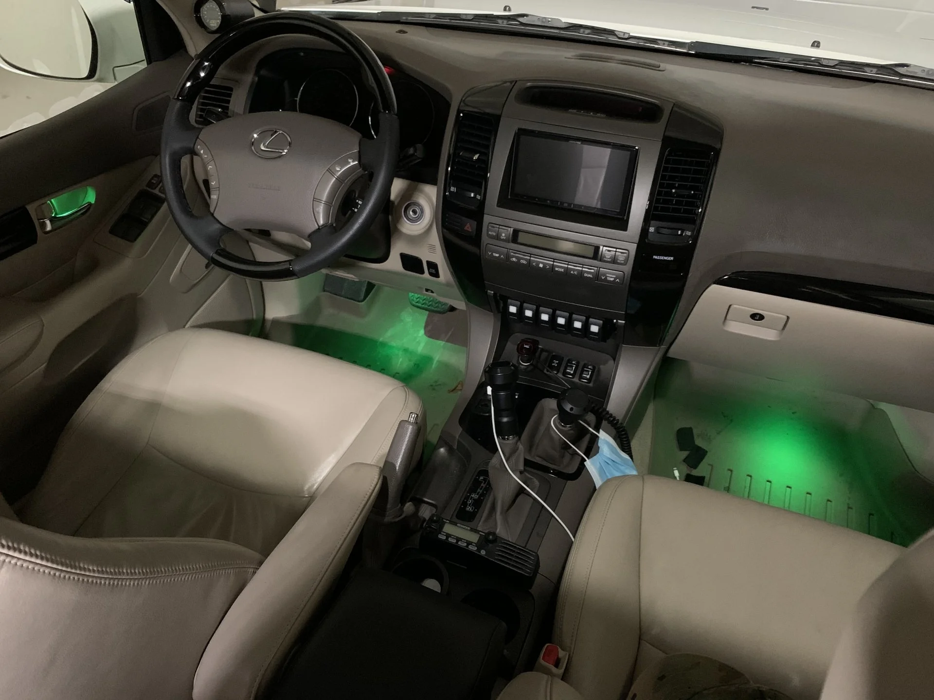

It’s the last photo of my post in the link I attached.
I did the glove box install also. Used a ball mount for the face plate. Fender mount for antenna. More pics in my build thread.
Thanks for posting. My son (orgx470) mounted his there and it didnt feel good to me.
