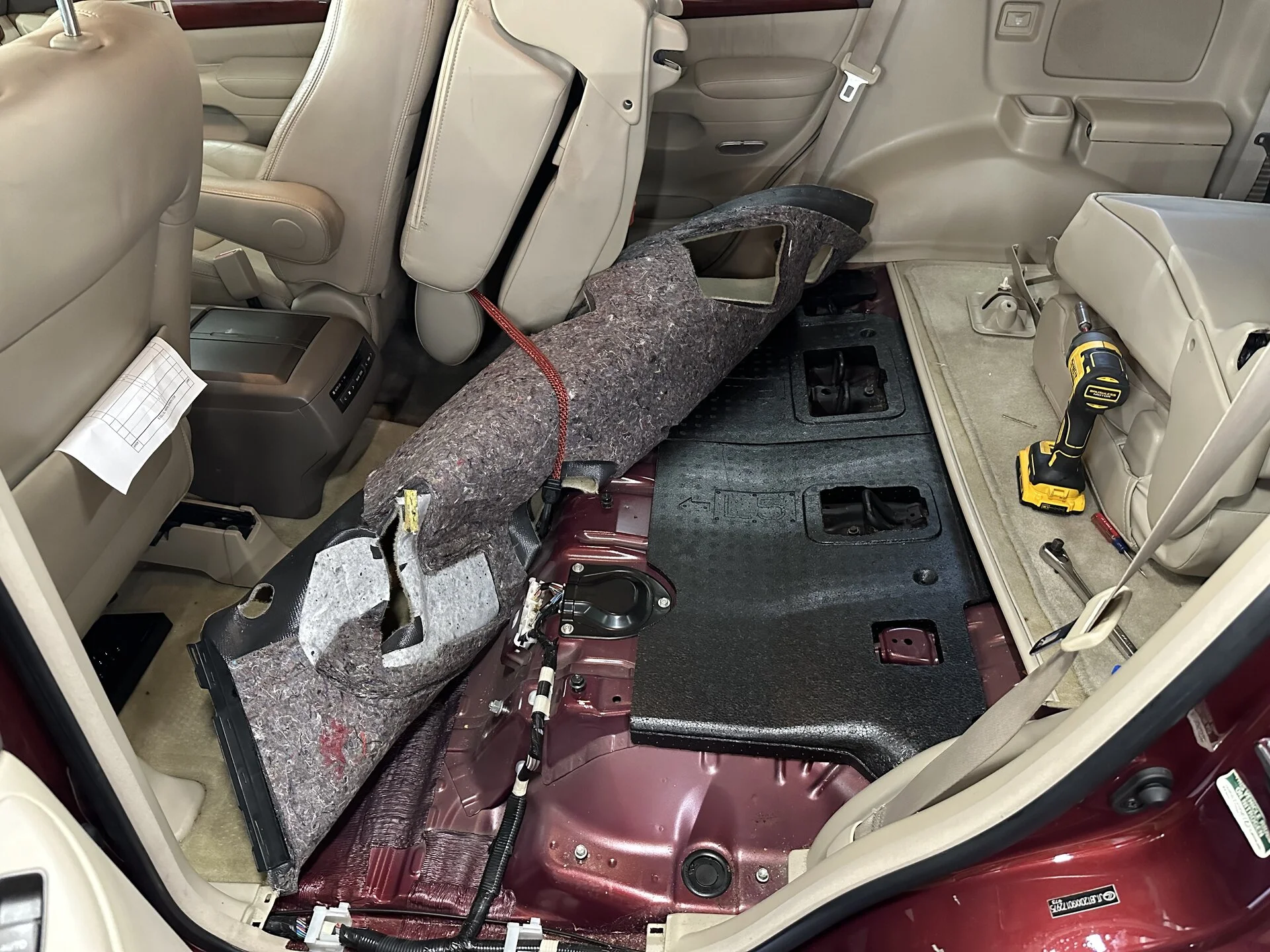

4. You can then pull the carpet forward enough to gain access (see photo in post 2) I used a bungee cord to hold the carpet
5. Undo the access panel (3 10 mm bolts) and unplug the white electrical plug, I used long needle nose pliers on this you have to squeeze pretty hard. (you do not need to undo any fuel lines from this access panel)

I have a fuel gauge sending unit problem and really appreciate the details Kevin put into his post. I've read through the 20 page FSM PDF Kevin attached. One question I have is regarding the arm of the sending unit. When you lift out the Fuel Pump assembly, what's the trick to prevent bending the arm of the sending unit? Can the arm be rotated up or down so that it is aligned with the long axis of the pump assembly or must one angle the pump assembly as it is being lifted out?
I say all of this because I'm really contemplating enlarging the floor board hole so I don't have to remove the tank and protector plate from the vehicle to replace the fuel pump assembly. Previous owner must have done some boulder climbing because the tank protector had a nice size dent in it, forcing the protector plate in by about 2 inches. I didn't notice it when I bought the vehicle 3 years ago and I haven't had it off road yet. This morning, I removed the protector plate to inspect the fuel tank. Integrity of the fuel tank looks fine. I attempted to straighten out the dented protector plate. Installing it back on the vehicle took more time than expected. Very few of the six bolt holes lined up, especially toward the back of the plate where the longer supporting brackets are located. I don't look forward to removing it again to change out the fuel pump assembly.
