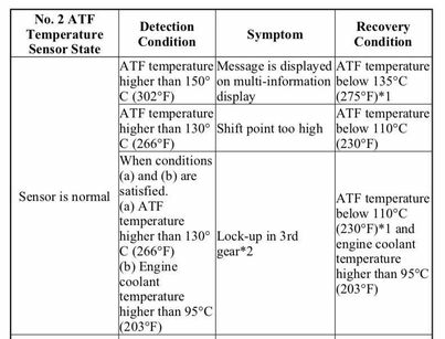

Overheat it and it can lock up in 3rd

Thanks for the "No 2 ATF Temp Sensor state" failure mode chart. Looks like i had a little bit of margin left b4 those conditions were met!
