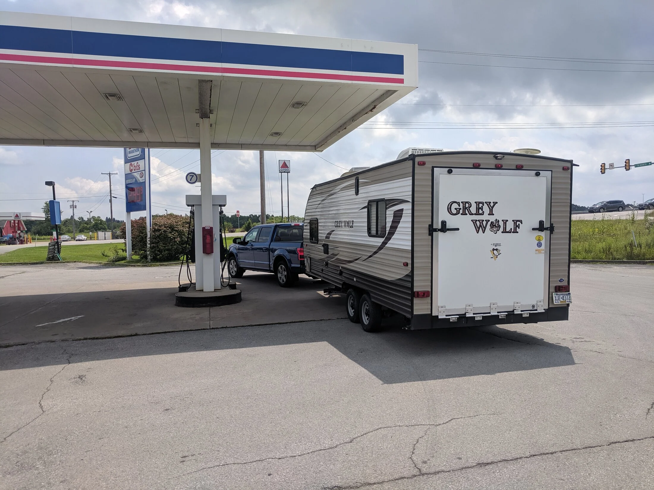

I have a Cherokee grey work 19rr 4k plus dry with est 600# tongue weight.

It should tow it, but that isn't a setup I'd want to tow for a long distance. For a shorter trip with a dialed WDH setup, once a year, it will do it. The dual axles will help a lot with stability, but you'll notice the trailer a lot more than with the Tundra.

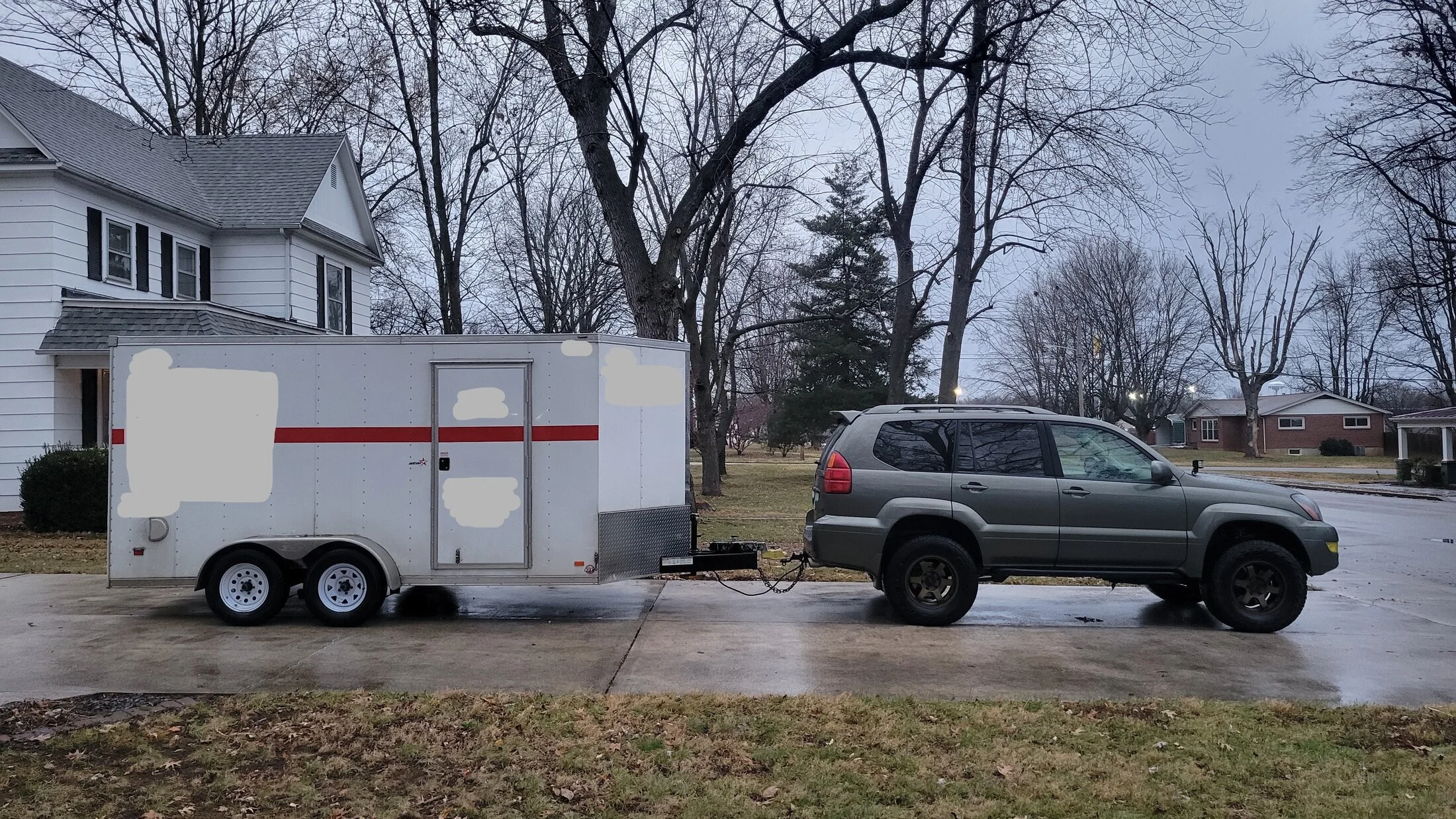

Just FYI - I had no problem towing this 65-70 mph - which is probably as fast as anyone should ever go towing. It's about 3,000# dry and I had at least 1-2,000# inside it. It actually pulled a bit better than my TrailManor camper, probably due to having tandem axles instead of a single axle, and taking the time to load it evenly.

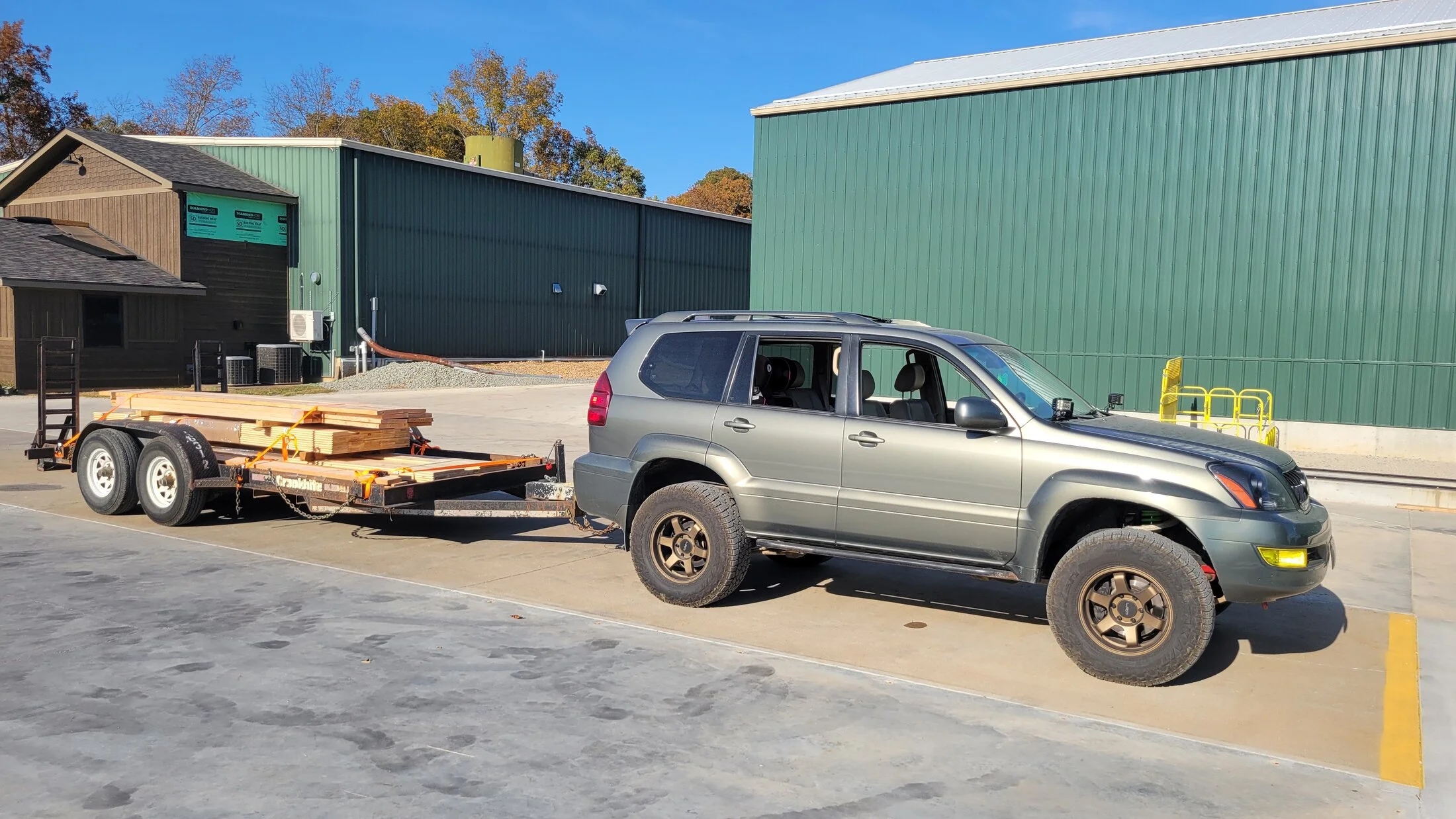

Plus this, which was probably around 4-5,000# total. It way by far the worst towing experience, as it was loaded with a forklift so everything was at the back end of the trailer and it didn't have enough tongue weight on the rig and was kind of bouncy. From a stability standpoint, zero issues and I pulled it 70 mph on a hilly 4-lane road. My rig does have headers....trans upgrades....and a tune, so power is much less of an issue than it would be on a stock rig.
