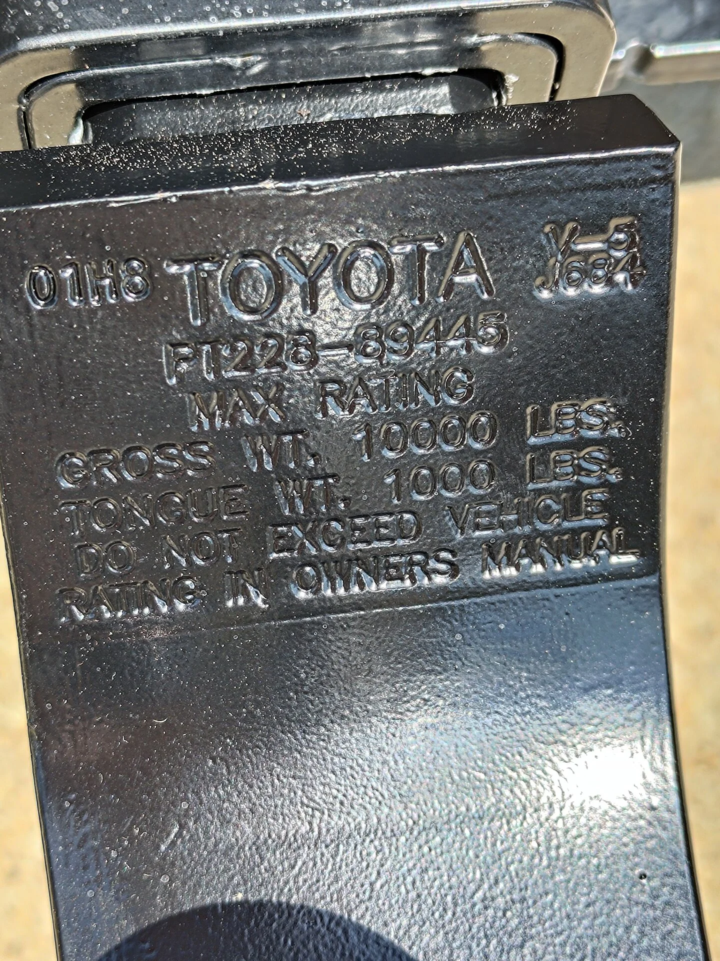

Speaking of towing, does anyone else have the factory tow package with a 6,000 lbs rated ball? I have the 6500 lbs factory receiver.
The ball came on the truck brand new and is a factory Toyota part number.
