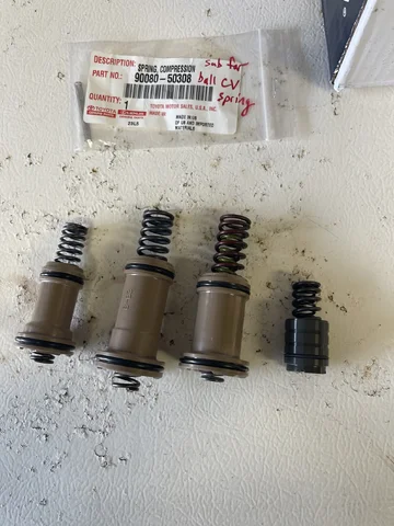

Pulled it apart. Check valve and spring fell out (spring was a little shorter than new one). Pulled 3 valves and replaced. Nothing to report besides slightly shorter old springs and semi flat o rings. BUT! The C1 (Sonnax for the replacement- it’s the only metal valve) was jammed in place. Had to grab and work it to get it out. So much makes sense now about why it worked great right when I took it apart before and gradually got worse each time. It was rotating back into its old worn seat where it would jam. Makes sense why the lubeguard worked at first. Makes sense that I had to rev it up to get it into reverse and why that trick was barely working lately. The C1 was jamming closed or only partially open.
Now I gotta put it back together and test this theory and add the Lucas
... still have reverse problems. I believe that’s it for this transmission and prob the truck for me.
