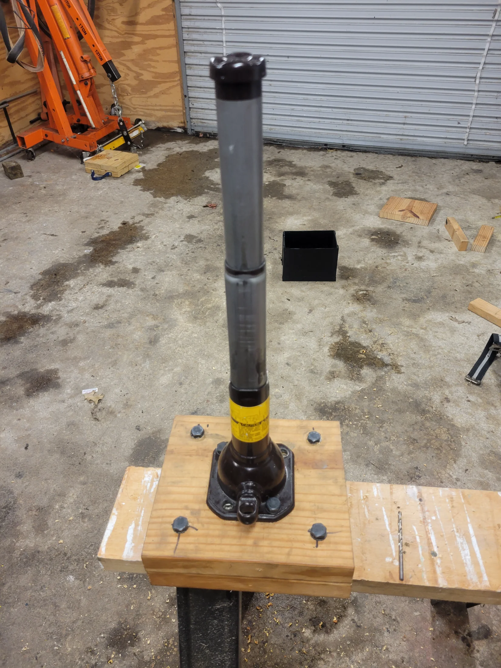

FYI, here is my current "solution". Haven't needed to use it yet (knock on wood), but it lifts up the OEM jack by 3" and should compensate for most of my lift (in addition to spreading out the load of the jack a bit more on the ground). The block is stored in the drawers I have in the back of the rig.

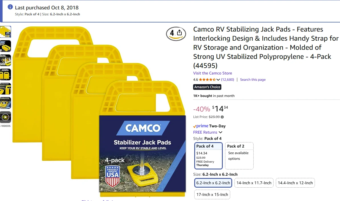

In the GX and buggy I use jack pads if I need more height. I carry them in the attic rack in the GX they don't take up much room and are light weight. And can throw them under a tire if I need to

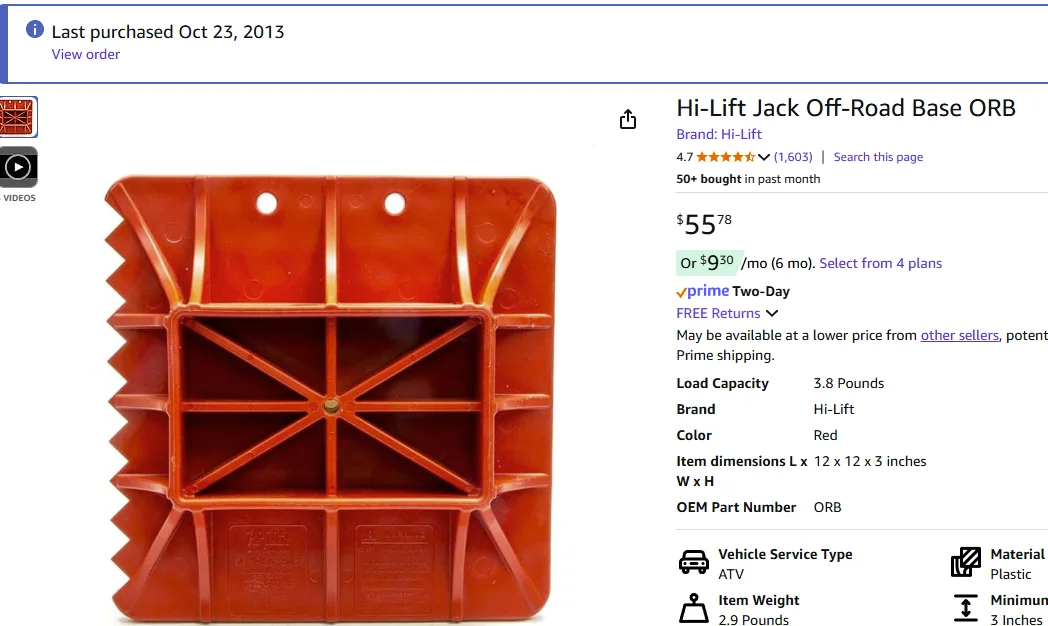

the safe jack base may be beneficial still. i’ve had jacks tilt which is a very uncomfortable situation. lifting from frame.
I keep one of these on my rig for my HiLift:
Have a feeling those that get the full blown safe jack kits are the ones that don't know enough to open the doors before lifting using the sliders.
Ha, I didn’t know that, but now I do. Did a trail recovery course (I4WDTA certified instructor) that demonstrated, among other things, how to use a hi-lift jack to lift from a tubular slider. I don’t remember that being mentioned.
I didn’t grow up off-roading, have only been doing it a few years, and although it makes some sense, seems like something that is learned or shared through experience.
admittedly i’m new to off roading, but will say that the safe jack base, or any similar base, attaches to the jack.
it’s not just a hard plate that the jack sits on. it has some screws that hold down the jack to the base, making it act as one unit. the other bases just seem to be a hard flat surface.
does the jack move independently when using traction boards or the plastic hi lift base?
