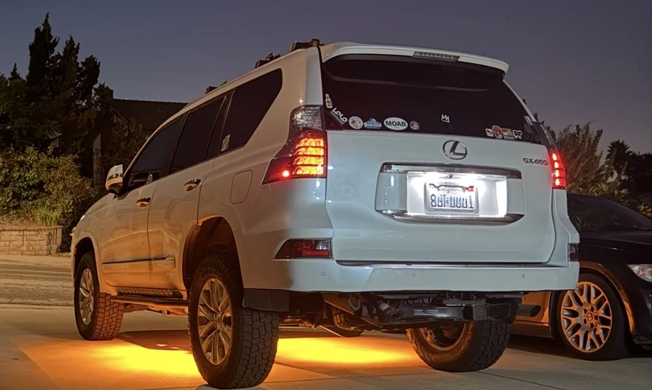

finally reinstalled the side step lights, after installing sliders 4 years ago. went with amber so it’s easier on eyes compared to white light.
I've been meaning to reinstall the lights on mine too. What did you use to mount them? And which ambers are those? Looks great.
lights, amber 4 pod version- https://www.amazon.com/dp/B0833PX96S?tag=ihco-20
mount- https://www.restlessoffroad.com/product-page/bolt-on-rock-light-brackets
The mounts were expensive and overkill for these lights. if I had to do it again, I'll bolt the pods to some magnets and stick them pretty much anywhere you want. It was a pain finding an area that had bolt holds in the frame, and that couldn't block too much light.
For wiring, I kept the factory harness and just cut off the old bulb holders and wired these in. The fade on/off still works.
Yeah for $50 I'll probably just zip tie or s***rig a mount haha

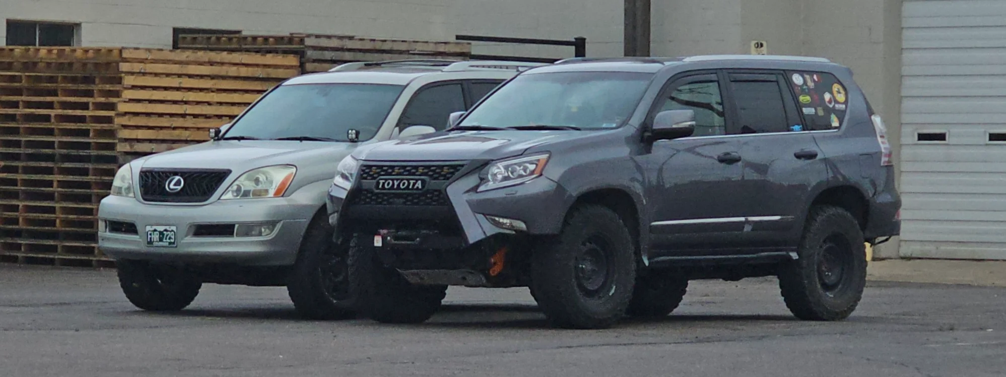

Looks like I need higher spring rate coils.
I added the winch ~70lbs, winch mount ~50 lbs, ARB skids ~60 lbs, RCI fuel tank skid ~50 lbs, dom sliders ~130 lbs.
I have stock springs at 1.75 on 5100s.
I am mostly unlifted now. As you can see with this pic next to a stock 470 on 31.5s i have 34s(285-75r17)
I dont really want to upgrade dampers yet as I have some things I want to try.
