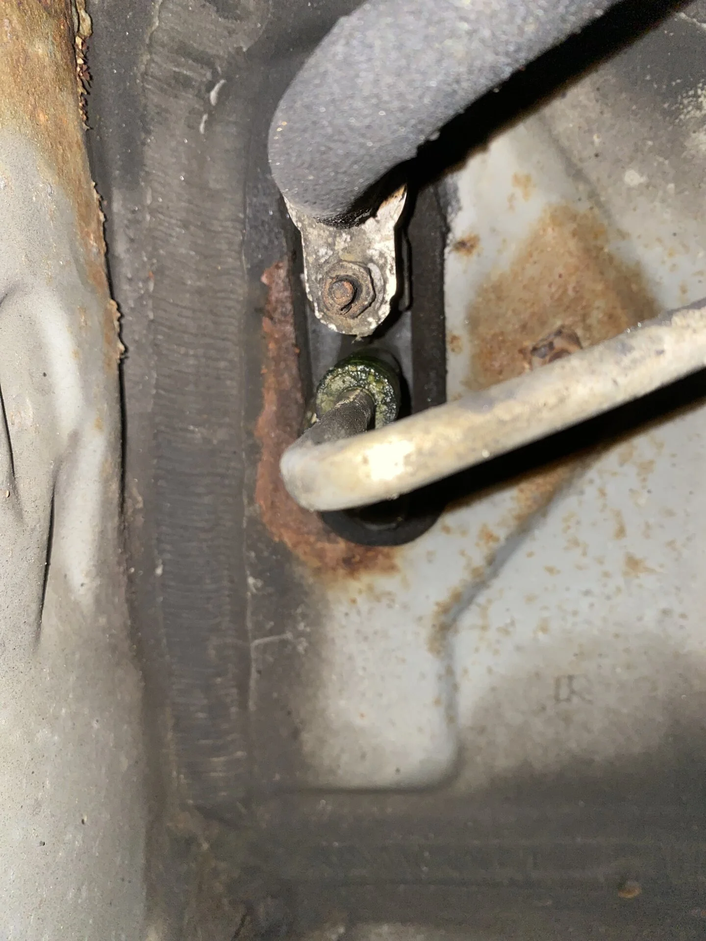

Mine was leaking above the rear passenger wheel, the connection above/behind the mud flap.
