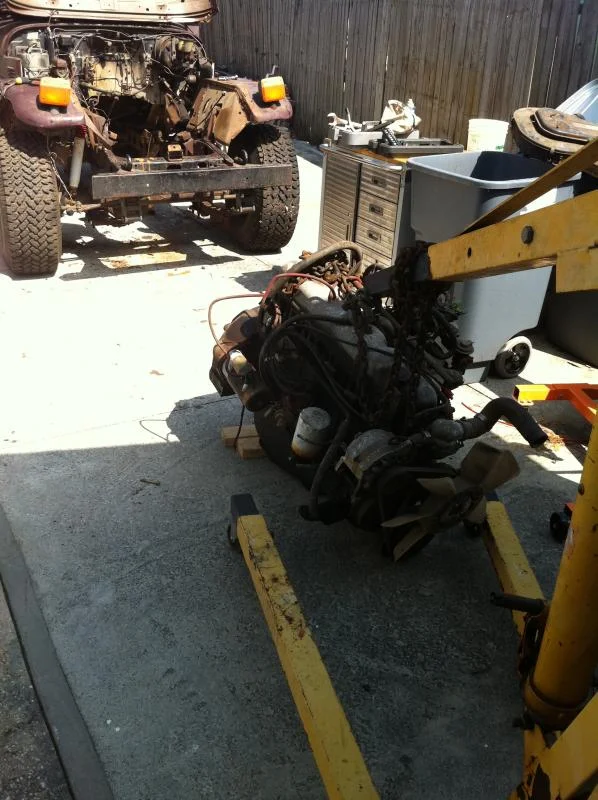

Engine Ran Fine
Engine ran good but I figured it wouldn't be a bad idea to redo since it was there in the garage. Here are some pics of progress of engine.
If anyone has detailed (clean) photos of their engine assembly that would be awesome. Pretty good with lables etc but wouldn't mind the visual (picture book) instructions for proper assembly of mine. I am removing the smog pump and could use any info on reassembly process without one on there.

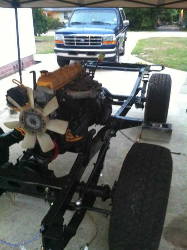

progress
Making some progress... been a long a treacherous road so far. For someone like myself never having taken on a project of this magnitude. Vehicular anyways. But I am pretty proud of the progress...
As to the color scheme. I agree, not my favorite either but i figured. For now, it is painted and protected. and will in the near future clean it, and get it back to aluminium color. My desire is greater to here it run again. It has been over ...hmm, I say 6 yeears since it cranked up. Of course being new to all this... I sure hope I did it right??? :eek:
Thanks for the help, from those of you on here who have assisted. I am sure there will be many more questions to come....
Engine in Yesterday.... Tcase/tranny today.... I like when I stay on plan!

Just progress...
After a couple days off. I started some "fun" stuff. I hated the previous color and while waiting for SS brake lines decided that there was no time like the present to change the color format. MUCH better. Thanks for the tolerance and patience with the HORRID color selection previously.
Was still conflicted about clutch slave cylinder mounting bolts...so I bought a tap. If it was not 10 x 1.5 before, it is now!! tap seemed pretty smooth, no metal flake, and tight when in. --> SO, Just FYI, if any one wants to know it is a 10x ? x 55mm bolt. Inherently when a bolt is at that length it has a 35mm shoulder. IF you ask for a shoulder bolt it is different. Gives you a 12mm shoulder. I just wanted a 55mm bolt, which defaults to 20mm of thread. after a **** ton of research and still not sure that was the "perfect fit" but it is what it is.
Spent a day.5 cleaning, blasting and repainting and started attaching. Thanks for all the support, enjoy.
Feels alot closer, yet still such a long way to go...
