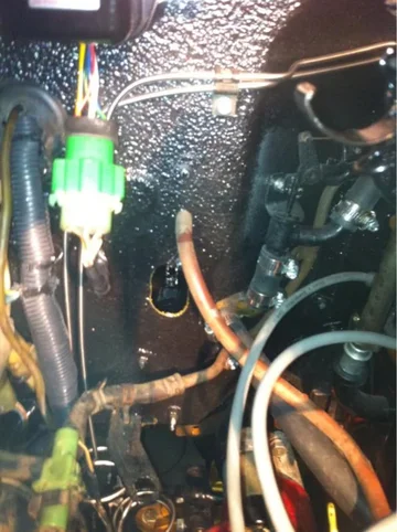

I need an electrician. I will try it myself, a good effort, but I just don't see it happening. Too much stuff to 2x's check. And problem solve... we shall see what happens there....??

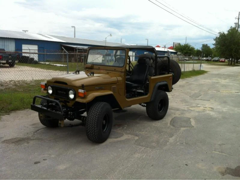

Progress
After a couple of tough weeks, frustrating finds, and PIA resolutions. Today was a good day.
!)Fixed the leak behind the timing plate... (Grant - OEM Gasket ;) & a bit of aviation) NO LEAK. All re-assembled and turning good.
2)recieved new/original stock perch pins/bushings....And after a lot of grinding measuring, careful PIA step by step, but all assembled Front and Rear today... and when it looks right, fights right, it must be right... Love going back to stock no more confusion.:p
3)2.5 over stock on new shackles.. Looks awesome, I like the stance. Did not realize how much difference it would make... but wow. Looks good.
4)Installed a new clutch line... having a small arguement with that... I think I will win. It worked before, but now can't get fluid back into the line. Will try gravity in the morning and if not, will have to do it another way.... Not sure why I am not getting pressure. (NO pedal) All I did was change the line. OH well, Resolution tomorrow.
Driving that thing in previous years has been dangerous. Fellow Mud Member taught me about Castor Angle.... Never knew anyting about it?? Got some 4* shims and that should greatly help. Might need more Degree... but will start there and look for improvement, until I can get to a shop and have it properly measured. I have 4inch re-arched springs (20years ago) with new 2.5" over shackles. WIthout any corrective measures installed... LMAO:whoops: I had no idea... Live / Learn
Got to do some small dis-assembly to get back under Tranny hump, AARGH.:doh: Figure that is just par for the restoration. but then it will be back and running. Was not looking forward to all the work that was ahead..... only because all the work that was behind....

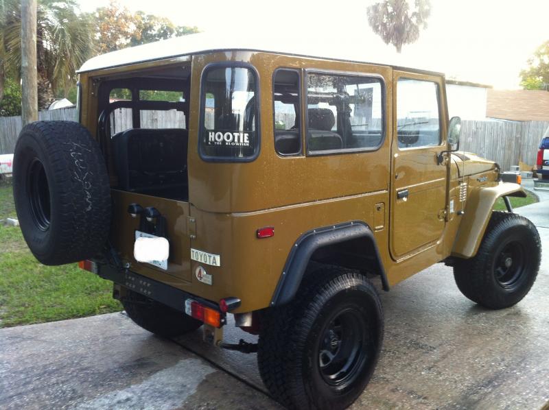

On the Road, and loving it.... runs great... A few more details but 96% and a few things to go until, its just a driver...
SO glad to have it back. Worth all the work....
Want to say thank you to all those who helped, and will continue checking in, Much appreciated to Ih8Mud. could not have done it without you.
I must call bull**** on you.
That is NOT just a driver. Amazing job, just really impressive. I think I'm about 2 years away from undertaking what you've done. LOVE IT! Rig is definitely a head turner.
Been gone enjoying the cruiser, so just now seeing this. The ride is "squirrely"... I am aware, need to get new leaf springs, those are so stiff, short, but have yet to "flip" them, so dealing with it, and still recovering the budget from the build. Once I put the shims up front it has become a much easier drive. The fear is gone.
Just enjoy being able to ride again...
Major Nelson... yes, I put a lot of work into making it nice, but it is not a garage car, and it is getting plenty of miles put on it. SO it is a driver, and its built to last. But I did like your comment, I worked hard to get it here. Back from the dead so to speak.
