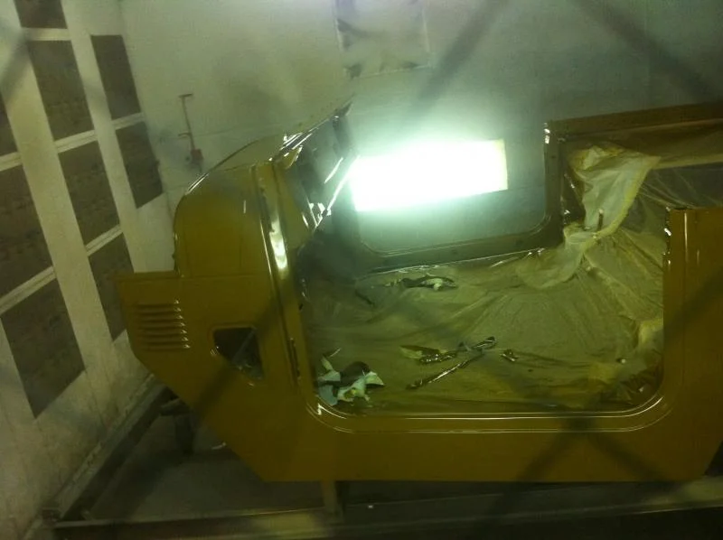

Just hit the paint booth. Looks good.

Some Paint Booth Shots.
Here are a couple of the paint booth shots. Will have more, better tomorrow. Obviously still some work, need to wet sand and shine etc. Then it will be coming home on its chassis and time to start re-assembly. A slow a tedious process. Not like Demo. :clap: But progress will be speedy if I can remember where all the nutz and bolts go....:rolleyes:

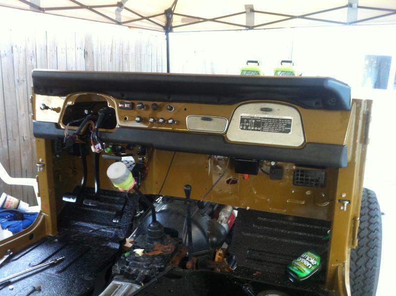

Just some progress....
Switches rebuilt, wiring harness - wrapped and loomed/installed.
Hope to crank it this week. And then find all the problems. :clap:
