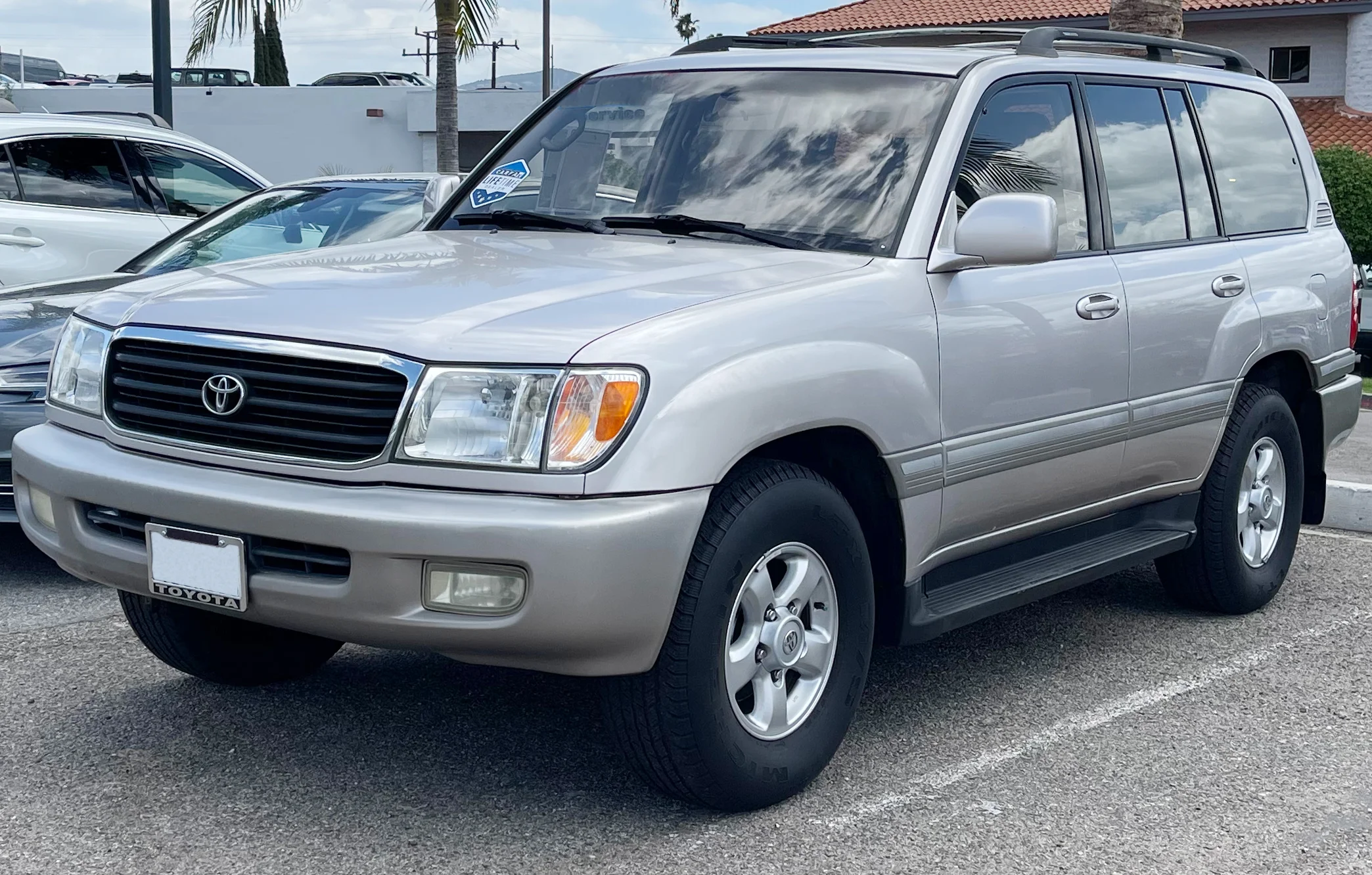

But, I am still on my search for the perfect 100 for me (and I now know, probably not), but I found a Southern California '98 with 250K miles with zero rust, factory rear locker (more of that in a second), clean interior, all electronics work, body is straight - but driver side fenders clear coat is oxidized a bit, serial number everywhere they should be, 25 years of CarFax and Toyota service records, no accidents, and the antenna still works and radio fades left to right/front to back, without blown speakers. For an agreed on $11,000. So that is seemingly good in today's market.
My issue is that I tried to test the rear locker (really just to see if I could here it click in, and the rear diff light stop blinking red). While in Park, I shifted I shifted to 4 Lo with no issue, and could row from Lo to high without issue. While in 4 Lo, I turned on the rear locker knob, but I never heard the locker, and the the diff light kept blinking (odds are this LC was never went anywhere other than the mall) so I engaged the center diff button which lit and I drove forward and backward about 25 feet, but I was on pavement, so I didn't want to do any turns. The diff light kept blinking, so I gave up on that experiment and shifted back to neutral and shifted to 4 high. I heard and felt light grinding (I don't know the name of the gears in the transfer case, but it stopped and I was able to engage 4 high. I repeated this while in neutral (from 4 lo to high) and could again feel the gears engage. I then repeated this in park and it was back to normal (no noise or issue from high to lo).
