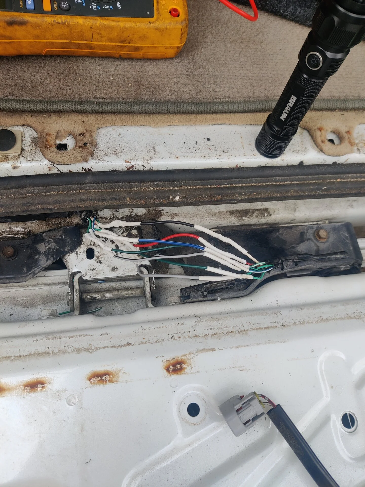

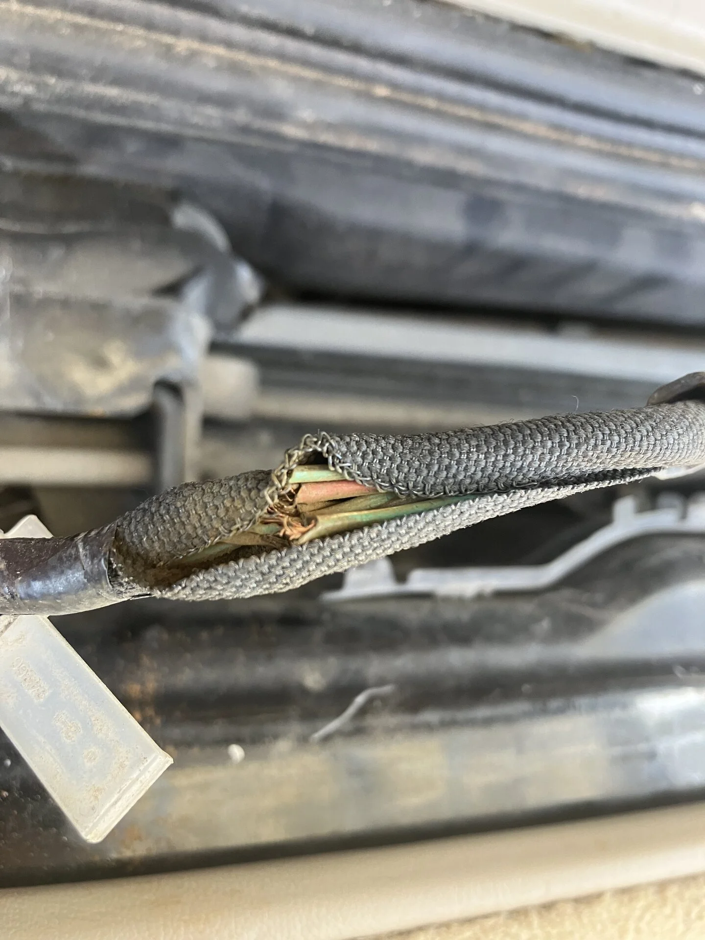

I just solved this same problem! The culprit was the wiring between the lower tailgate and body. These wires flex when opening/closing the gate and work-harden, eventually cracking, causing a short when your reverse lights go on. 4 of the 7 wires on my truck were broken but I just went ahead and replaced all of them:
I just solved this same problem! The culprit was the wiring between the lower tailgate and body. These wires flex when opening/closing the gate and work-harden, eventually cracking, causing a short when your reverse lights go on. 4 of the 7 wires on my truck were broken but I just went ahead and replaced all of them:View attachment 3565152
Thank you!!! I will be checking these wires soon. I will post back on if it fixed the issue .
Great news, I inspected those wires going to the tailgate today. Sure enough, they were all busted. I cut them back a bit and reconnected them with heat sealed connectors. It fixed the issue!!
