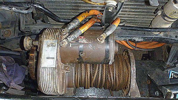

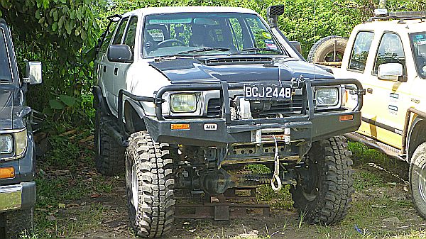

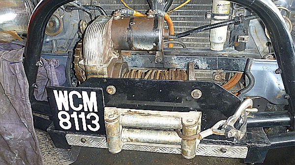

Well GREEN is back on its feet - the spare 8274 I had lying around ( I bought it over 12 months ago from someone for $2700rm $900USD) desperate for some cash and left it lying in the storeroom) was installed (since the XD9000 got smashed completely) - however upon collecting GREEN they informed me that the winch was intermittent and it would go tick tock tick tock aso you give it a tick tock tap with hammer and it might work.
I decided a trip to rawang hospital was required. The rules were mekanik would show I would do and learn. I took spare motor and sandpaper and tools.

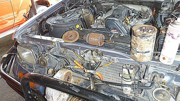

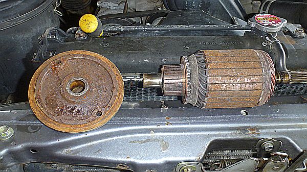

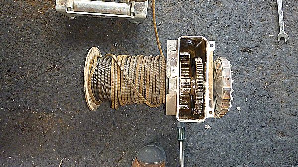

The motor stripped out - note the colour of the of the copper

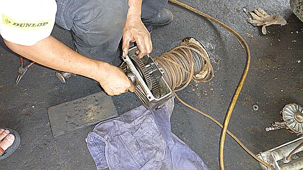

Then it was time to lift the winch body out and lift the top off.

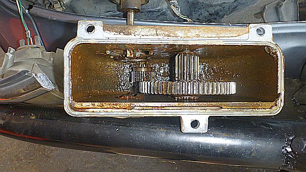

Observe the colour
of the oil
There was no oil in it only water about 1/2 a liter of it.

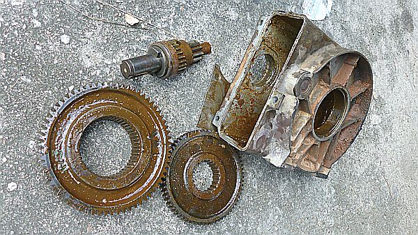

Then we had to remove the gears

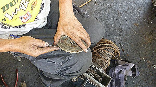

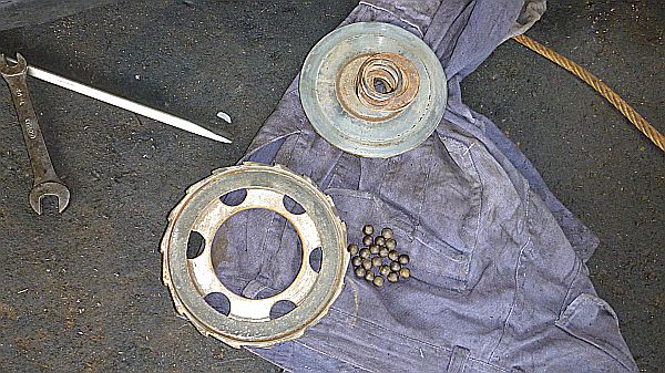

The brake and bearing was stripped next - completely dry and a PAD stuck to the metal backing.
So we had to pry it out.

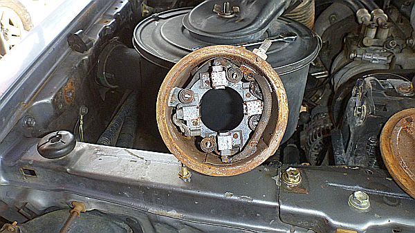

Then we cleaned it all up regreased the 21 ball bearings and put the brake back together and then reinstalled all the gears and then I had fun with the motor carbons all 4 were frozen stiff. WD40 and some pursation they now worked.
Then the motor was fitted back together 3 times yup I slipped the motor out 3 times by mistake and had to refit.
Then we put the winch back into GREEN and added a liter of oil and popped the top back in connected the wiring (thats to be replaced next they looking a bit old).
and a TEST and hey presto the winch worked and WELL
