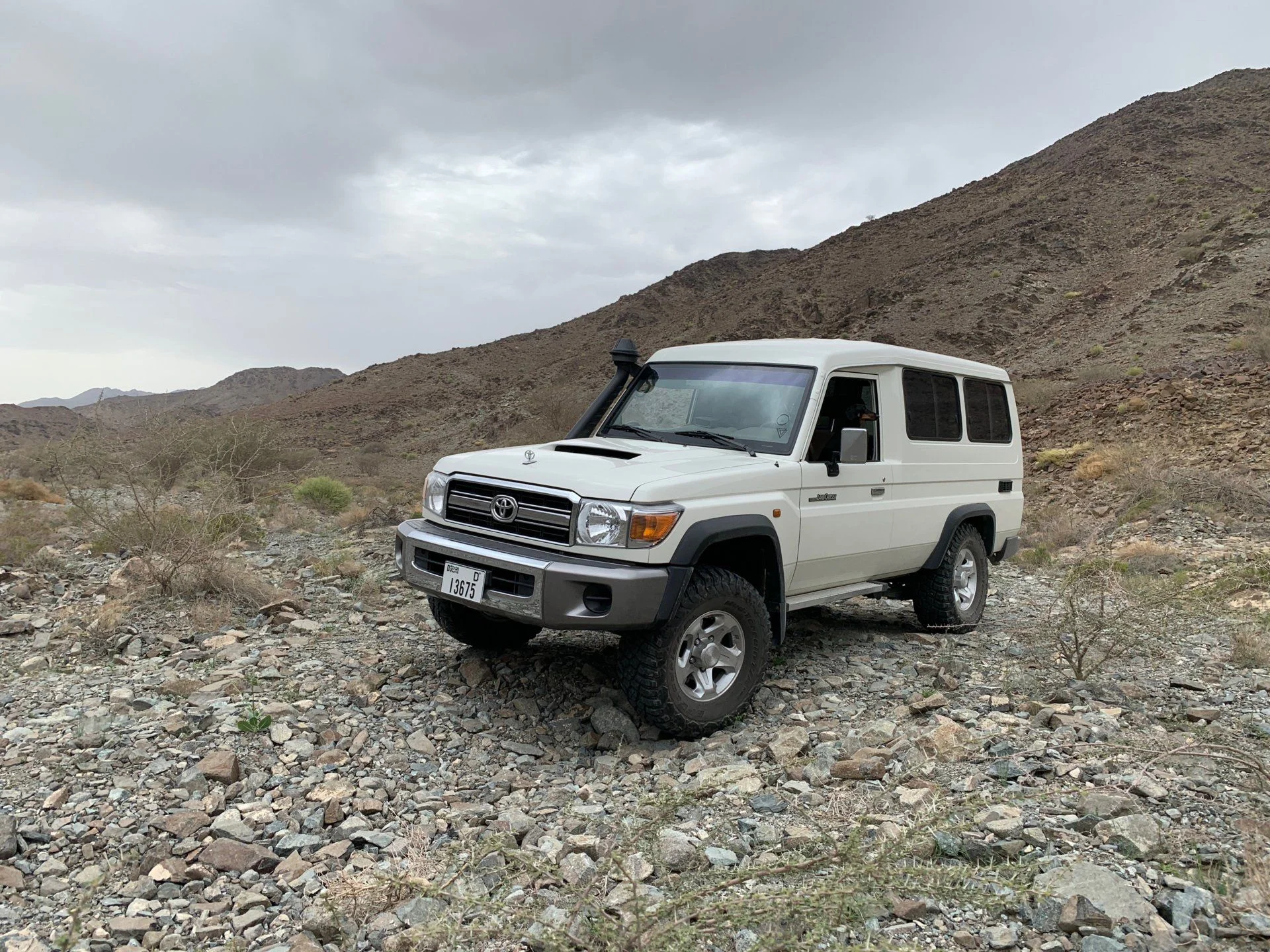

1,000KM under it's belt in little over a week and it's been so much fun to drive. Yes, it's not particularly fast (especially while running it in), and yes, it's noisy, but there's just something that makes all of it's faults (compared to much more modern cars) forgivable.
1930354
Modifications so far have been purely aesthetic. Some standard Toyota alloys to replace the steelies, and some 285/75R16 KM3s for a bit more traction up in the mountains and down in the wadi's. Road noise is no different to the standard pizza cutters.
Capped off with some arch extensions to cover the additional width the new tyres provide.

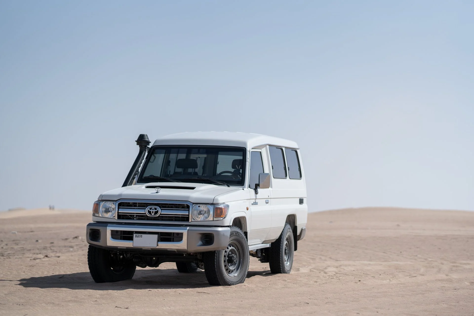

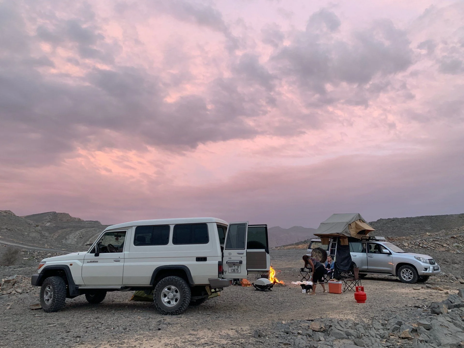

Getting my old 150 together with the new 78 for one last camping trip before the weather turns.
2010650
2010651

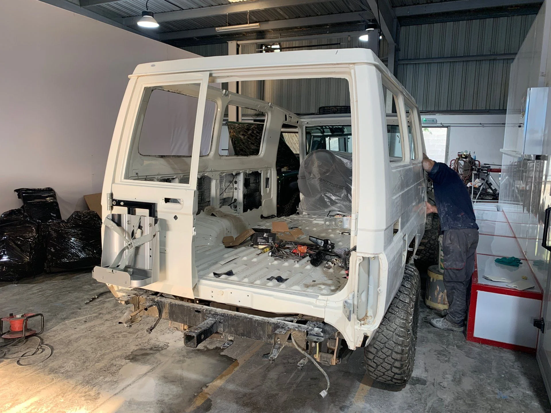

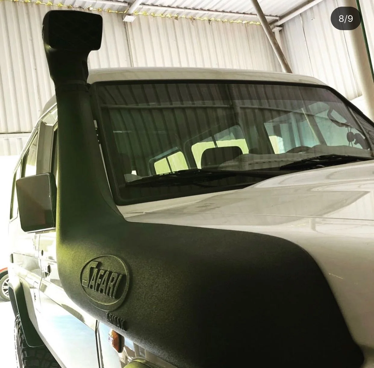

The last job to do before the strip down and respray begins. Cutting out the wing for the larger snorkel air feed, and modifying the airbox.

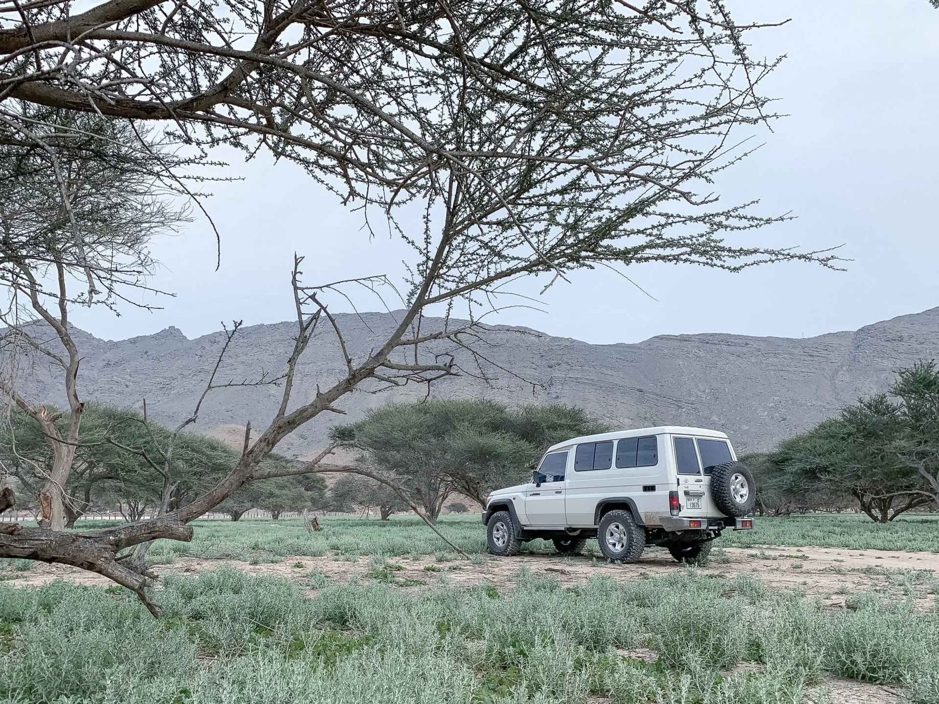

And one final night. Around 1400m in the mountains of the Musandam, the spit of Oman that sits in the Straight of Hormuz. Temps dropped down to 28c here at night, which was very pleasant considering it was 46c at sea level. Spent the night in the hammock, mount from McLean Metal Works.

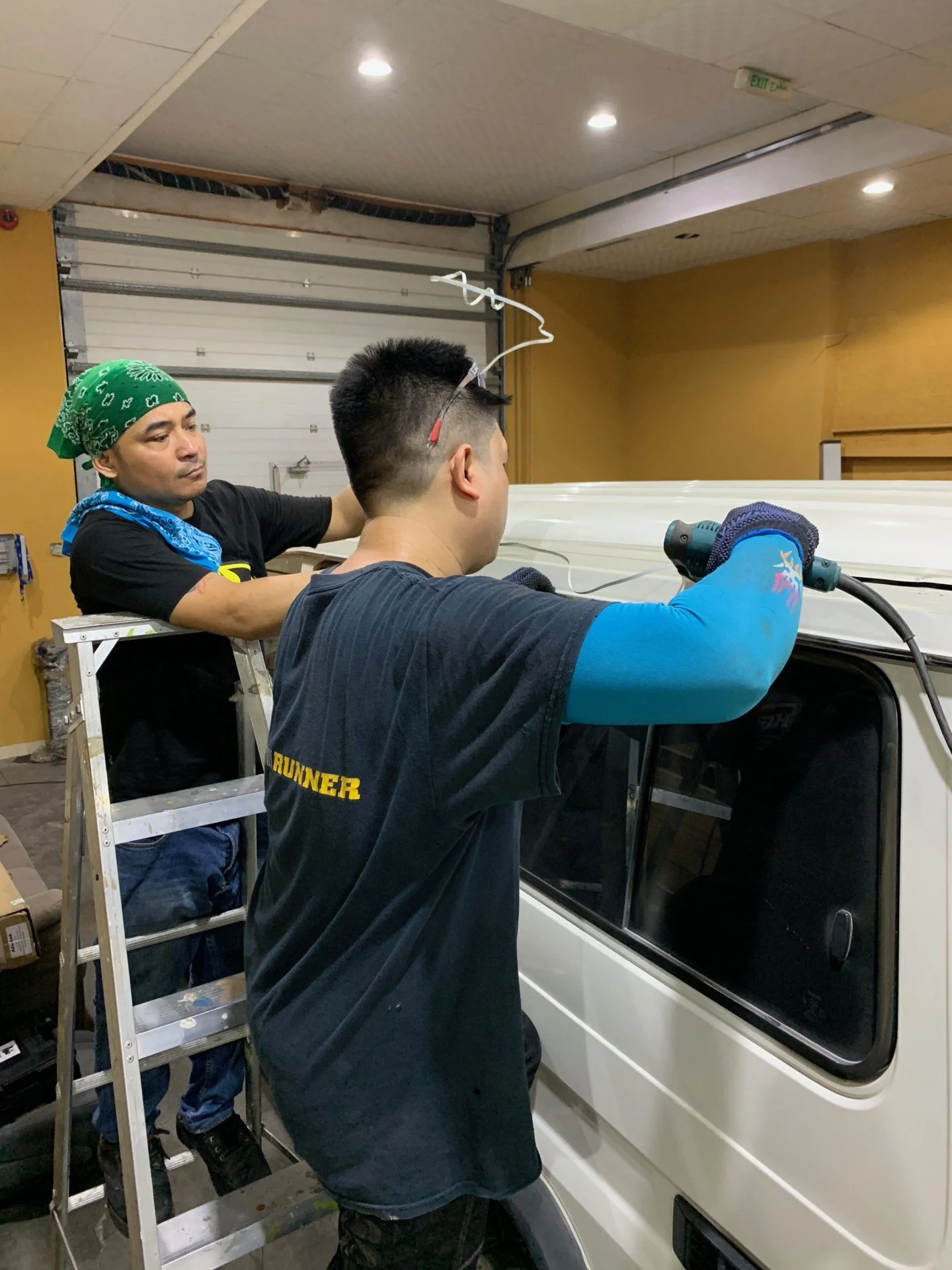

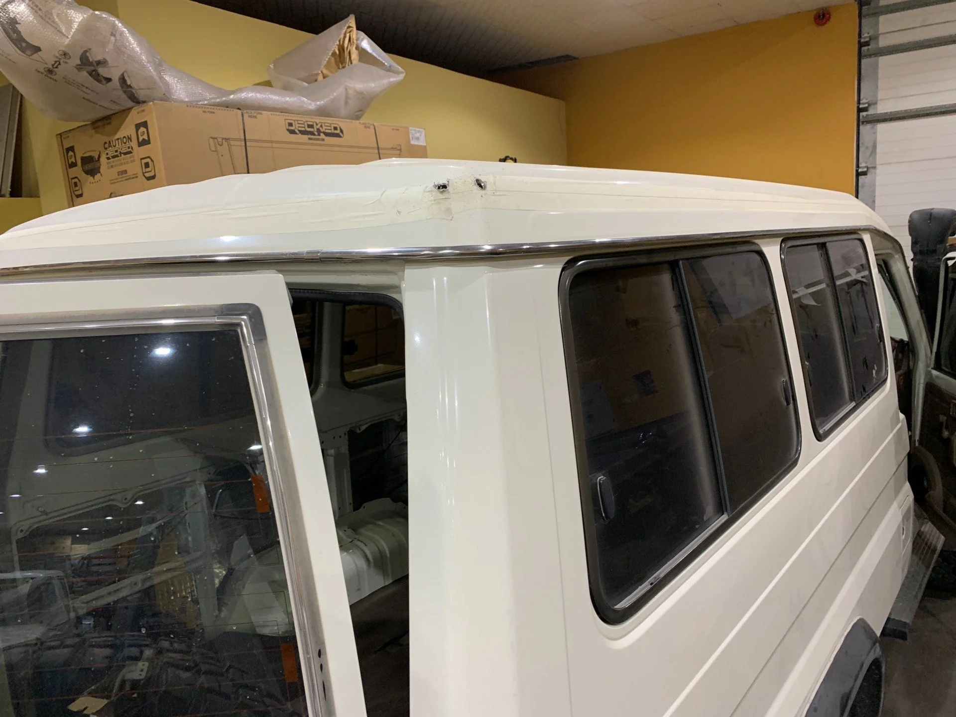

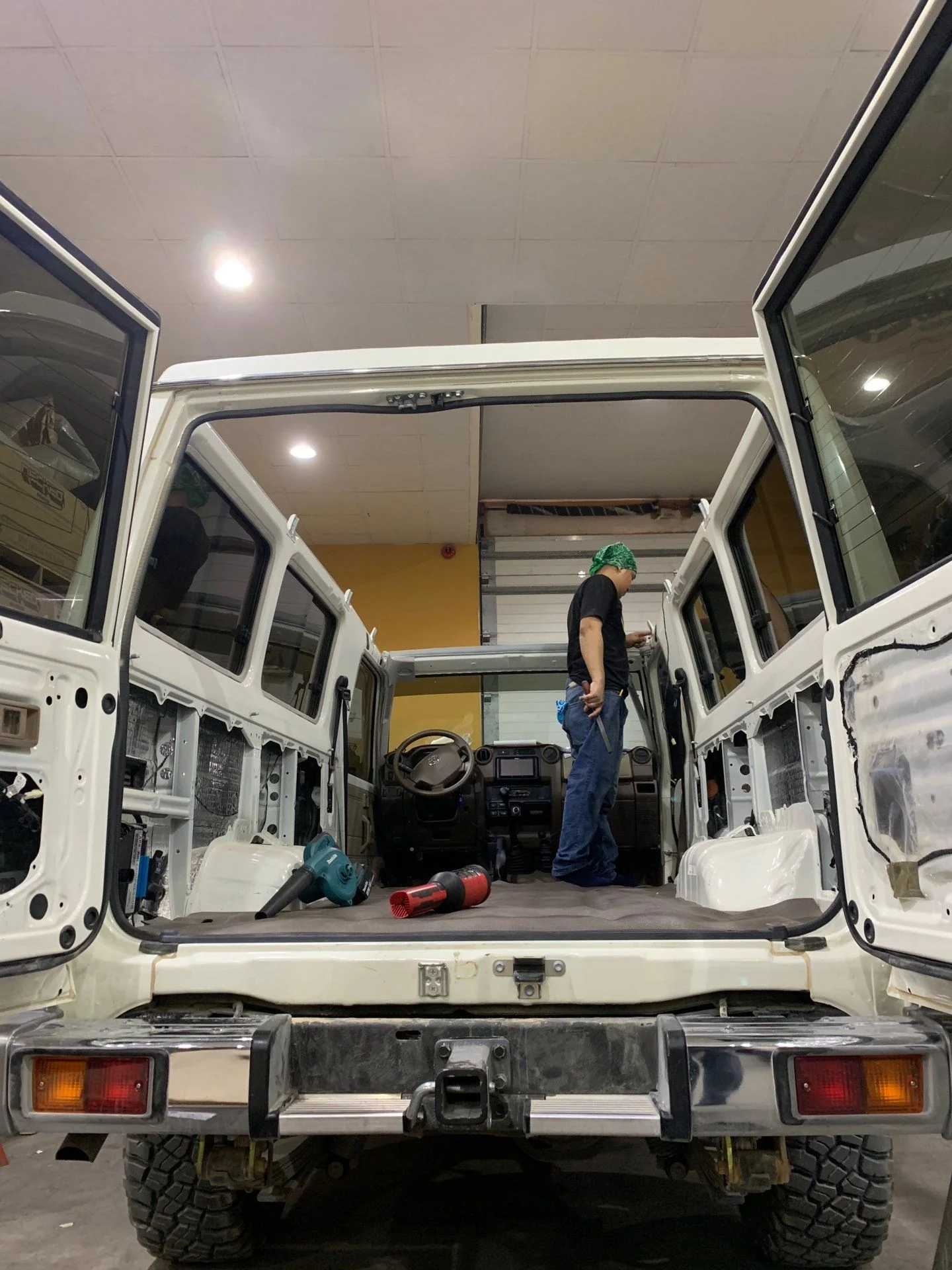

I'm working with a local fabrication shop in Dubai called Rad Expeditions for most of this phase. They've already cut the roof, tested the Hercules fitting, and removed it, ready for the paint.
2010655
Guide holes. Still time to bottle it...
Getting difficult to back out now...
2010659
And done!
A little tidying up, ready for transporting to the bodyshop. I was tempted to drive it down, being only 5km away, but didn't want to risk something flexing or warping.

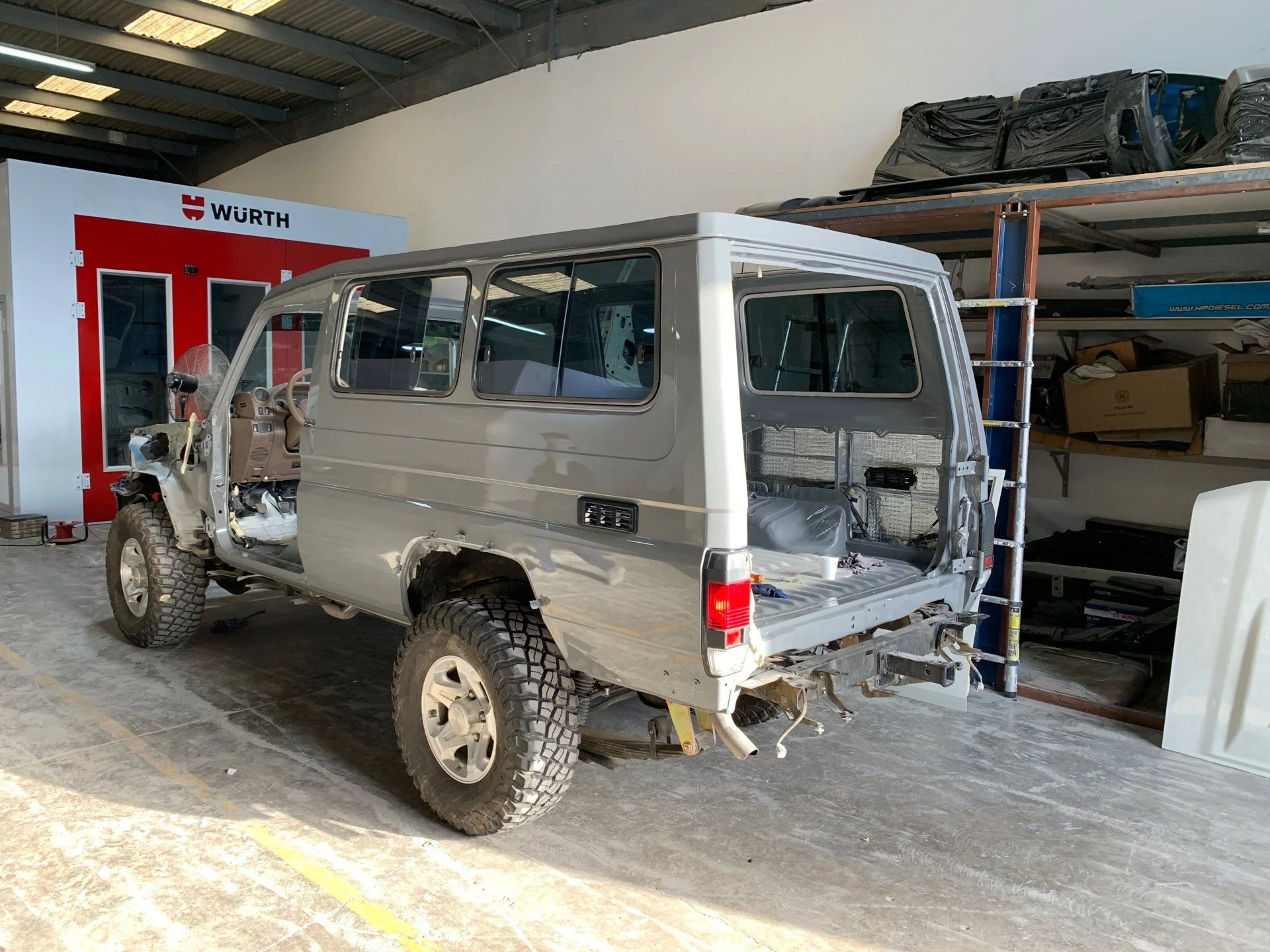

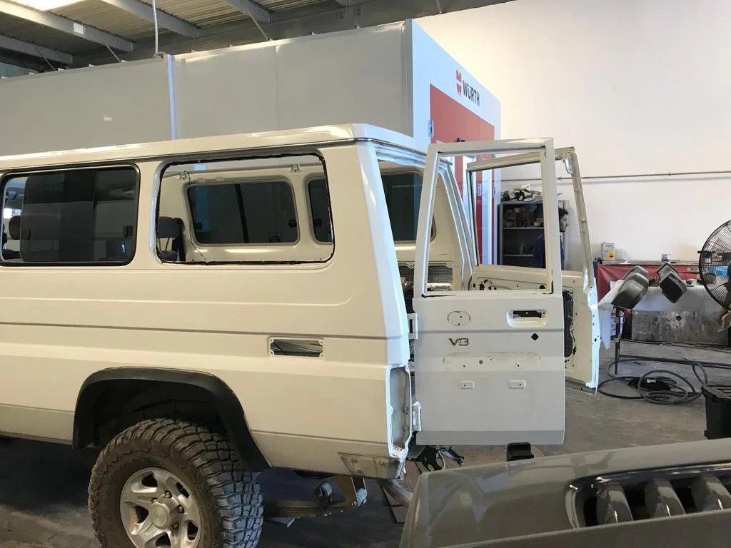

And so the strip down and prep begins. I'm always happy to pay the professionals to do the job properly, and I've been impressed so far by the quality of the work from the paint shop.
2010660

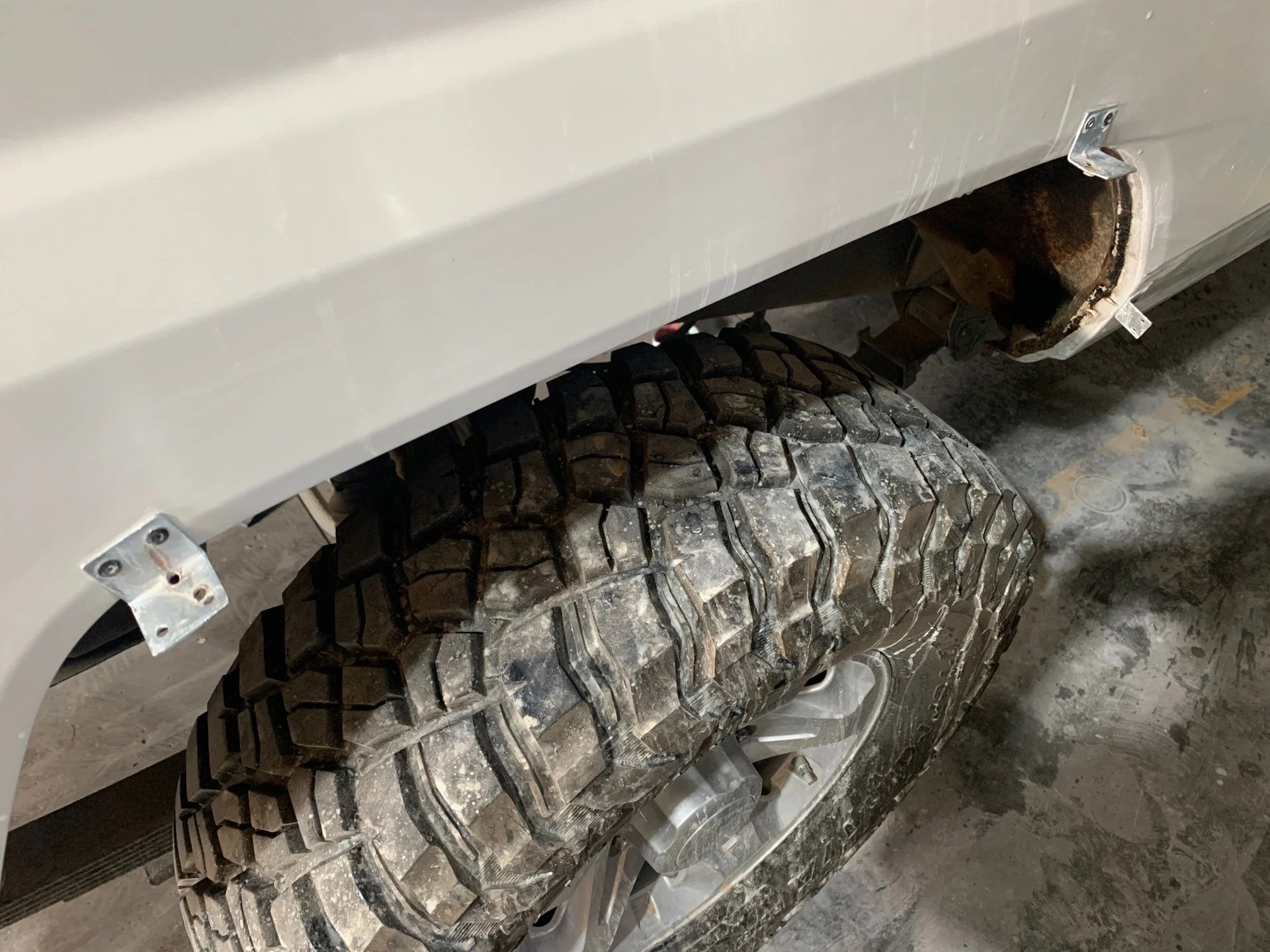

I've decided to replace the arches. They were poorly fitted by a backstreet garage, recommended by the Toyota dealers in Oman, of all people, who turned in to a bunch of cowboys!
2010661
These are the ridiculous brackets they "fabricated" and then attached using self tapers. They couldn't even drill holes properly! Rest assured, the bodyshop have welded up all the holes and rustproofed before prepping for new topcoat.
2010665

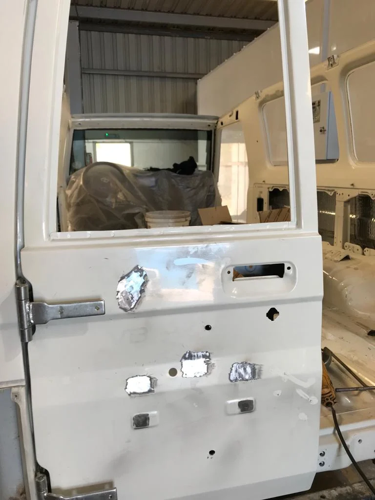

I've also managed to get all the bits to hang a jerry can off the back. These have all come new from the local Toyota dealer, with the exception of the can, which can FOC from a friend who took it off his 76.
Again, they've filled all the holes that are no longer needed.
2010667
And the new arches fitted up. These are again OEM, from the GRJ71.
2010670
Obviously just a test fit. There's still the rubber beading to sit between the arch and the body once painted.
