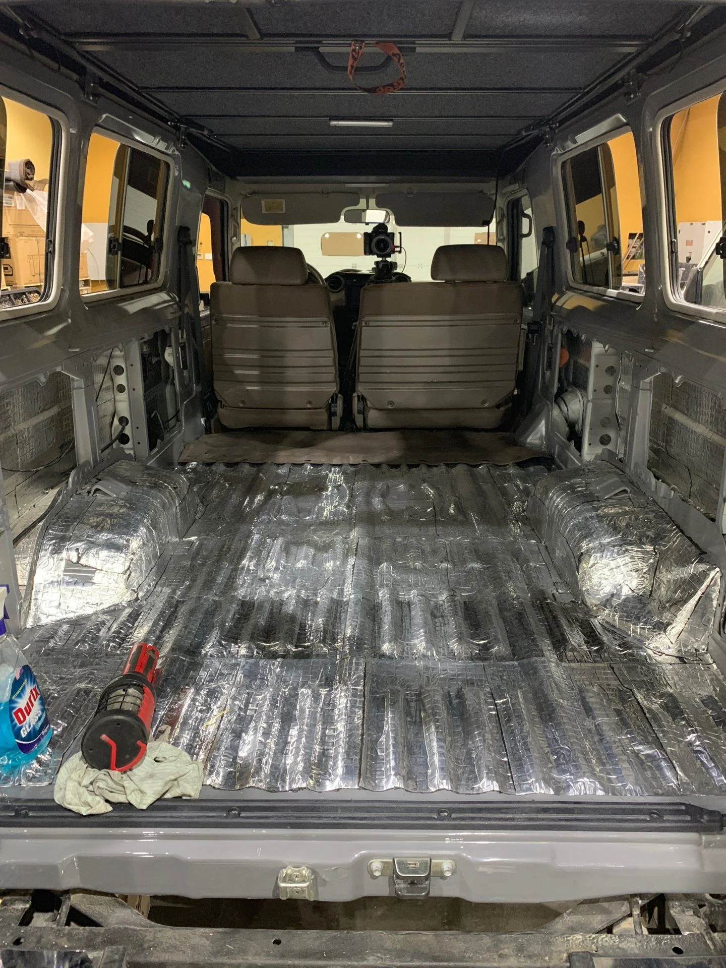

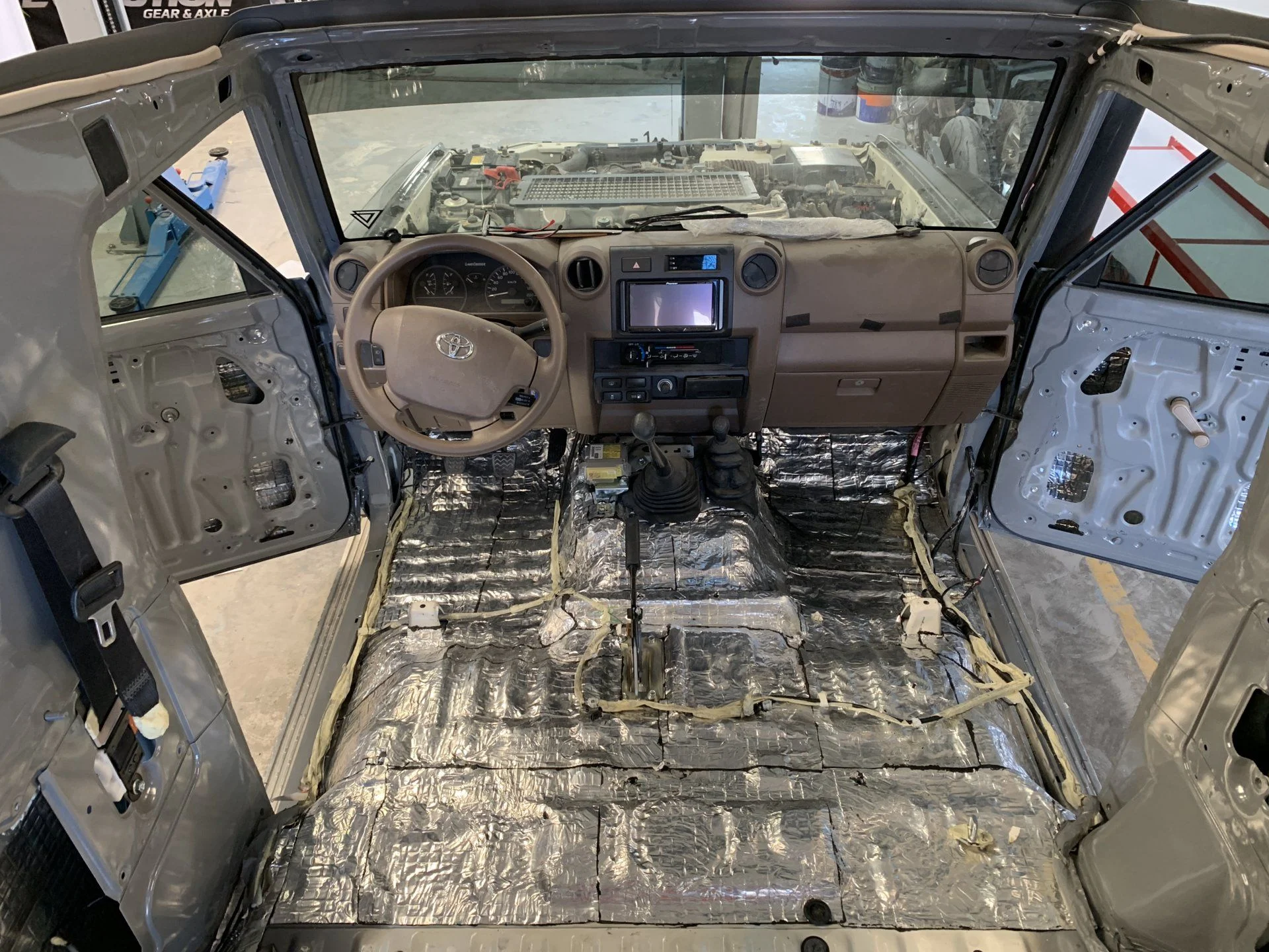

48c outside. What better to do than finish the sound deadening in the cab.
2015854
Consumed 5 litres of water over three hours, but finished the cab. Now ready to reinstall mats and seats. Rear cavities were finished a few weeks ago, but still got the rear floor to do next weekend.

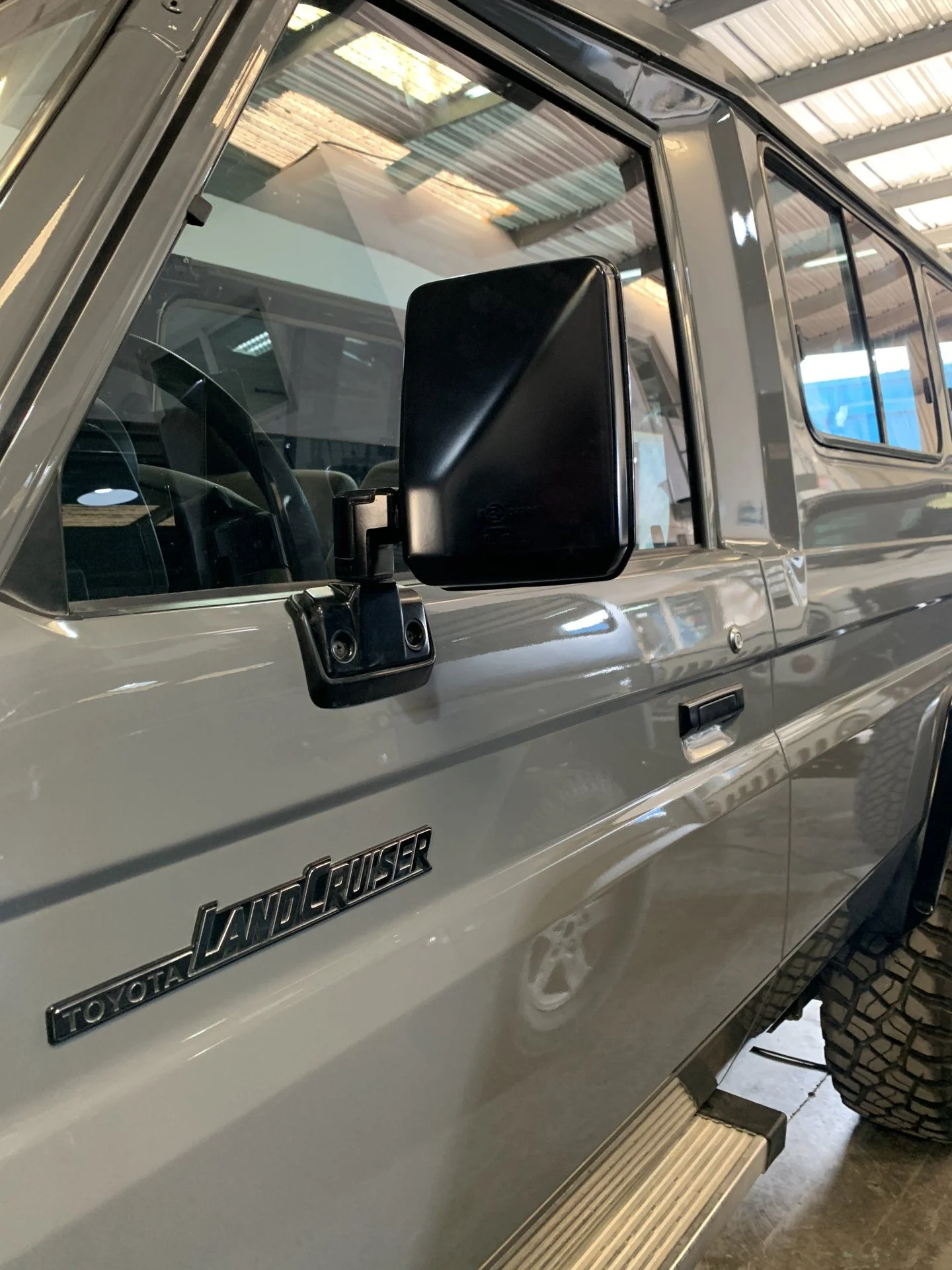

I won’t post any more images of the car now until the new wheels are on and the roof has been fitted.
I’m so happy with the way it’s come out.
I’ve had all the chrome blacked out (with the exception of the lock barrels and Land Cruiser badges on the side) including the Bull Horns on the bonnet (@TonyP thought your be interested).
So the paint was finished yesterday and finally the roof has been fitted.
All pretty straight forward and quick with the roof fitting, but I hear from a number of people that the awning is a Ballache. Luckily I’m just letting the shop get on with it.
Tomorrow I’ll finish all of the sound deadening on the load area floor, then I can start thinking of the final flooring for the living area.
The paint has come out a little darker than I expected. It’s not too dark, but definitely a shade darker and a little bluer than Nardo. If anything, it’s more like Porsche Slate. I’m still happy with it and with all the black details, it really sets it off.

Gone way over the top on sound deadening. 4mm in the front cab, with a 6mm closed cell foam, then 2mm everywhere else. Added about 40kg of extra weight, which I probably could've done without, but should make the vehicle a little cooler and much more comfortable on longer journeys.
