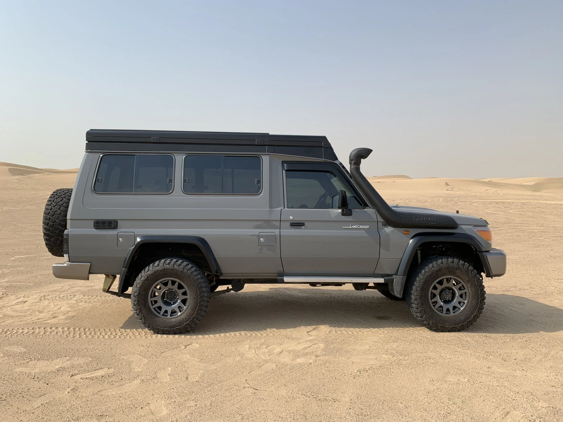

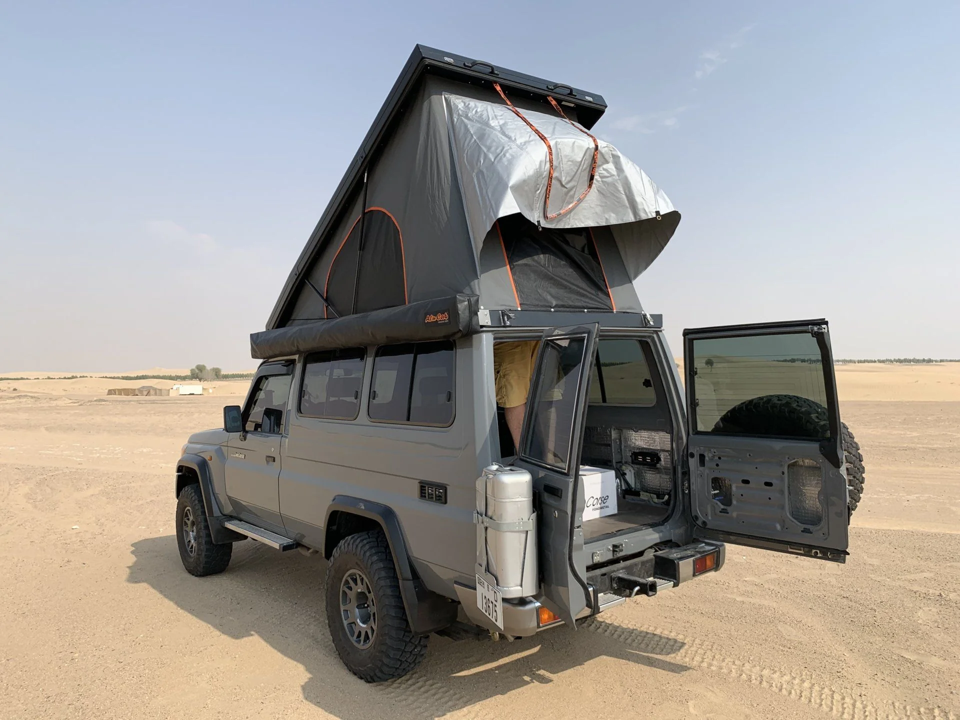

So here it is... roof on, roof up.
The colour looks different shades of grey in different lights. I’m still having to convince myself I’m happy with how dark it is, but not a lot I can do now.
The roof is incredibly difficult to pull down. So much so, I’m worried I’m going to snap the strap off, and the handles are bending considerably. I’m hoping it will get easier with time. I’m sure they’re standard struts, although I did ask for uprated, but never paid for them.
Anyway, on to the power and interior. I’ll share some floor plans this week for some feedback from those who’ve lived in these vehicles longer than I have.
I think the colour suits the car very well. Makes it look a bit more modern than the actual design is ;)
I think the color looks great! Not too dark, not too light.

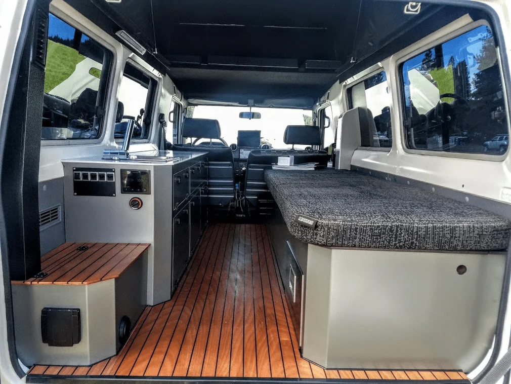

Even with the option of sleeping upstairs I normally sleep down stairs and enjoy the headroom. If it gets crazy windy you just close the top.
The way Maltec did their Troopy inside.
2022819
That interior is a great source of inspiration. Is there a fridge built in to the left hand cabinets?

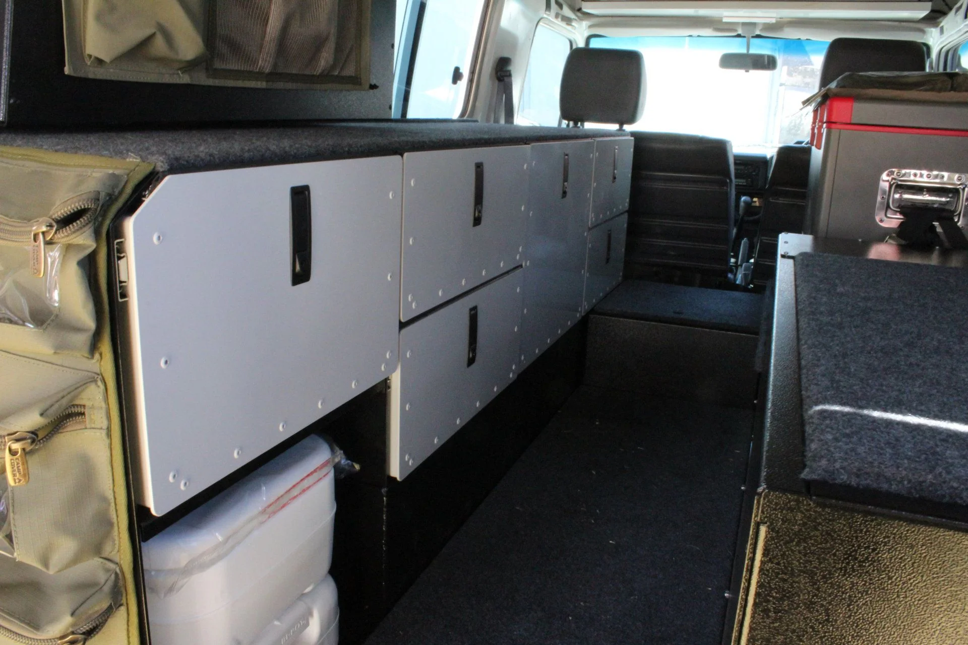

Drawer fridge on the passenger's side at the rear. Everything is lightweight with the troppys weight at 5900lbs as pictured. I fully understand as everything must be wife approved. I see storage as the biggest challenge for the interior. I will look forward to your interior build.
Ah, I see the fridge now.
My newest plan is to half the bench so the back half is the fridge (accessible through LH Gullwing) then the right hand side are cabinets with drawers and shelves, sink, plus boxed in Gullwing for some light recovery, shower etc).
I never used to like Andrew St Pierre White’s Troopy interior. But since starting my own build and going round and round on the layout, I’m coming around to it more and more.
2023823
I like the construction style. Once a CAD design is done, it’s very simple and quite cheap to produce. We have a great fabrication shop here who can get all aluminium panels cut by water jet, and the materials are not that expensive. At least then, I could try it, see if it works, then if needs be change parts of it without a massive expense.
I’ve messaged Quick Pitch a few times about flatpack’s of ASPW’s interior, however they never message back. There would still need to be some changes, like I would have the bench on the left and drawers on the right, plus I would have the fridge at the back of the vehicle (on the left bench) to work with my two rear gullwing windows.

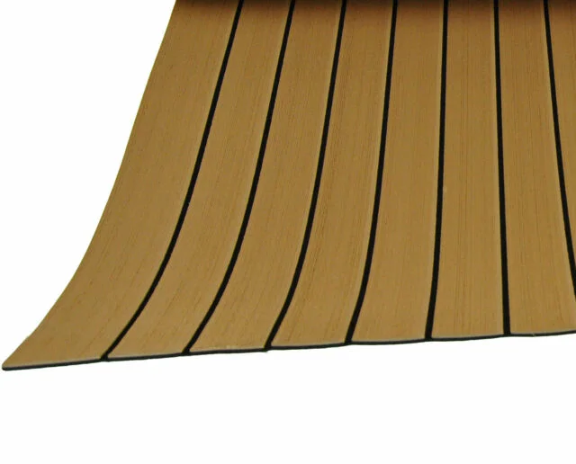

I would probably also look at softening up the interior a bit more with wooden top to the drawer cabinets, plus I have some teak style SeaDek flooring (looks exactly the same as the Maltec?)
