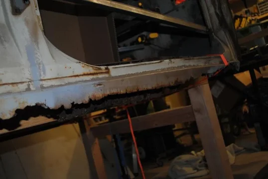

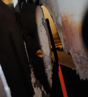

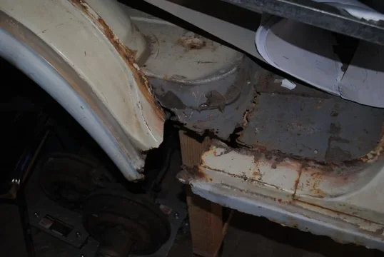

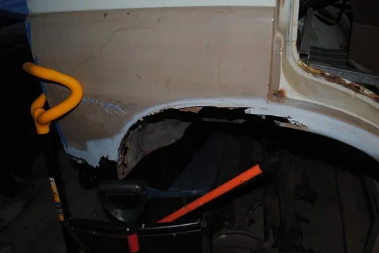

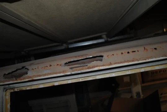

Anyone with some restoration/repair experience is going to be on the north side of the springs this weekend? If you've got some time to burn, I'd like an honest opinion on the 55. Doug and I have been discussing sandblasting our projects, and I honestly don't know if I want to spend the $$ only to get some pillars and a firewall back. I'm a bit too sentimental about the old girl and don't know if she is actually repairable, or if I'm just foolin' myself (wouldn't be the first time ;)).
Starting to think I could sell my 55 parts (take back my garage & shed) and get a rig I could actually wheel sometime this century. ???
Thanks in advance...
:frown:
You wouldn't want my opinion. In the automotive world, there are drivetrain guys, and there are body guys. Usually the drivetrain guy has a ridiculous engine, trans, and axles stuffed into a vehicle full of rusted holes-- then there's the body guy that has an immaculate interior, a waxed paint job, chrome everywhere, and an engine that is just adequate.
I'm the drivetrain guy-- I would rather take my rig out and dig through grease fixing busted stuff for hours every weekend, than spend one single hour fixing rust. Rust never stops, it doesn't even take breaks, and it's always going to come back. I know you love that cruiser dude, tough choices. Life is short, lets go do something fun :)
Yeah..........
No one worry about stooping by. I'm sure I'd just try to talk you into the conclusion I've already come to. Too much time (time away from the kiddos/wheelin'/etc.), too much skill (that I sorely lack), too much $$$$$$$$ (which, well......;)).
Reality:
Even if I do chop/hack/weld/fab a Frankenstein 55 together that looks halfway decent, there's still an engine, trans, transfer case, axles, brake system, fuel system, all windows, steering system, lockers, wheels, tires,....................... basically, building a hacked 55 from scratch. :bang:
Or, I could just go buy that 4Runner, hammer out some dents, and wheel it. Upgrading or repairing as needed. NOT building a whole SUV from scratch.
Anyone want a 55 project? Needs a little work. :grinpimp:
