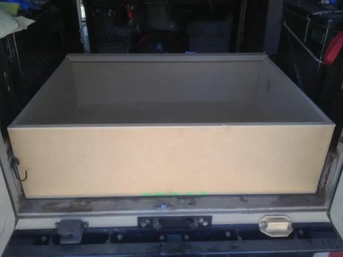

Sort of out of order in the project timeline. I got my high school grad to build me a stuff box for the back as his final shop project. Still need hardware and stuff. Will eventually have some speakers and a amp inside too.
