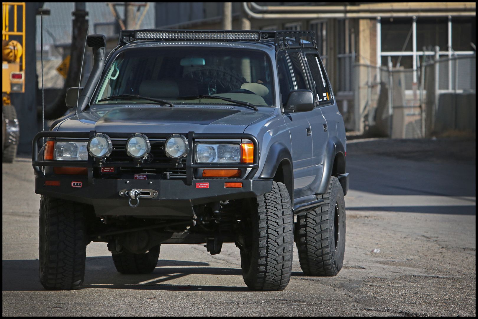

Having the lightbar set back from the edge of the windshield help a lot. The roof will create a shadow on the hood so you don't get glare. I still get a bit of light that hits the front 1/4 of the hood but it does not affect visibility. To be fair, I also have a blacked out hood center which also helps.
Lightbars definitely light up dust/fog in the air. If a lightbar is your only aux light source then I agree it will be more useful mounted lower but you'll sacrifice a bit of distance. Having multiple lights to throw light differently has worked well in my experience. I have 3 HIDs on the bumper that light up the road well up close but have excellent distance. My roof mounted spot/flood combo LED bar has a much shorter throw than the HIDs, but fills in the dark spots between the HID pattern and has a nice broad throw to give good right and left visibility. Amber lenses also help a lot with the dust.
Ideally, I think a bumper mounted LED to light up the road and sides for short distance stuff and roof mounted HIDs that do better at cutting through the dust and have good long distance throw would be best, but I can't bring myself to putting big round HIDs on the roof. I don't quite outrun my lights in the dark at high speed with the current setup but I guess if I ever grow a pair and start outrunning my lights I'll switch things up and move the HIDs to the roof. :pimp:
