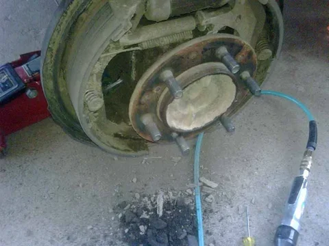

Well, this was the damage from the annual mud bath at Ralphs....
had to have the drum resurfaced and had to sand the brakes shoes to smooth them out.
I also, destroyed the threaded holes to pull the drum off, but I fixed that.
Most concerning is the clay in it., A concern I have is that it may indicate a leak:bang::bang: but so far, no leaks on the concrete.
