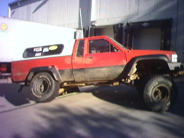

First pic from my old cameraphone

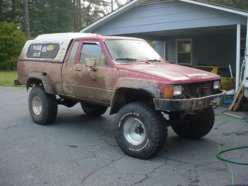

Dirty the next day.

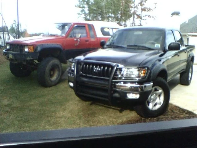

Me & my buddy's Taco... Generations together.

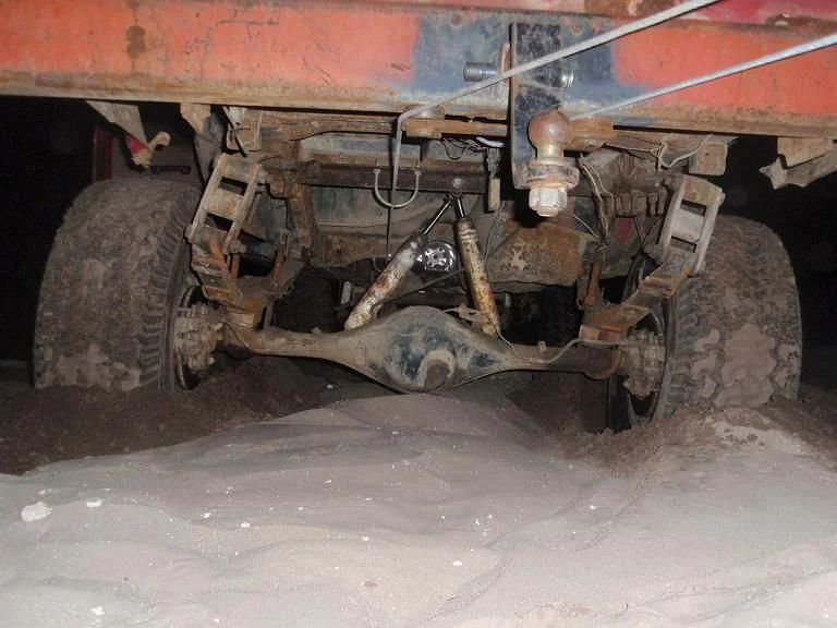

Trying to test my home built drive shaft before taking it out on the road. Buried it in 2wd on purpose and ended up breaking the darn yoke!... Oh well....

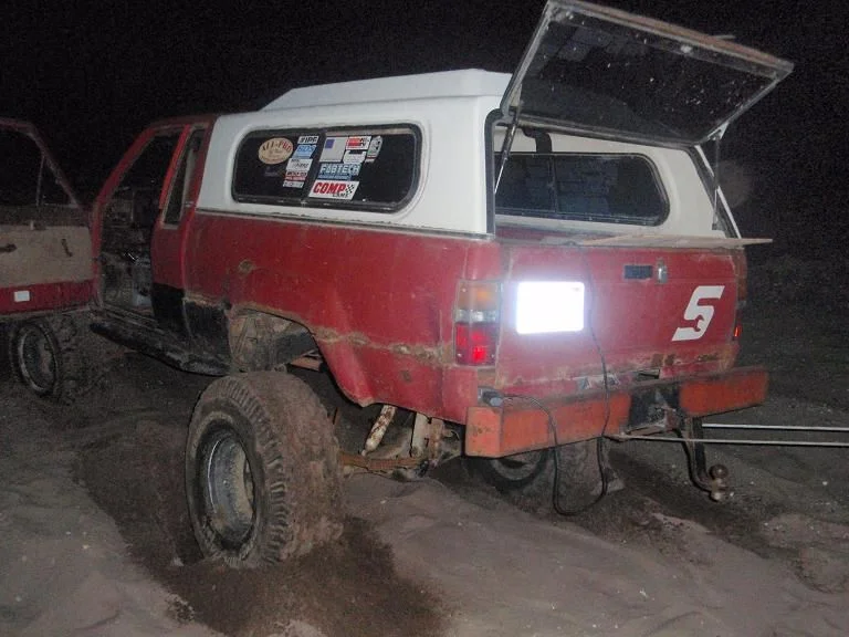

At least I got another chance to test the winch mount again.
Worked great til the cable pulled off the spool.

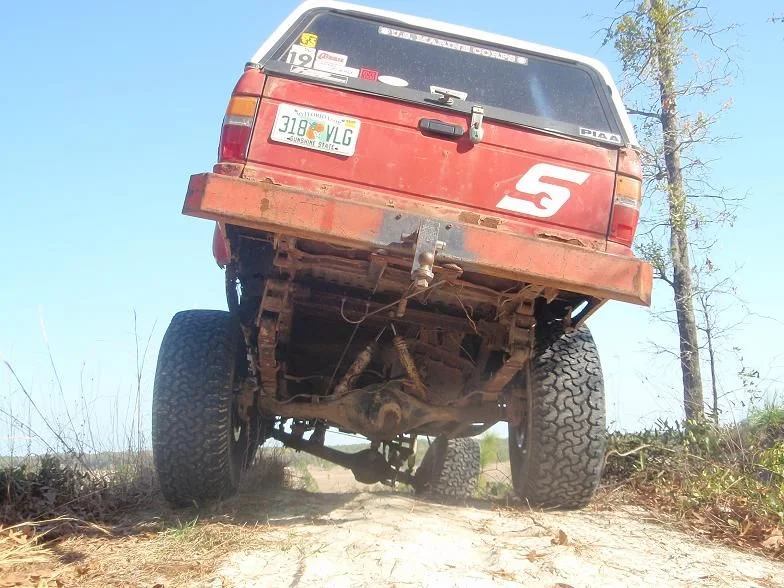

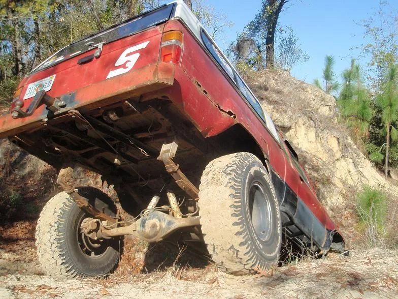

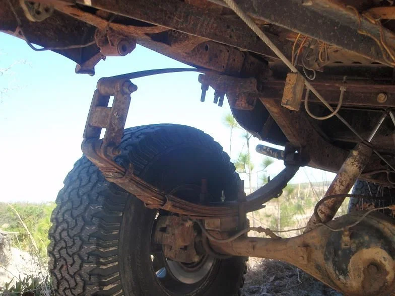

Decent pics of the rear suspension "working"

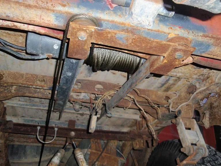

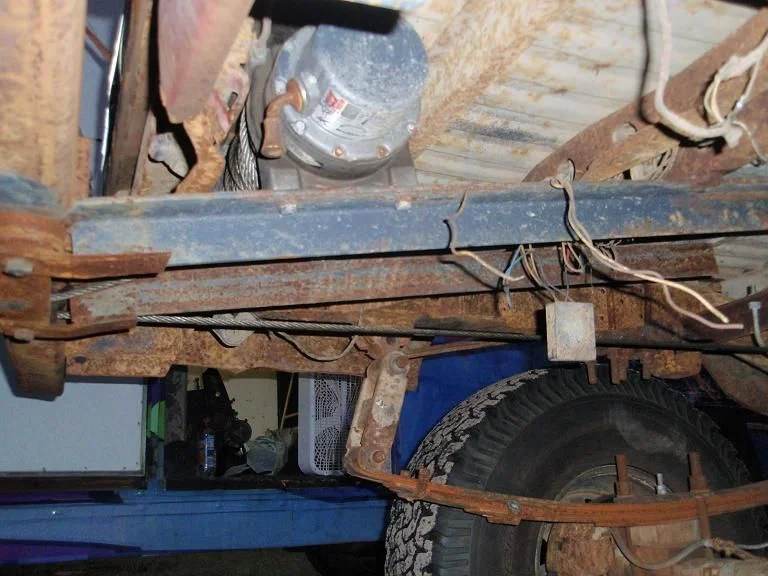

Some close ups of the rear mount and line path.

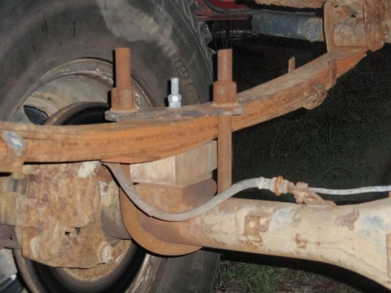

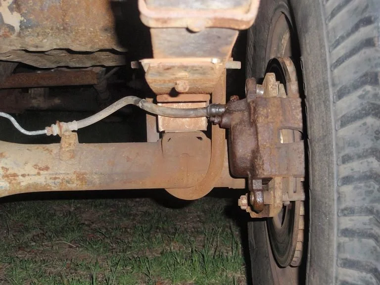

Here's close ups of the rear u-bolts I mentioned. Anyone else ever tried this? Workin great so far!

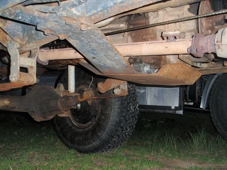

The BudBuilt x-member and the 4xInnovations trans mount.

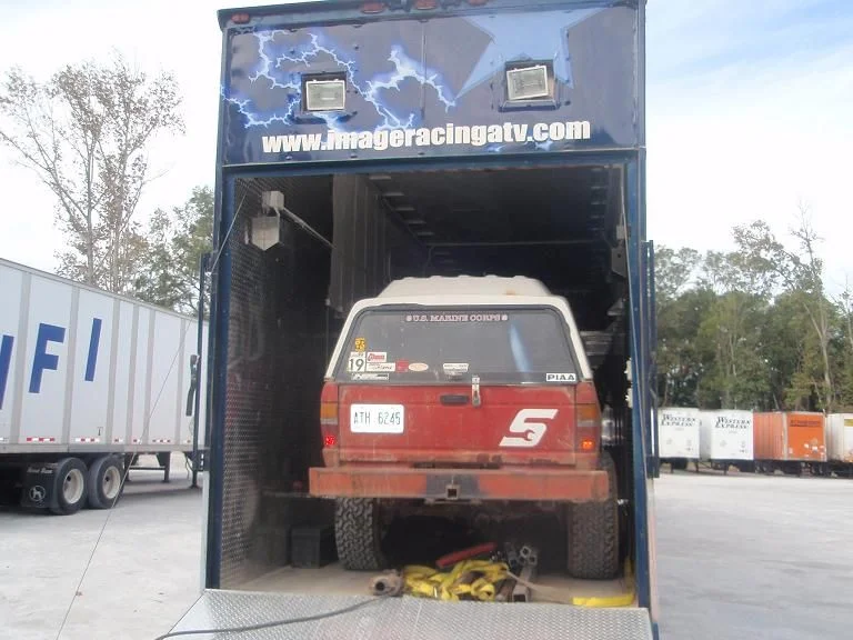

Last pic I have for now. This is my "shop" and RV since I joined the Navy so I don't have to rent or buy a place every time I get new orders and move.
P.S. - If the Marines decal has you confused, I bought it from one and decided it's always good to have them on your side, so I left it on. There's a Navy decal on the front windshield to salute my service.

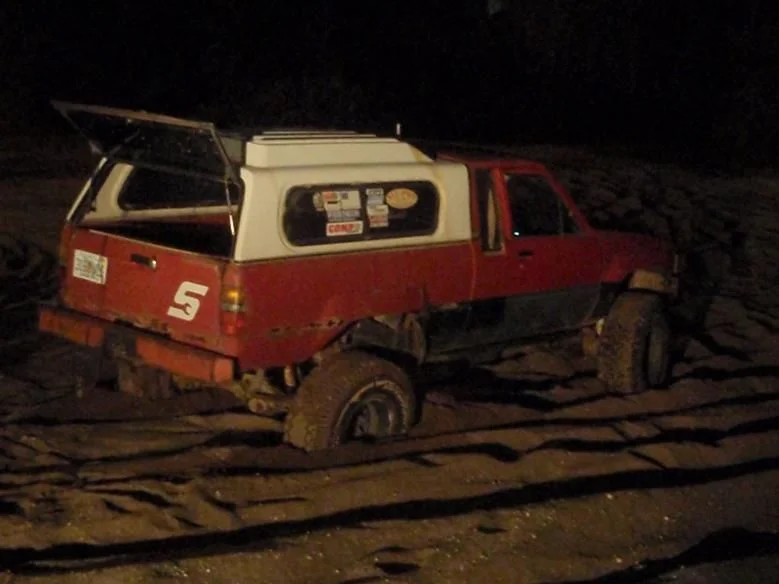

Quote:
Originally Posted by 4xsteve View Post
Attachment 344791
Tellico
Attachment 344792
Broken J-arm at the top of slickrock.
By the way, I have to thank Jack Uys for fixing the J-arm for me on that trip to Tellico. Still running strong to this day!

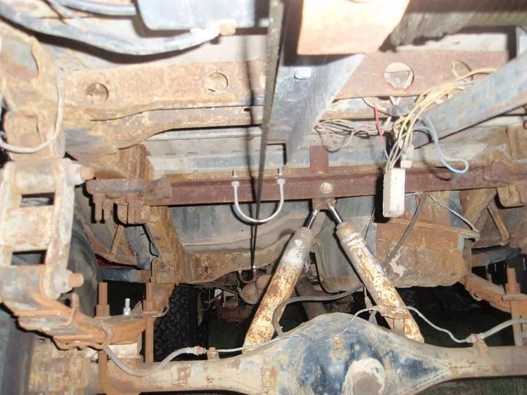

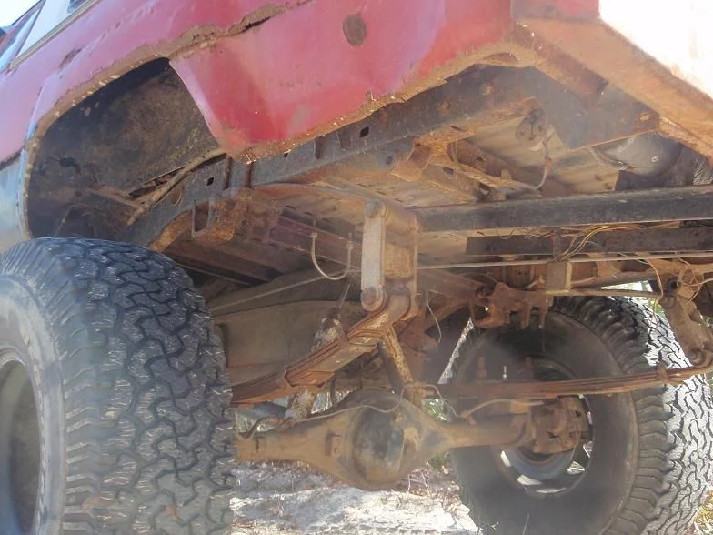

How does the rear spring set up work for ya?

Quote:
Great so far. I've heard they like to unload when going on steep descents, but I've not been on any "real" downhill trails. Probably the steepest thing I've gone down was that sand hill that's in my pics. But then again, I have a bit more weight in the back than a lot of rigs do; with the rear winch, camper top, 35" spare, chains, spare winch wire, 2 high lifts, 2nd battery, tools, and a few small odds and ends. Also, that half leaf is pretty stiff due to it coming from a 4" Toyota lift spring, and the fact that it's relatively short as 3/4 ellipticals go. I actually want to shorten it another inch or two so the rear will sit level and so the shackle will be able to swing more in both directions for a little added droop and compression. That short spring is actually the limiting factor for the rear flex at the moment. Handles wonderful on the road still too. All built out of parts I had lying around too: rear pack is leaves from 3 different sets, 1/2 leaf is from the old front lift set, the mount to the frame is the old u-bolts and axle pads, and shackles remained the same.
I'm building a quarter elip. set-up myself for my dailey driven 82 and thought I'd share an idea I'm puttng to use on mine.
Its pretty simple actually, find some channel iron that the upper (quarter elip) leaf spring will lay in, and bolt the spring through it with the channel welded to the frame. At the shackle end of the channel bore a 1/2 hole for a hitch type, quick release pin to slide through and effectively "lock out" the quarter elips.
This allows safer, steep downhills and a lot better manners on the street. I've built this setup on the back of an fj40 and the front of a K5 full size and it functions really well in the real world.
Just a thought.
