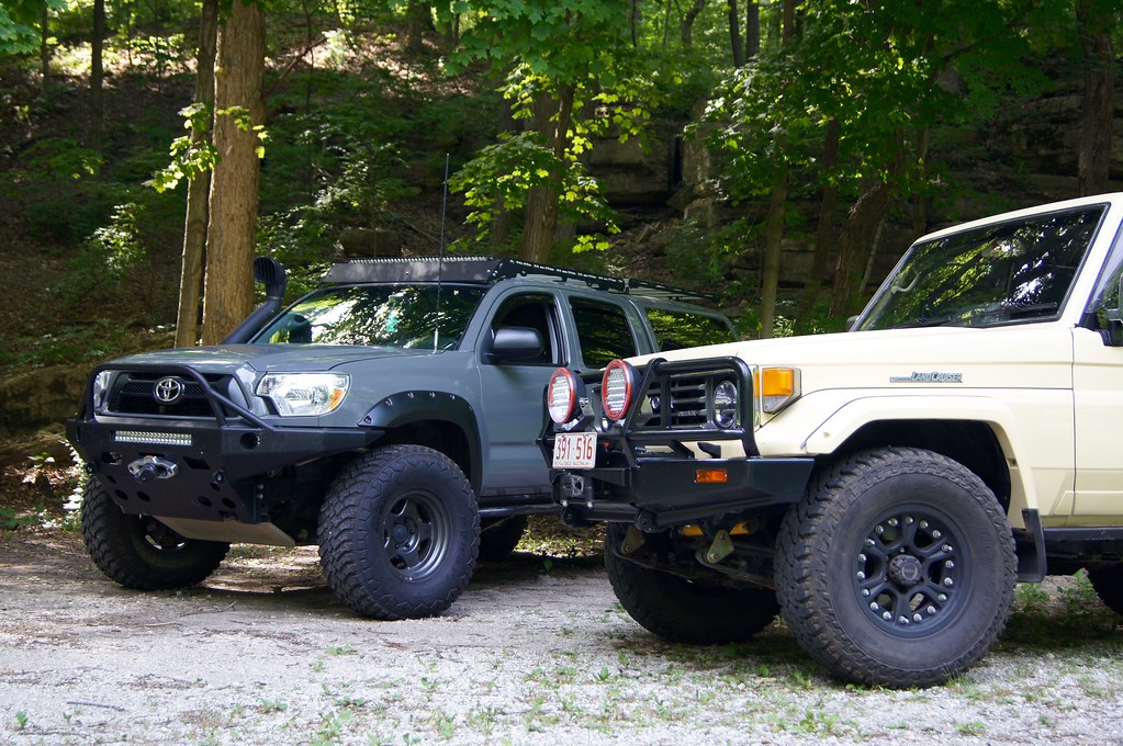

Finished the week with a trip up to Pere Marquette state park with a friend so that he could take some pictures of the 77 with a real camera. Took a few more pictures along the way back along the banks of the Mississippi river. I'll share his once he gets them to me.
