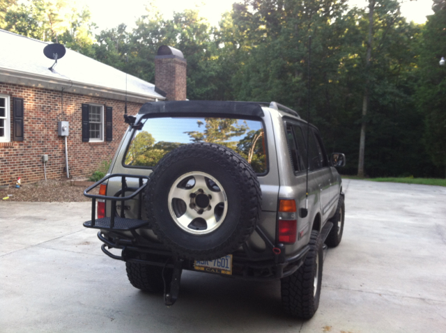

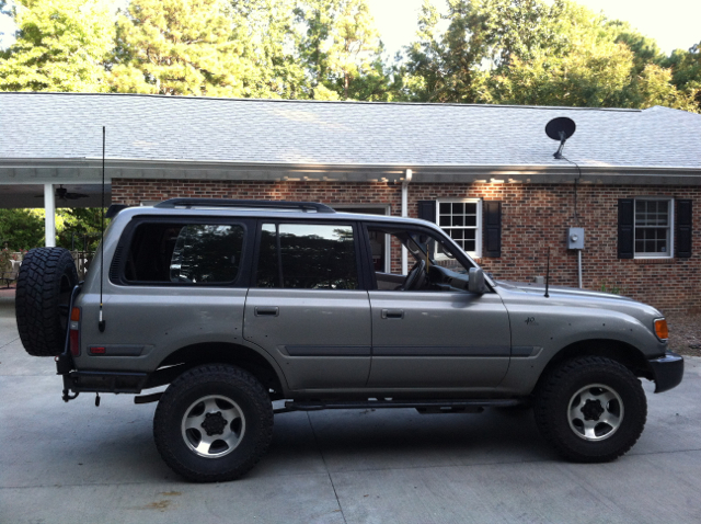

Finally got my com gear installed.
Cobra 75 WX ST
Firestik 4' NGP antenna kit
Yaesu FT-8900R Quad band transceiver
Diamond K9000TM Motorized Antenna Mount
SBB-5 Comet Dual Band 2m/440 MHz Antenna
RadioShack External Speaker

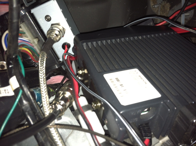

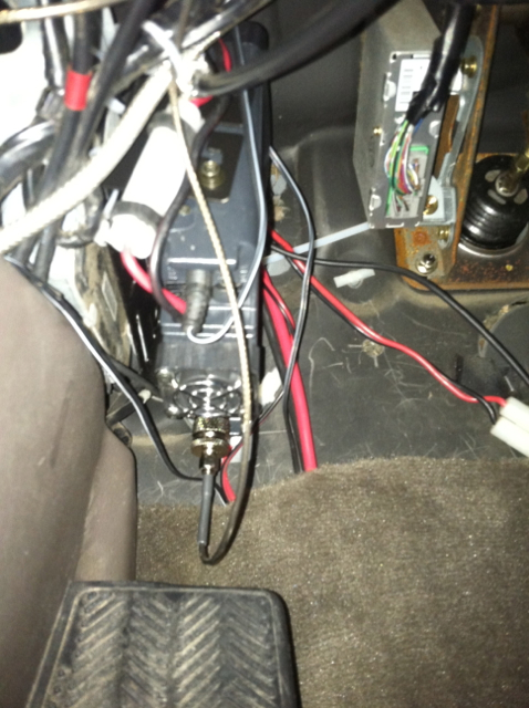

There was ample room for both radios up in the DS footwell. The CB just slid into some existing zip ties around one of the computers and the HAM radio went nicely next to it. The bracket zip-tied to some of the metal back there. The only piece I'm missing after a year of floating around my bedroom closet is the faceplate bracket. Once I find it or get a RAM mount I'll have the face mounted where the ashtray used to be.
Here you can see the footrest for reference:
The CB transceiver is the small box above and to the left of the Yaesu:

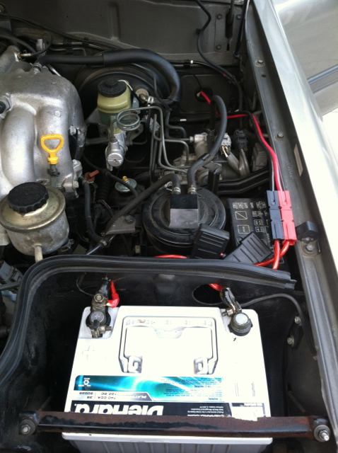

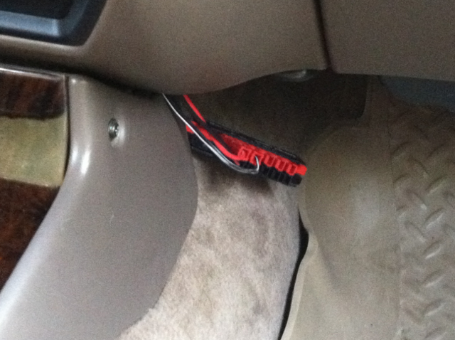

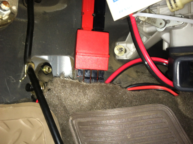

The most satisfying part is the power delivery system for the radios and any other devices I'll ever need. From my DieHard Platinum I've got 10ga cables with inline 80A fuses and powerpole connectors to two powerpole power strips in the cab. All the radios, the Diamond mount motor and a 12v outlet panel plug into these with additional ports left over for LED light strips, air compressor, inverter or anything else I can stick a powerpole connecter on.
From the battery:
Through the firewall and terminating in a powerstrip in the DS footwell:
Another powerstrip daisy-chained to the first and routed to the PS footwell:

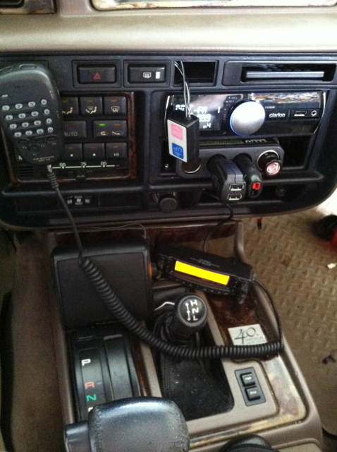

Here's the console as it is now:
Antenna "array":

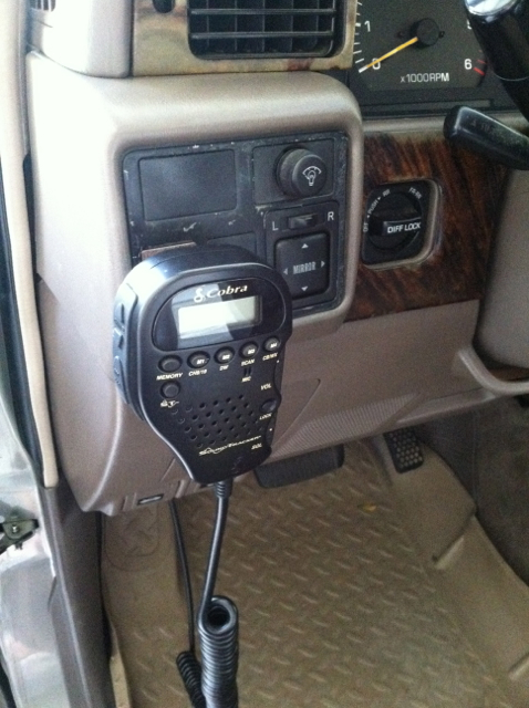

Oh... here's the CB on the left side of the driver's seat resting in the gamiviti mic holder:
It looks like it would get in the way but really doesn't.

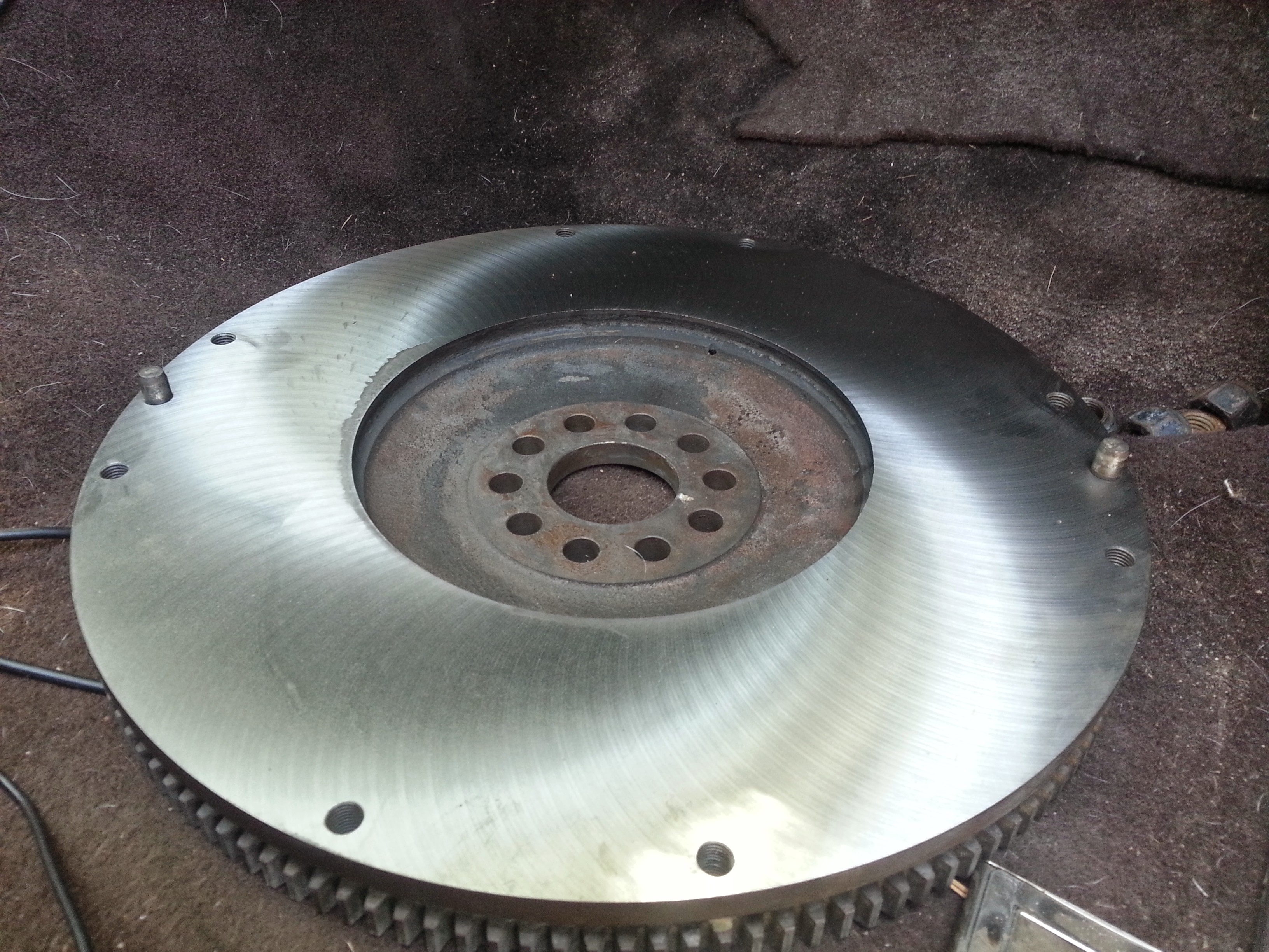

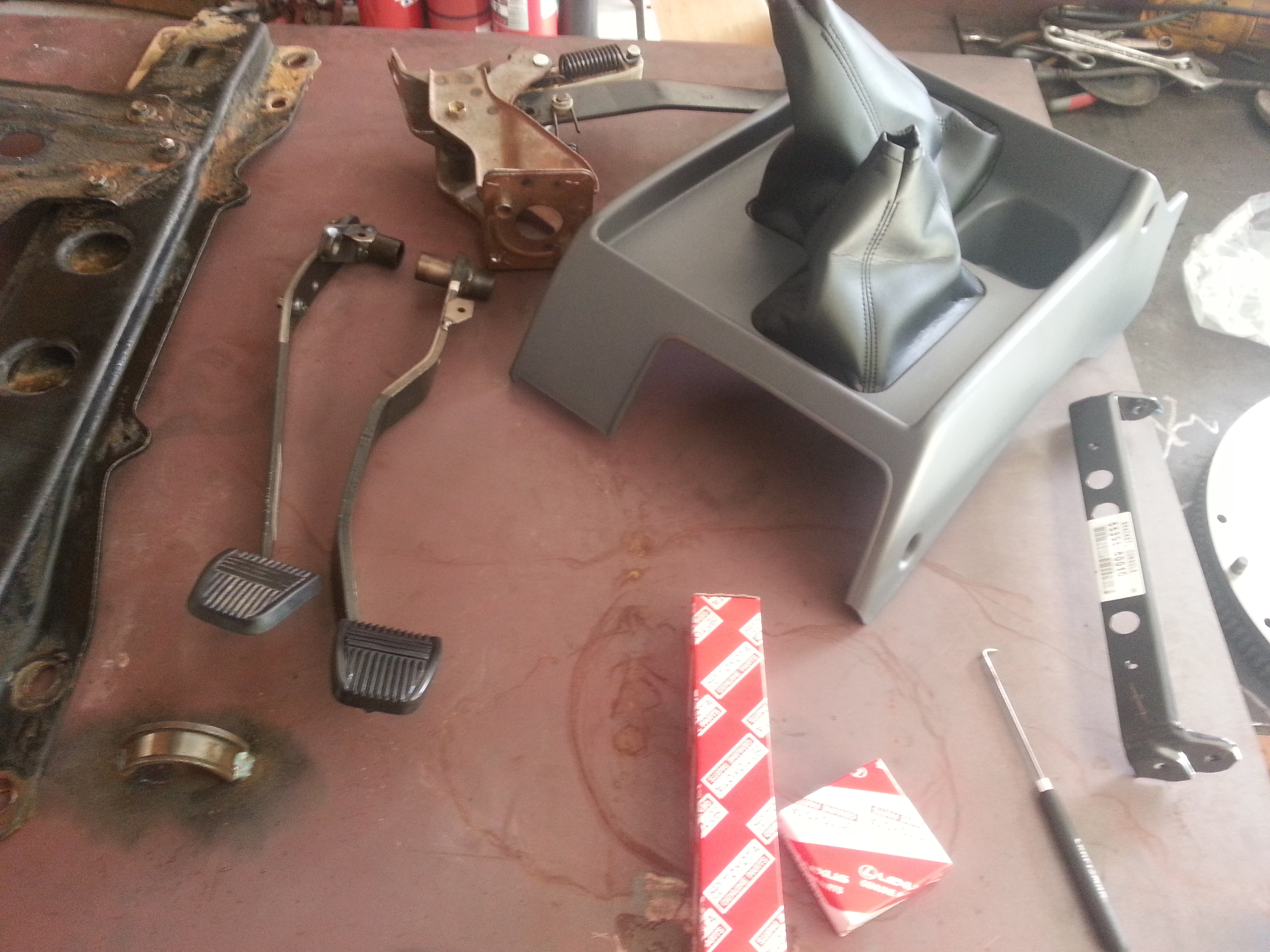

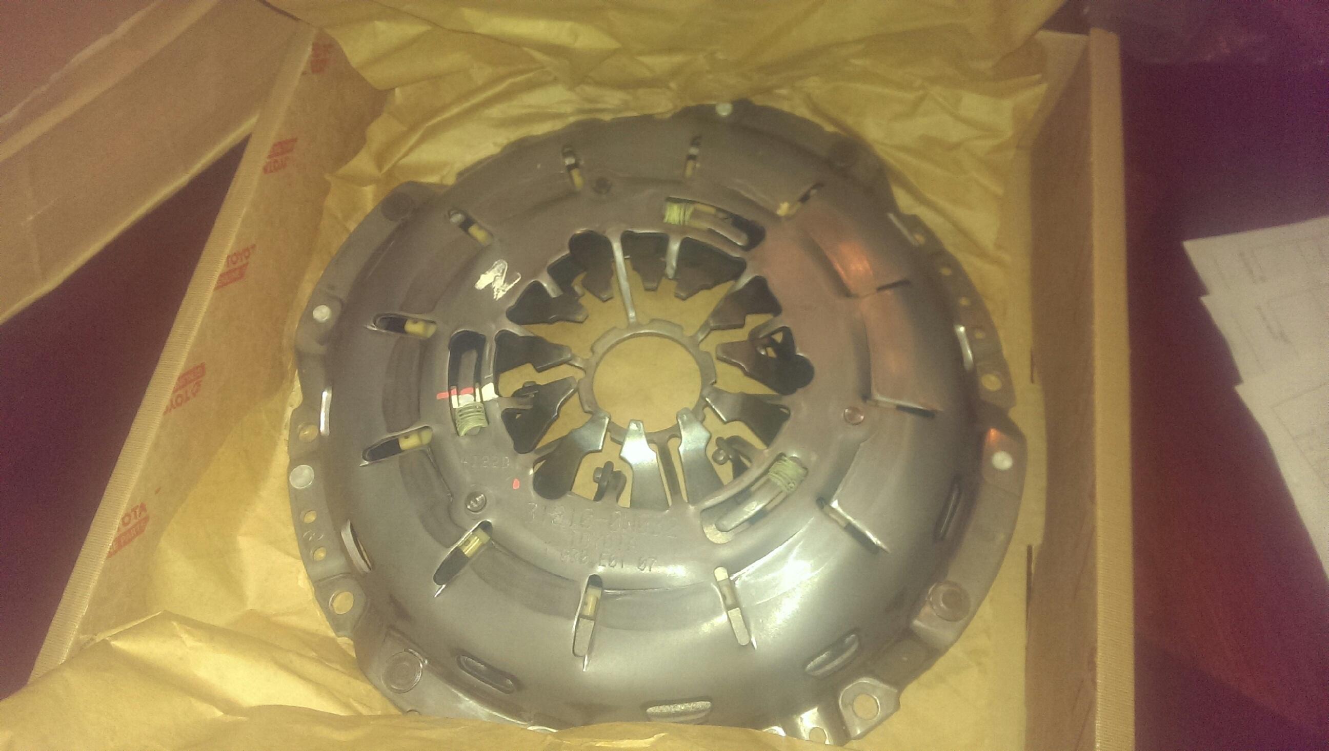

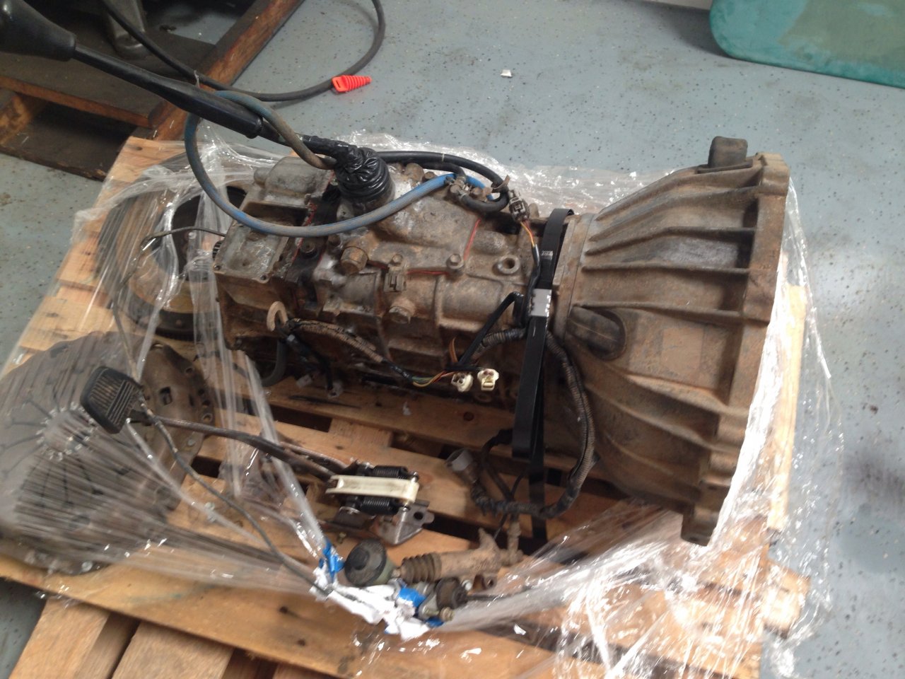

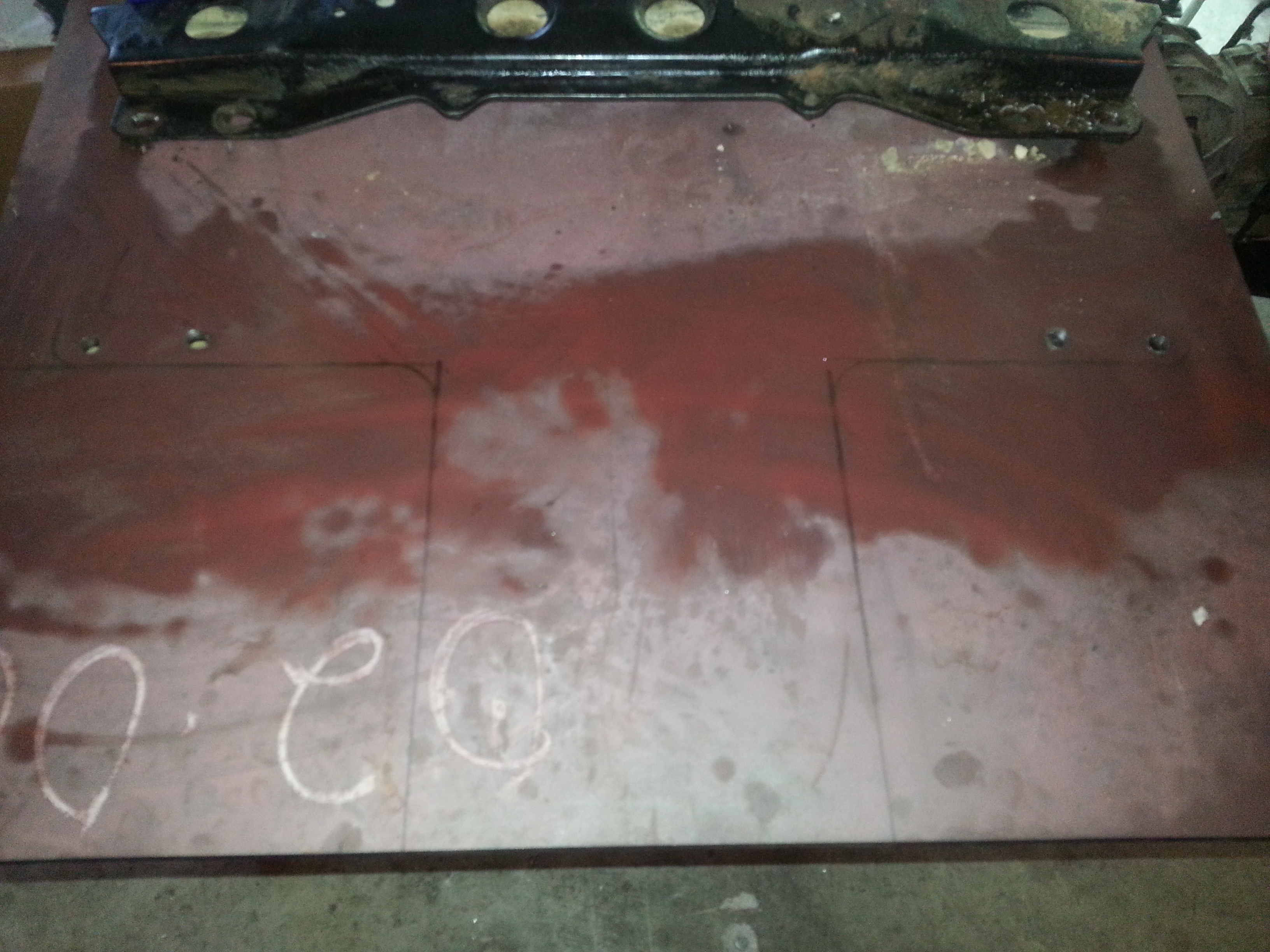

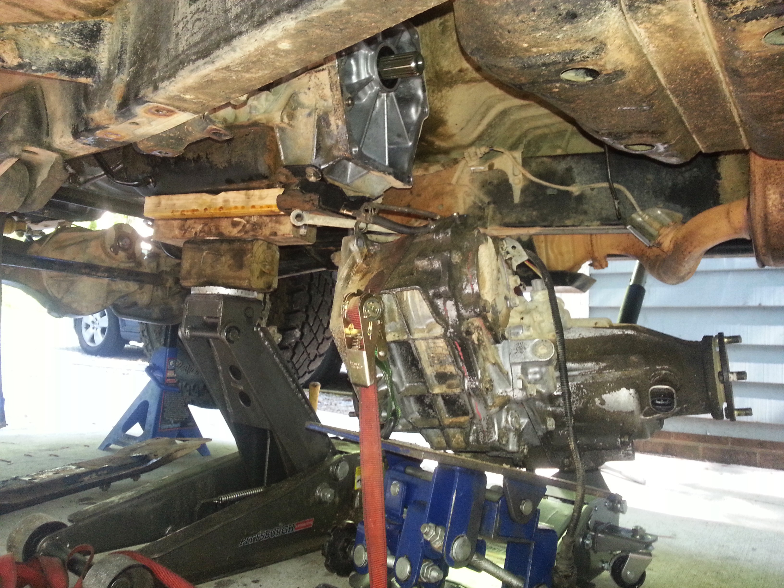

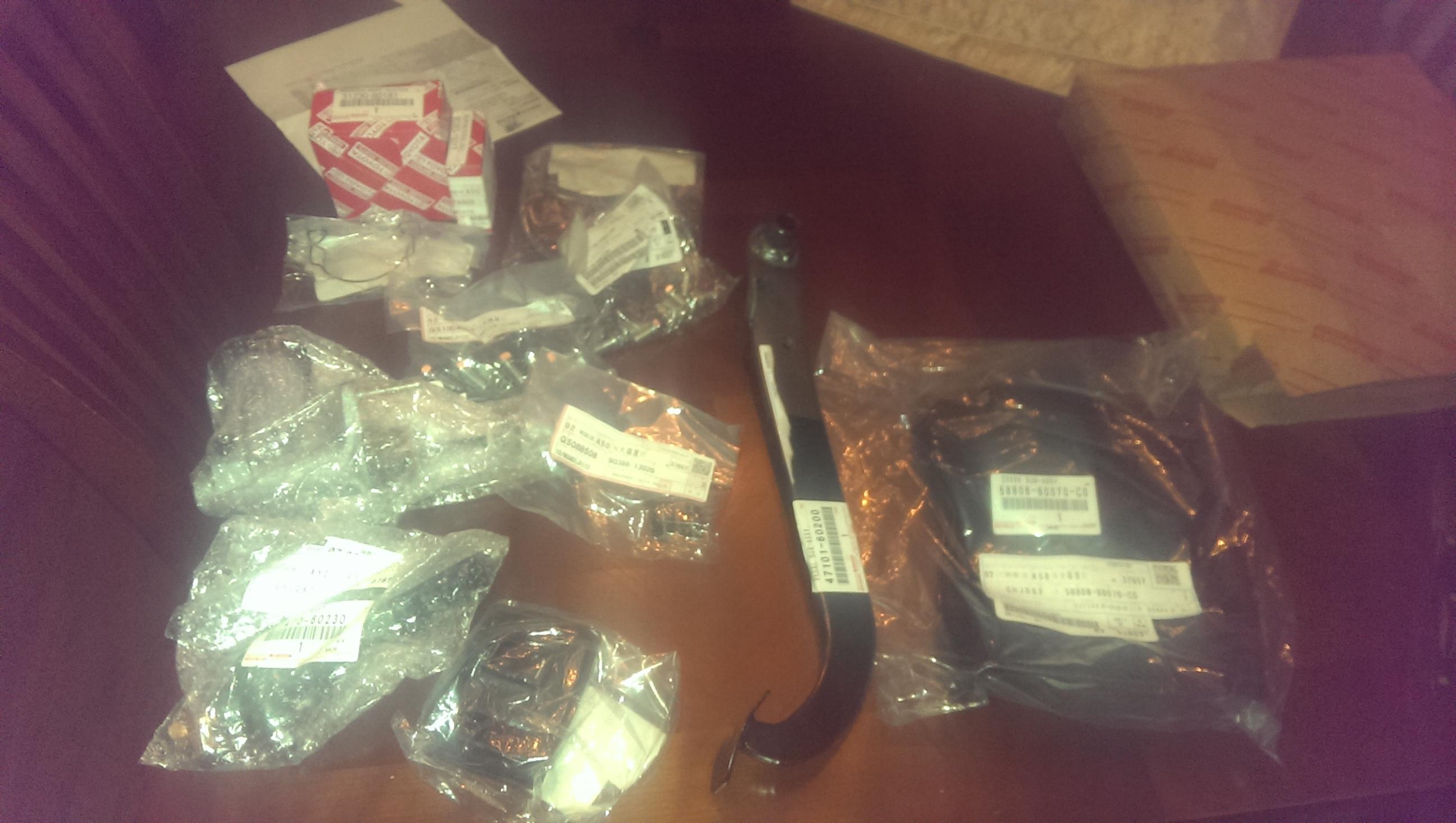

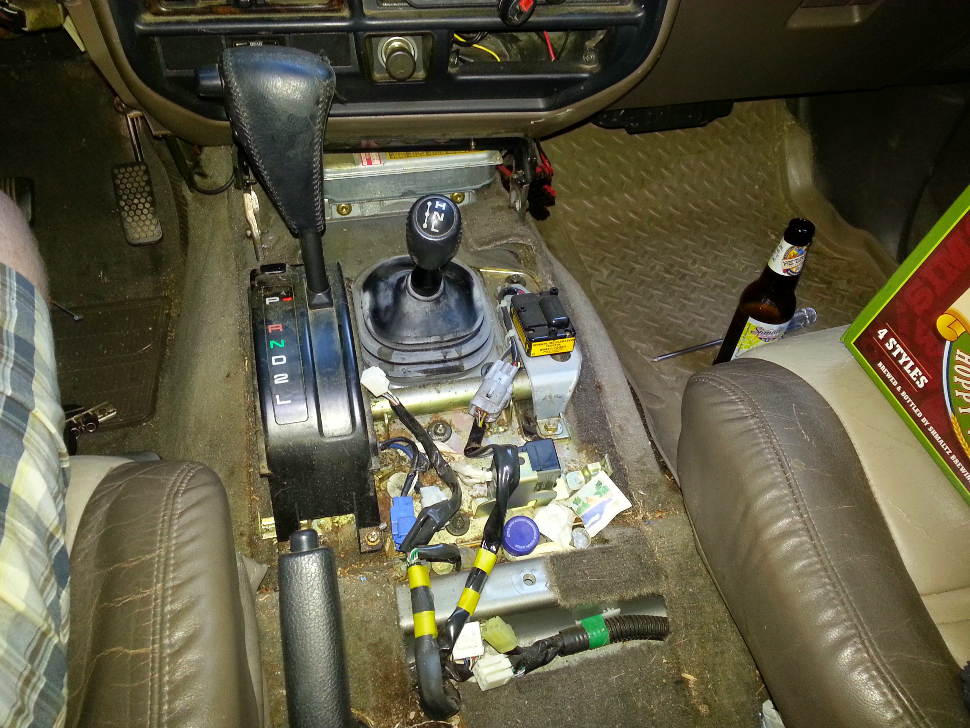

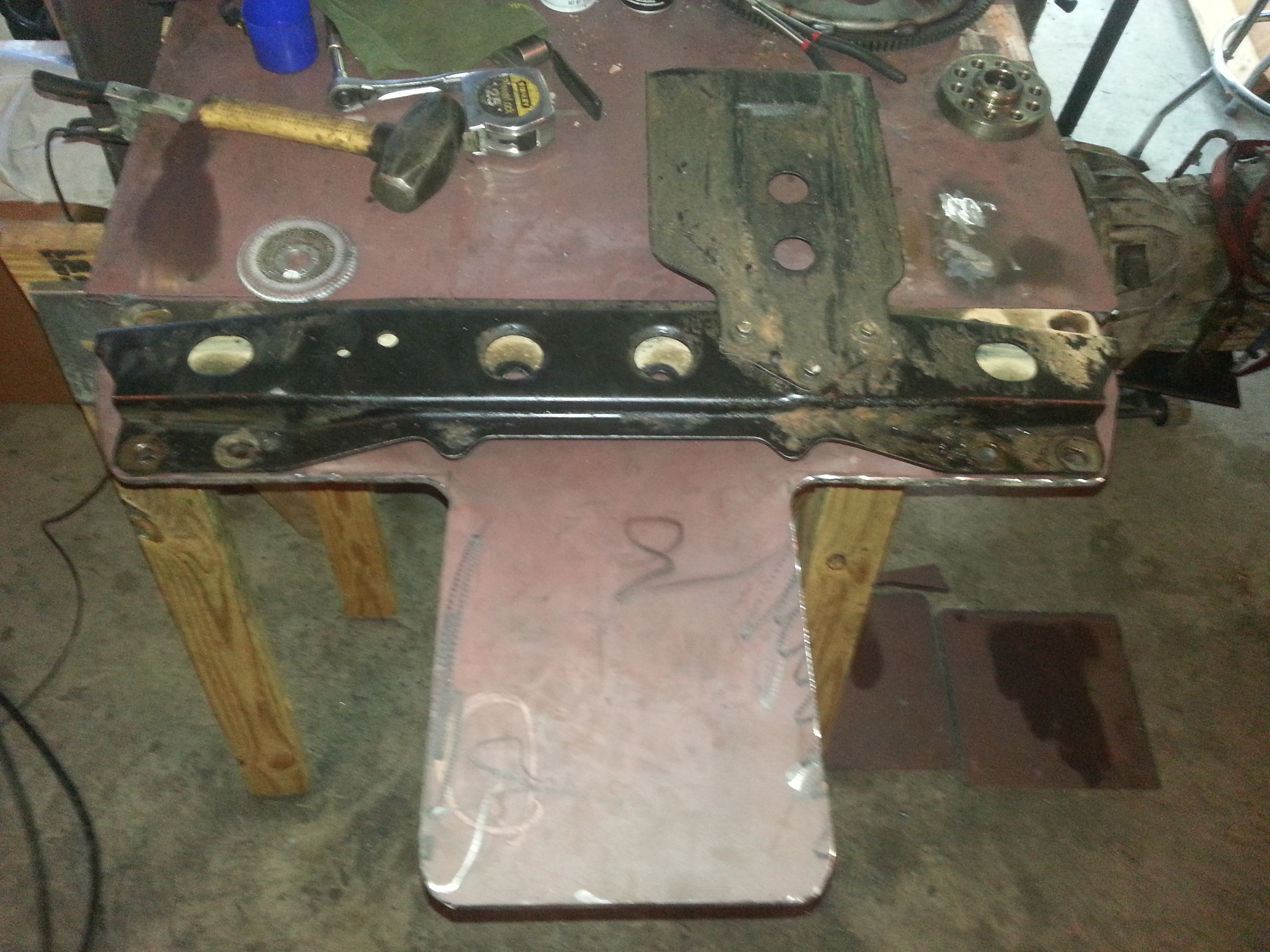

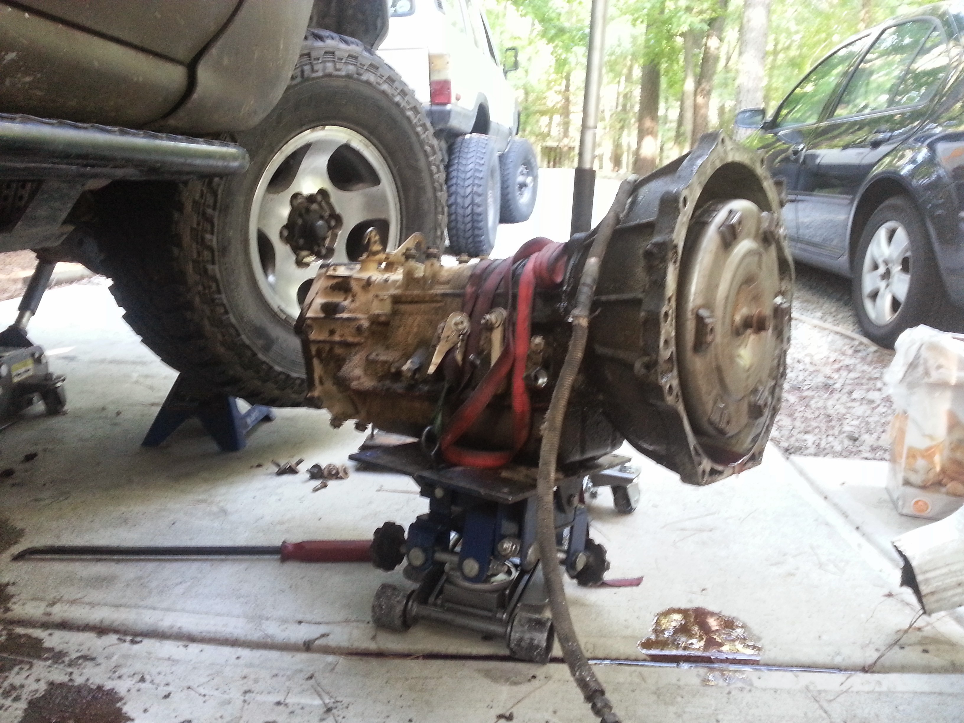

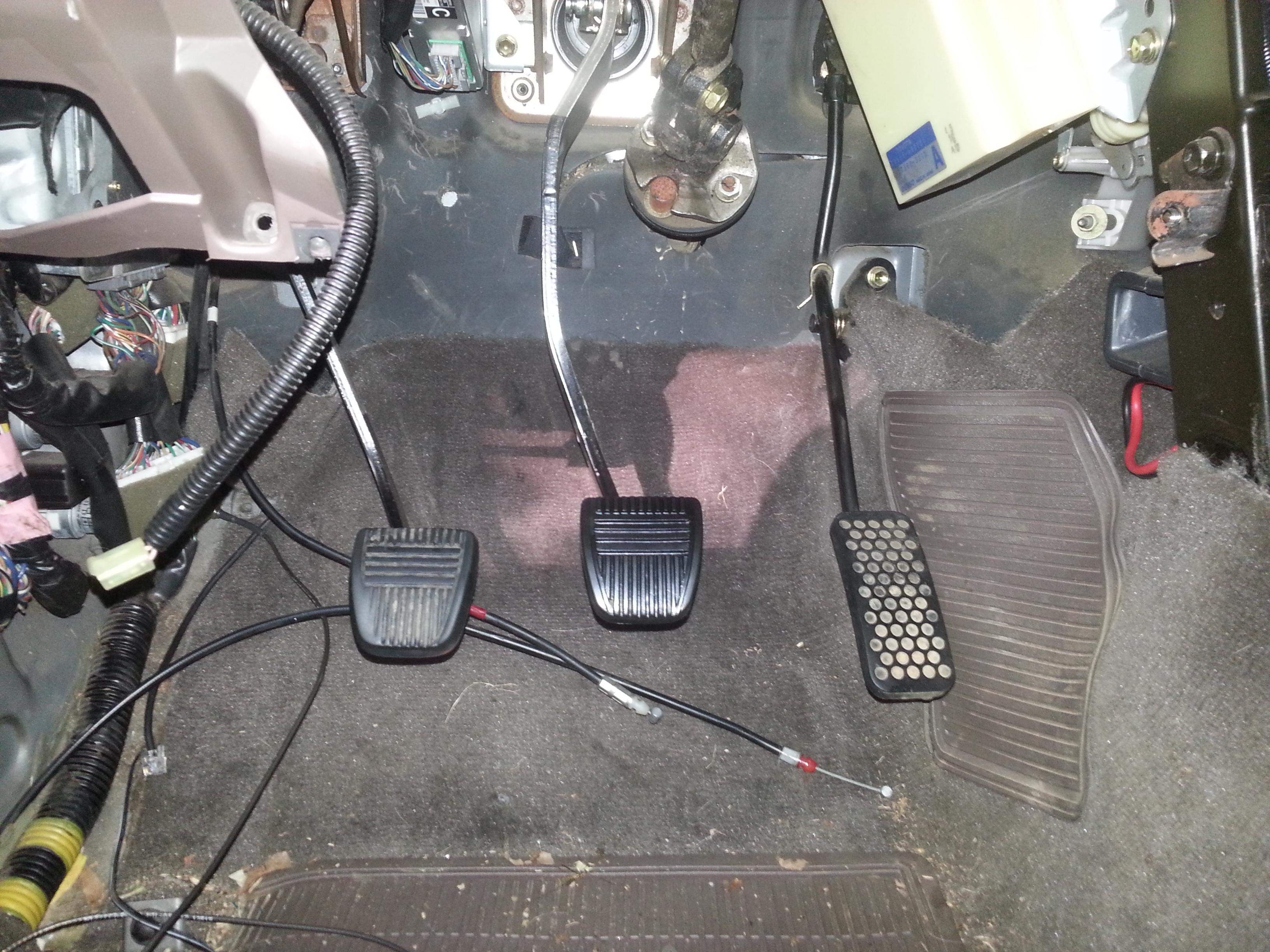

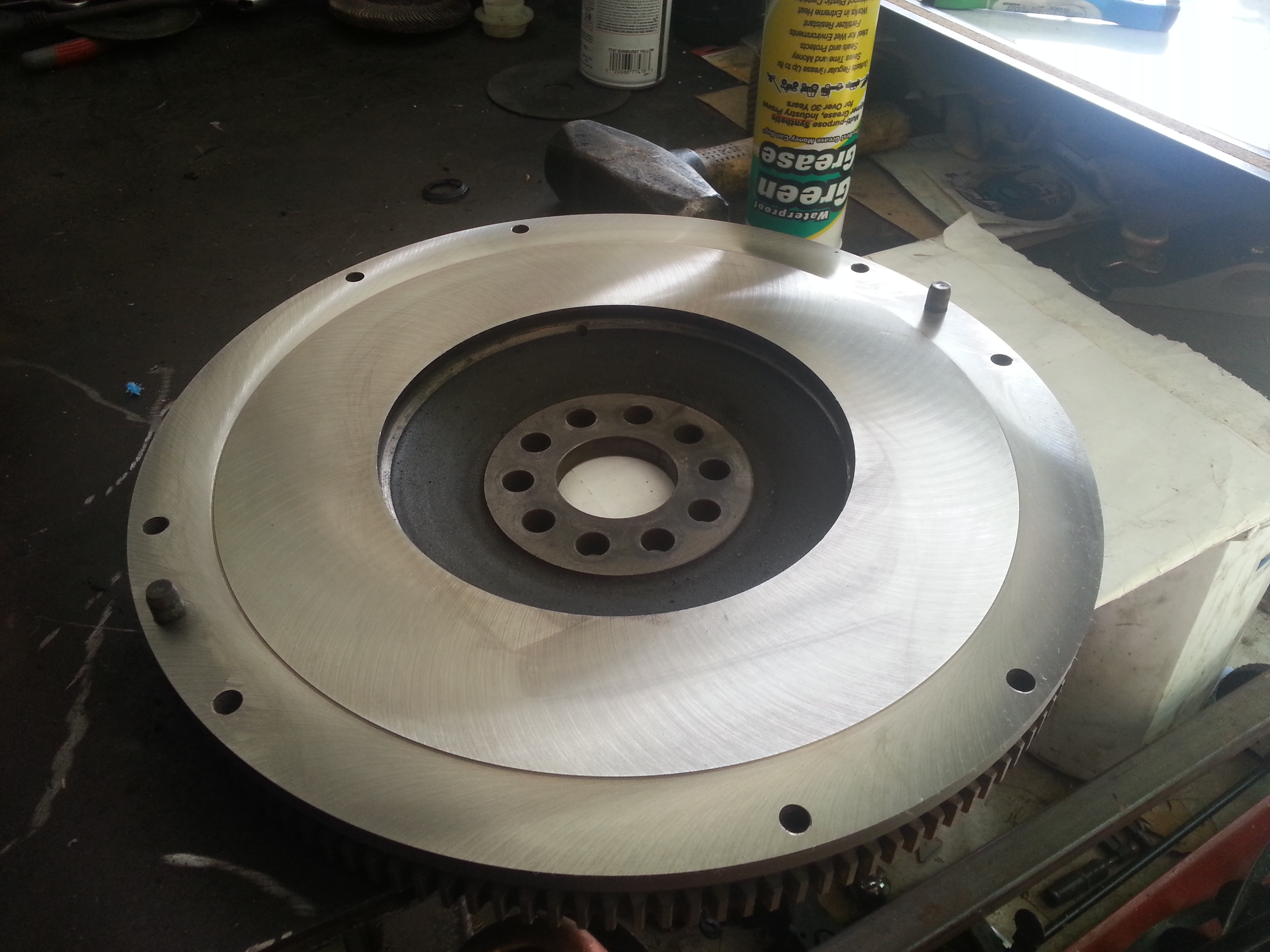

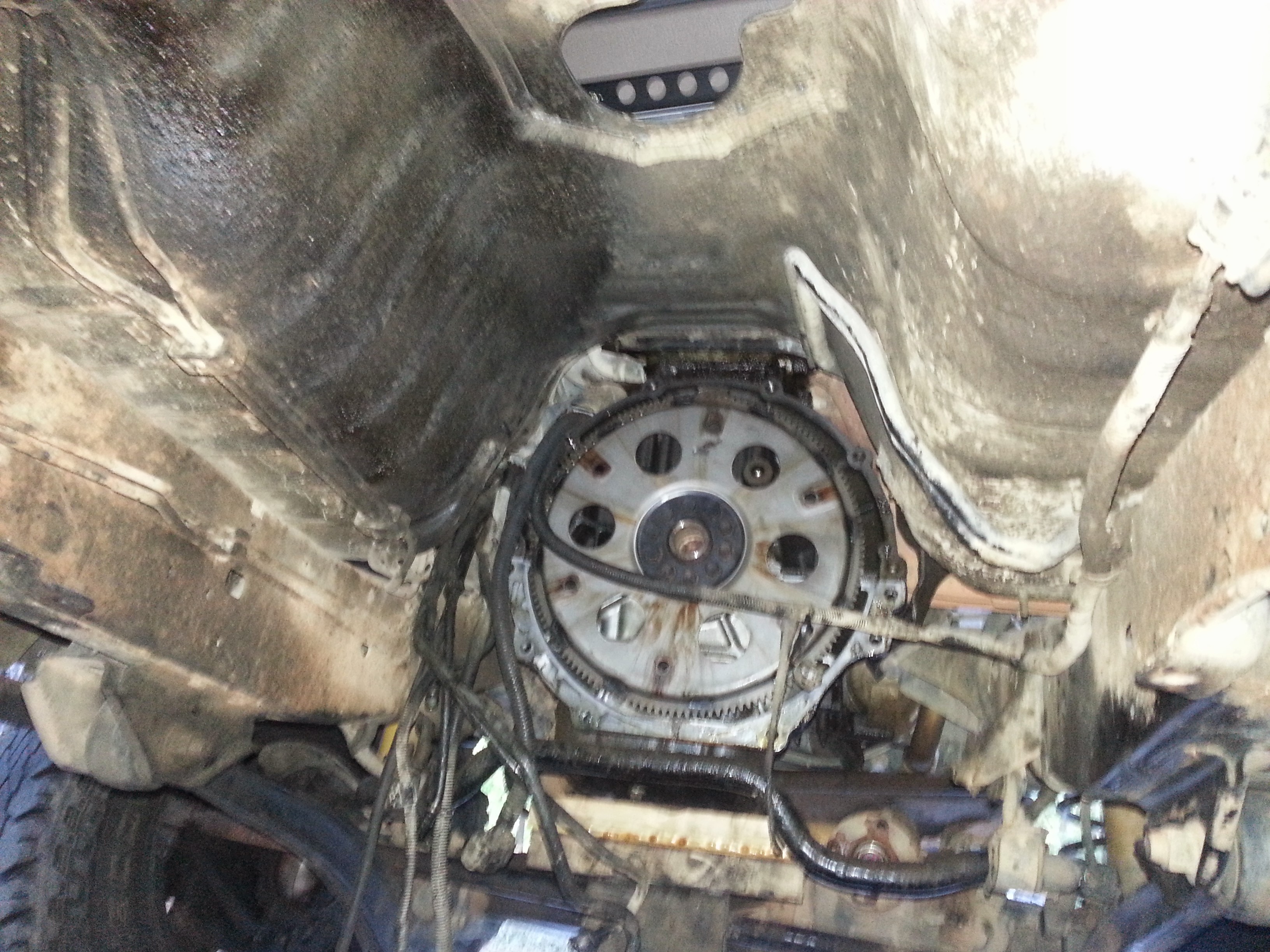

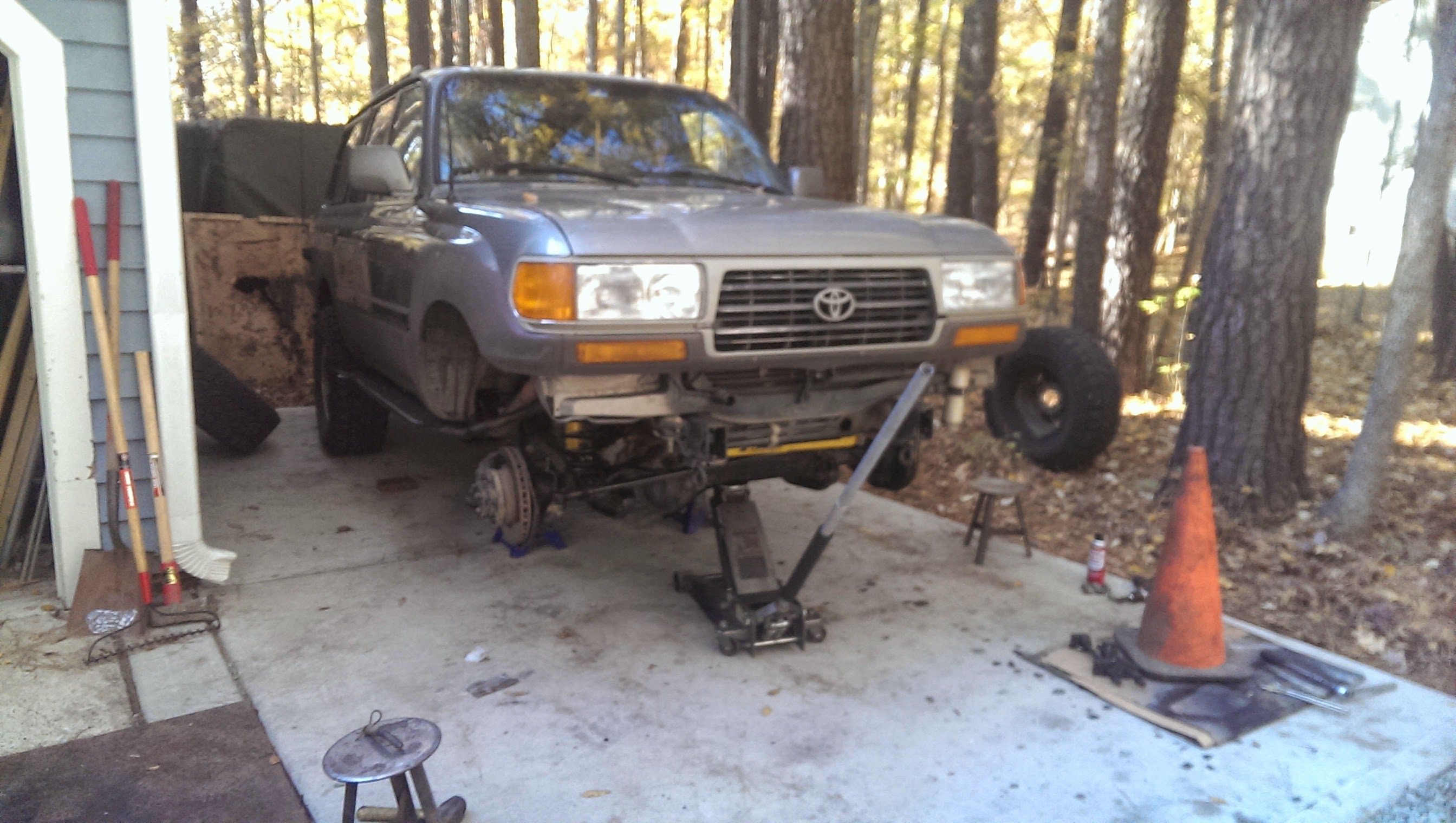

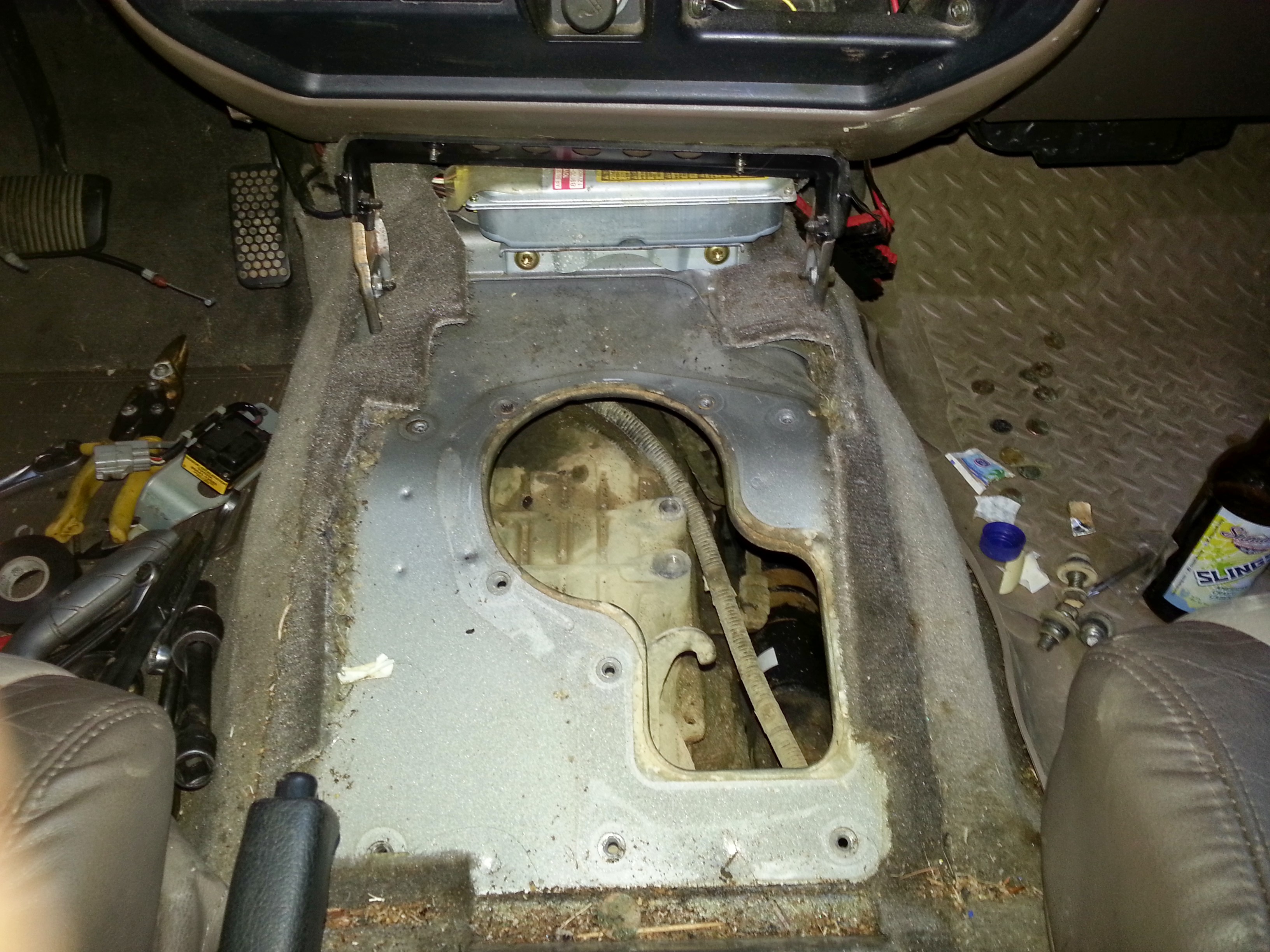

Wow... it's been a while since I updated this thread... For those who don't know, Johnny is in the process of swapping the stock A343F transmission in my 80 with a H151 manual. He's also fabbing a skid plate to protect the transmission and transfer case that will replace the existing crossmember. It's going to be badass!
These pics were taken by Johnny. I've contributed nothing to the build (besides money and enthusiasm).
Before resurfacing.
After resurfacing.
The skid plate.
Pedals.
