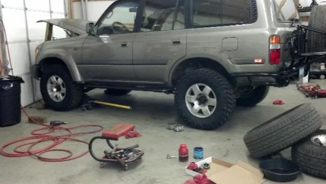

The truck is currently down at Canuck's Cruisers getting fitted with the OME lift and having the rear axle serviced. Apparently there was NO grease in the rear wheel bearings... it seems the axles are supposed to be serviced at least once every 15 years or 240K miles. :lol:
I've got my Cooper S/T-Maxx's on order and should be installed over the weekend. Here's how my 80 is looking right now riding on goofy looking 265 Michelin's:
