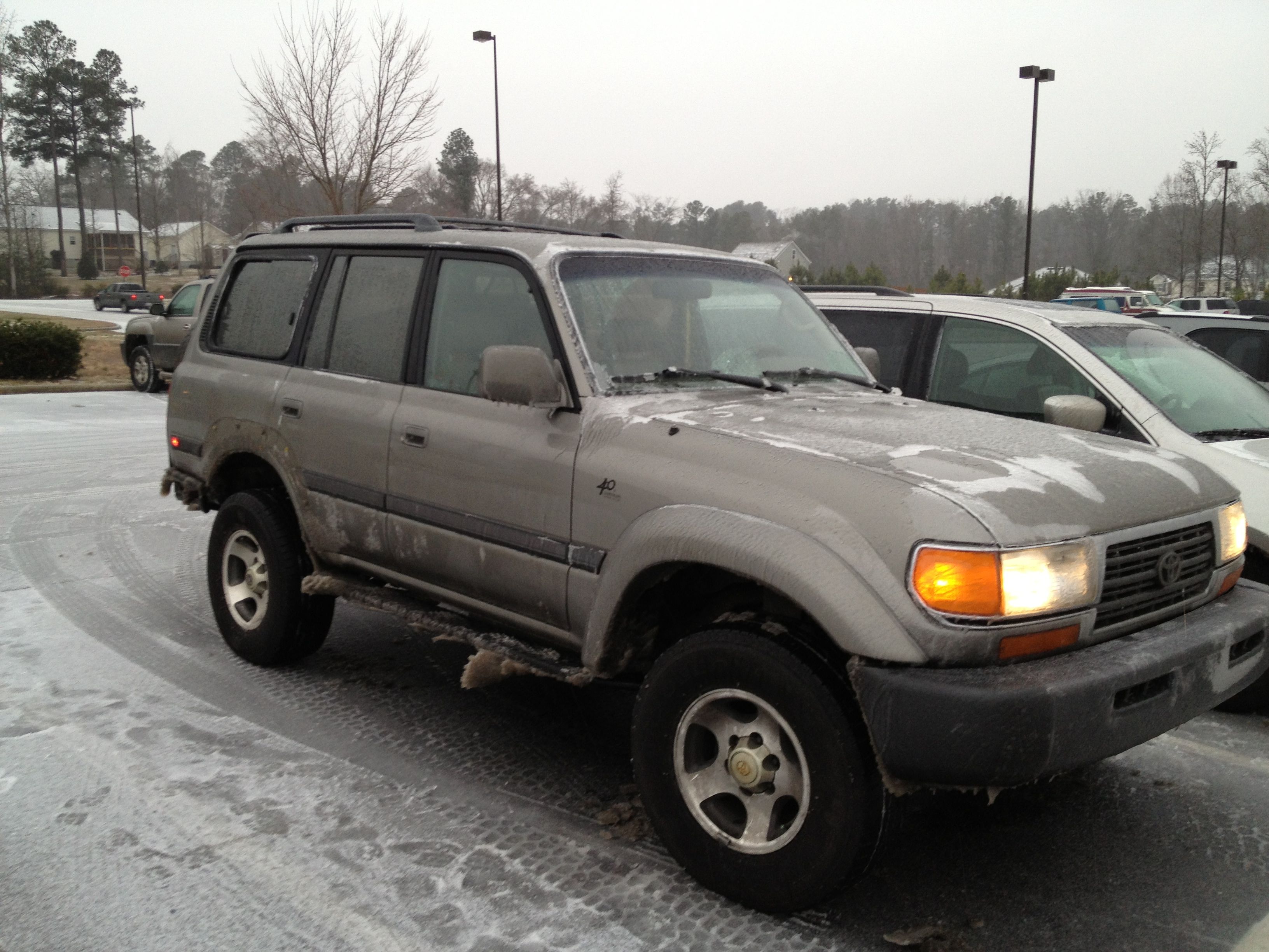

Wow... yesterday was epic. Granville county schools announced an early release so my plan to go down to Raeford with only the wife went out the window. We kept the kids out of school and headed down as early as possible in hopes of beating the storm.
We got down to Darin's at 10:00, picked up the truck and hit Fayetteville for a quick lunch. We were back on the freeway by about 12:30. As soon as we hit highway 40 traffic slowed to a crawl. The roads were completely iced over and the shoulders were littered with accidents... it was like Godzilla had waded through and just started kicking vehicles everywhere. Three and a half hours later we finally drove into Creedmoor. Here's a pic of the truck in the parking lot at the grocery store:
When we finally got to our driveway I saw that the entire length was a single sheet of ice. Our driveway is 1/5 of a mile of asphalt up a very steep grade. Here's a pic taken a few months ago:
I knew there was no way my wife's Odyssey was going to make it up that hill. We switched vehicles and I had her take the kids up to the house in the Land Cruiser. It walked right up without a problem. I made a valiant but brief effort to get the van up but it was just spinning its wheels. I parked it at the bottom of the hill and left it.
Long story... still long, all the doubts my wife has had since I got the Land Cruiser were put to rest. She realized yesterday that without this vehicle we'd be stranded on top of our hill, way out in the country without any transportation. Overall, the cost of fixing the truck up (plus upgrades) is nothing compared to the cost of a newer 4x4 big enough to haul the whole family. Now I have a badass truck that my wife is enthusiastic about. Priceless.:cheers:
