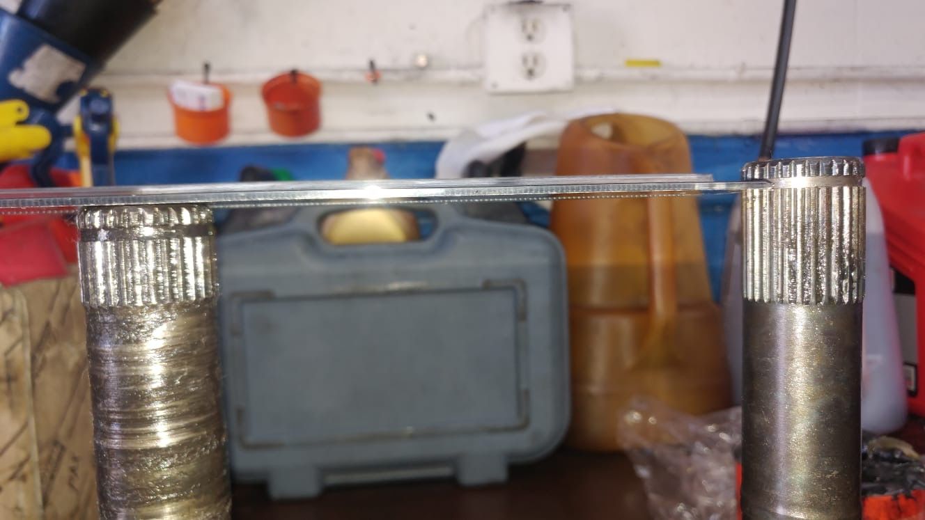

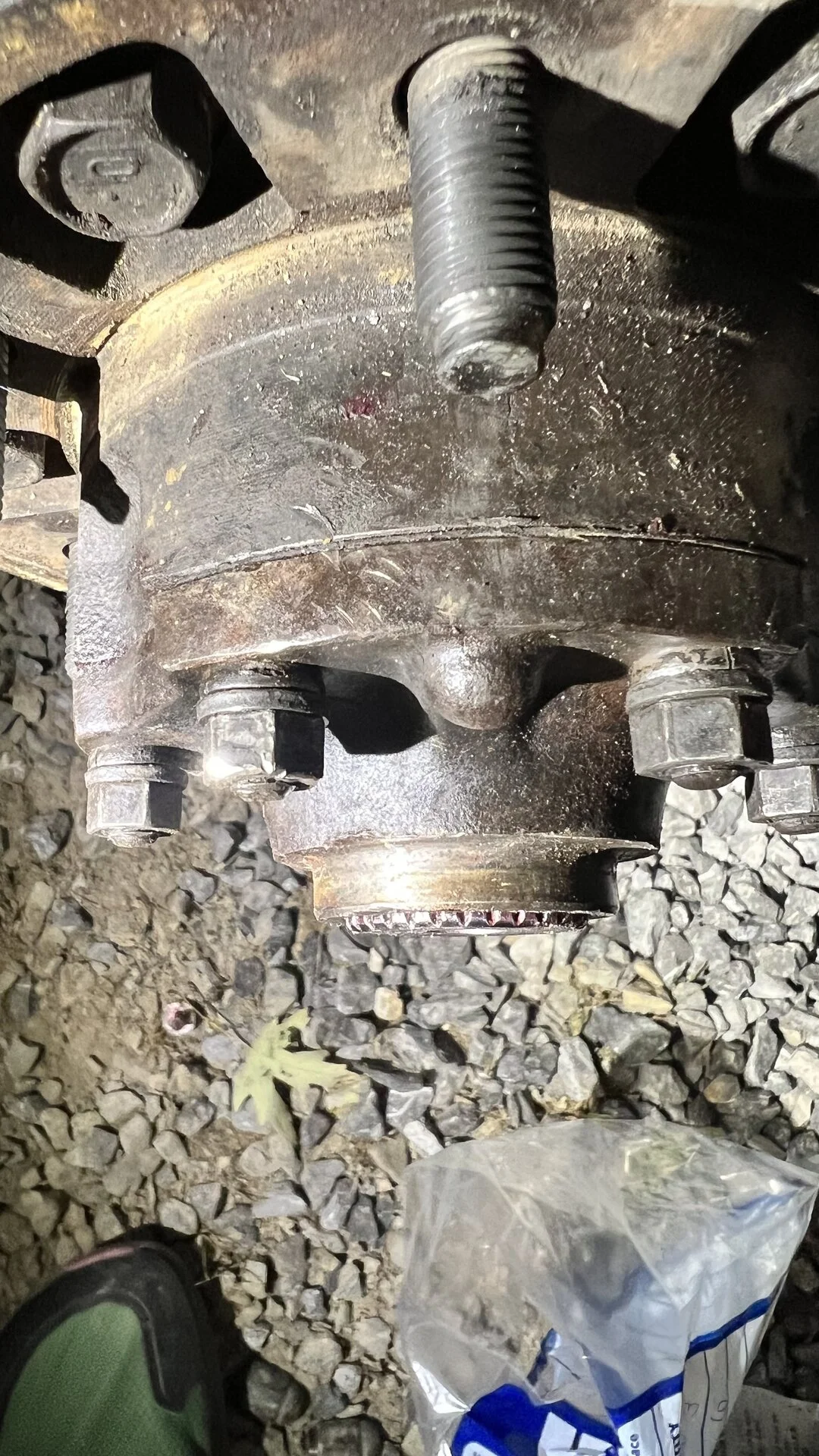

Hey everyone
I’ve been helping a friend repair a broken birfield on his 1994 land cruiser. I’m new to working on solid axle Toyotas coming from a ACVW background I’ve been learning a lot but this is my first time doing a birfield. I’ve gotten everything buttoned up but I went to put the outer c clip on and I could not get the groove visible enough to actually put the clip on. Tried threading in a M8x1.25 bolt and pulling with vice grips and could not get it to come out, also have tried moving the wheels left/right and driving the truck back and forth to see if it would walk out and had no luck. I’ve disassembled everything numerous times to make sure everything was seated correctly and was put together in the right order referencing various forum posts and YT videos and could not find any issues or reasons to why this issue is occurring. Currently wondering if the new birf is too short, Any help from someone more experienced would be so greatly appreciated, thanks!

Looks like a late model drive flange on an early model axle.

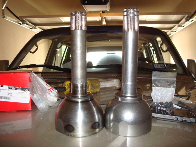

This last photo compares the length of an earlier Birfield (shorter) compared to the later longer style (note: the OEM Birfields do not come with two grooves, that's a modification to allow the use of AISIN Free Wheel hubs)

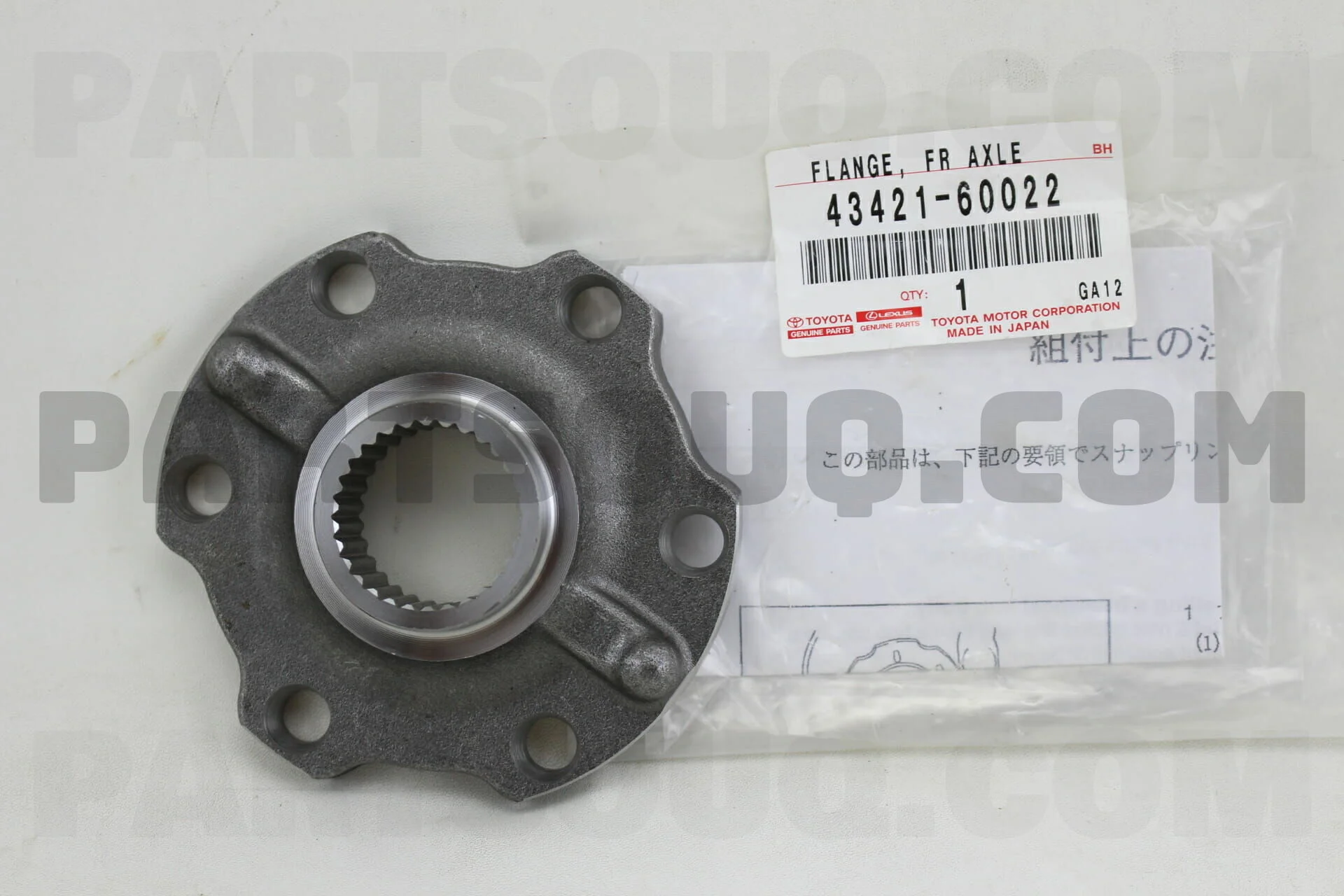

Does anyone have a depth measurement of the two flanges handy? I'd like to pick up a couple of trail spares, but want to verify I'm getting the right ones. 43421-60022 comes up as fitting 91-94, but I'd like to verify before ordering. The PO had RCVs put on at Slee, so they may not be original drive flanges for my year.
