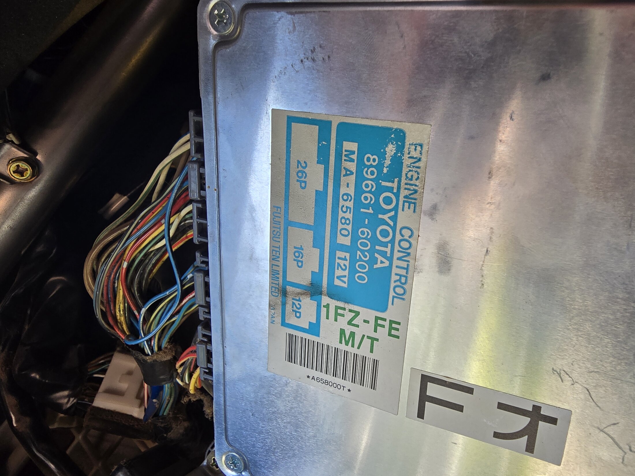

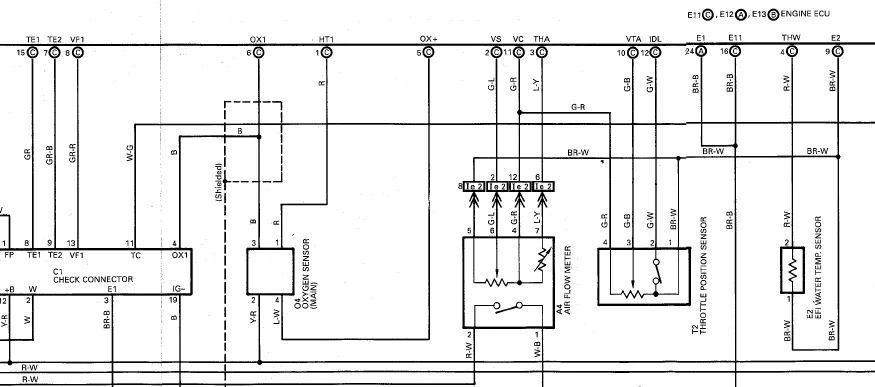

The reason I am chasing a wiring diagram so specific is because the wiring diagram I've been using doesn't seem to be correct as I have found a discrepancy between what the 1994 wiring diagram says and what is on my plug for the ECU. Please refer to the photos attached for what I'm talking about.
So, the middle ECU plug, from right to left starts at pin number 09 and finishes on 16.
Pin 10 (VTA) is a green wire with a black trace (correct as per the photo and wiring diagram)
Pin 11 (IDL) is a green wire with a red trace (incorrect as per the photo and wiring diagram)
Pin 12 is a green wire with a white trace as per the photo.
As you can clearly see, pin 11 is green with a red trace (VC) on the ECU but as per the wiring diagram this is incorrect.
After doing continuity tests, I have confirmed the pins on the TPS are in fact correct and correspond with their colours, however their wiring to the ECU has completely thrown me off.
Thoughts on this? Surely it's something I've missed right?

I don't know why it is G-R and not G-W on pin 11, connector E 9. Perhaps there is an early or late 1993 EWD, or an addendum. What is the build month/year?
I mean true, but would be nice to have the correct diagram too. 😅
04/1993 according to the plate in the engine bay.
How many connectors does your ECU have? 3 or 4?
G-R on pin 11 matches an early 1FZ-FE ECU. It is for VC though.

Its a 3 pin connector, please refer the photo attached.
You're more than likely correct about the worn out wiring, hence the need for the correct wiring diagram so I can check voltage drop, continuity and shorts.

The 1993 EWD I was looking at shows a 4 connector 1FZ-FE ECU as well as the 1994 EWD you are looking at.
Need to find a EWD with 1992/1993 1FZ-FE with 3 connectors. I am guessing that 1FZ-FE with manual transmissions will have 3 connectors, not 4.
In the resource section here, there is a 1992 70 series with the 1FZ-FE with 3 connectors.

Update on previous post, those service manuals still aren't matching what I have in my car

Update on the link i posted earlier, those service manuals still aren't matching what I have in my car.
The 70 series diagram seems to be the closest so far.
