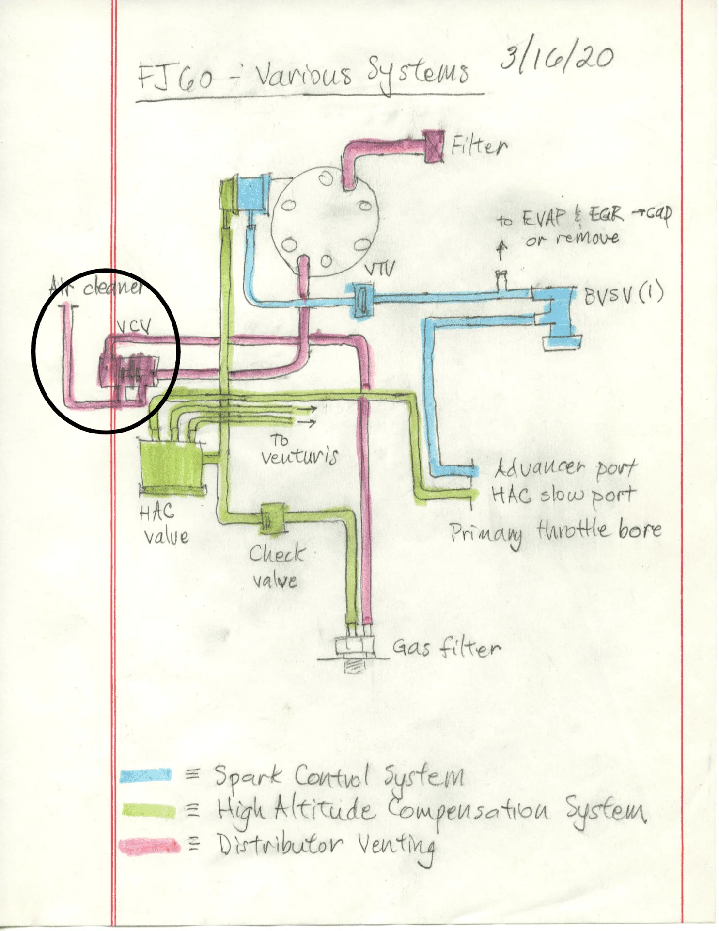

I recently drew up this sketch for vacuum advance, distributor venting, and high altitude compensation. Not sure if it's 100%, but it's taken from the emissions manual sections on those systems.
Love the diagram...so much easier to read than any of the other ones I have seen.
I don't think I have my advancer port line routed through a BVSV...I think it goes straight to the distributor. THe BVSV would limit the amount of advance based on engine temperature...so maybe thats correct? me not know.
