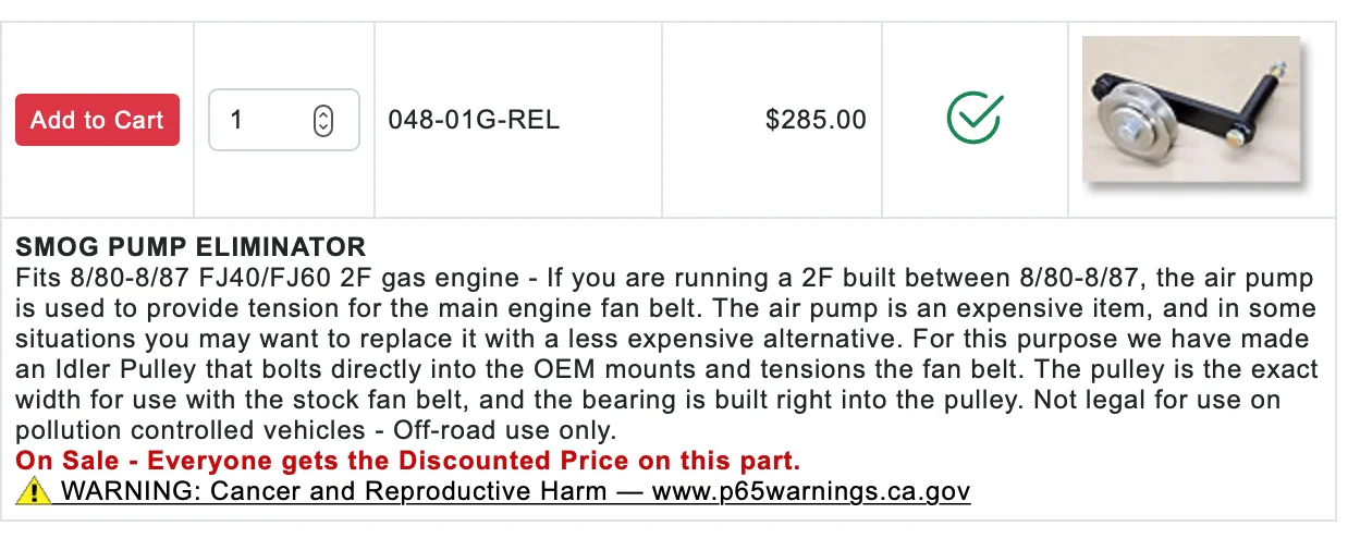

Specter Off-Road has one.
I got mine from them a loooooong time ago. It was still fine and tight after 220,000 miles.
